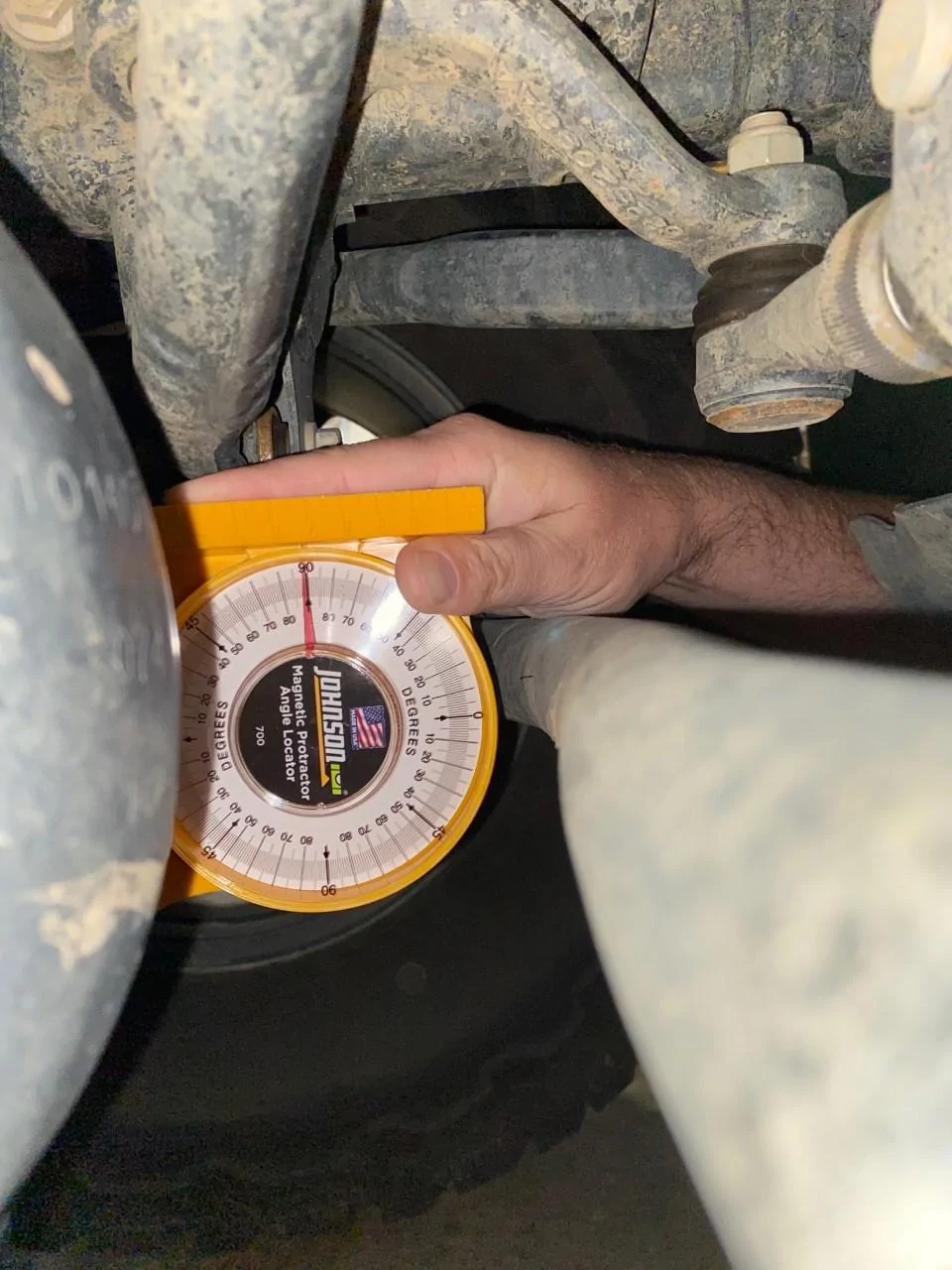

I just installed these, ordered from AllMoparParts, after adding a 2” spacer lift last week.
- It took about 1.5 hours
- I did it with my Jeep on the ground, no ramps
- No power tools, 1/2” ratchet and pipe for leverage
- 15mm, 21mm & 24mm tool were all that were needed
- 190 ft lb is tight, so very tight, to undo
- You need to undo the bolts, not the nuts, they grip (ask how I figured this out!)
- My torque wrench topped out at 150lbs., then I gave it a little bit more, about what I felt it took to undo
