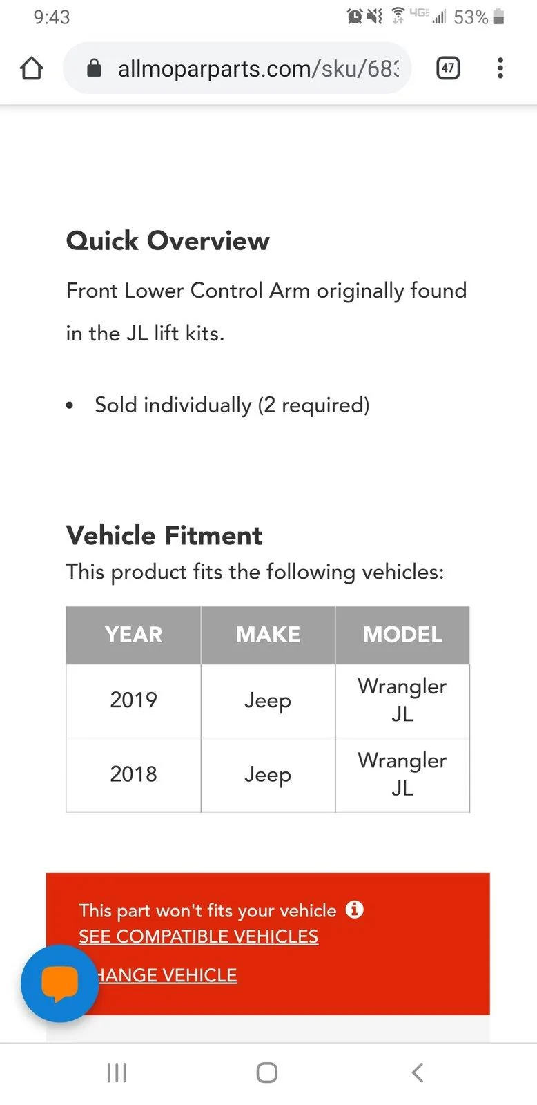

I might be crazy but the site says the longer arms won't fit my 2020 JL? Any idea why? Is it because it's designed for lift kits?
