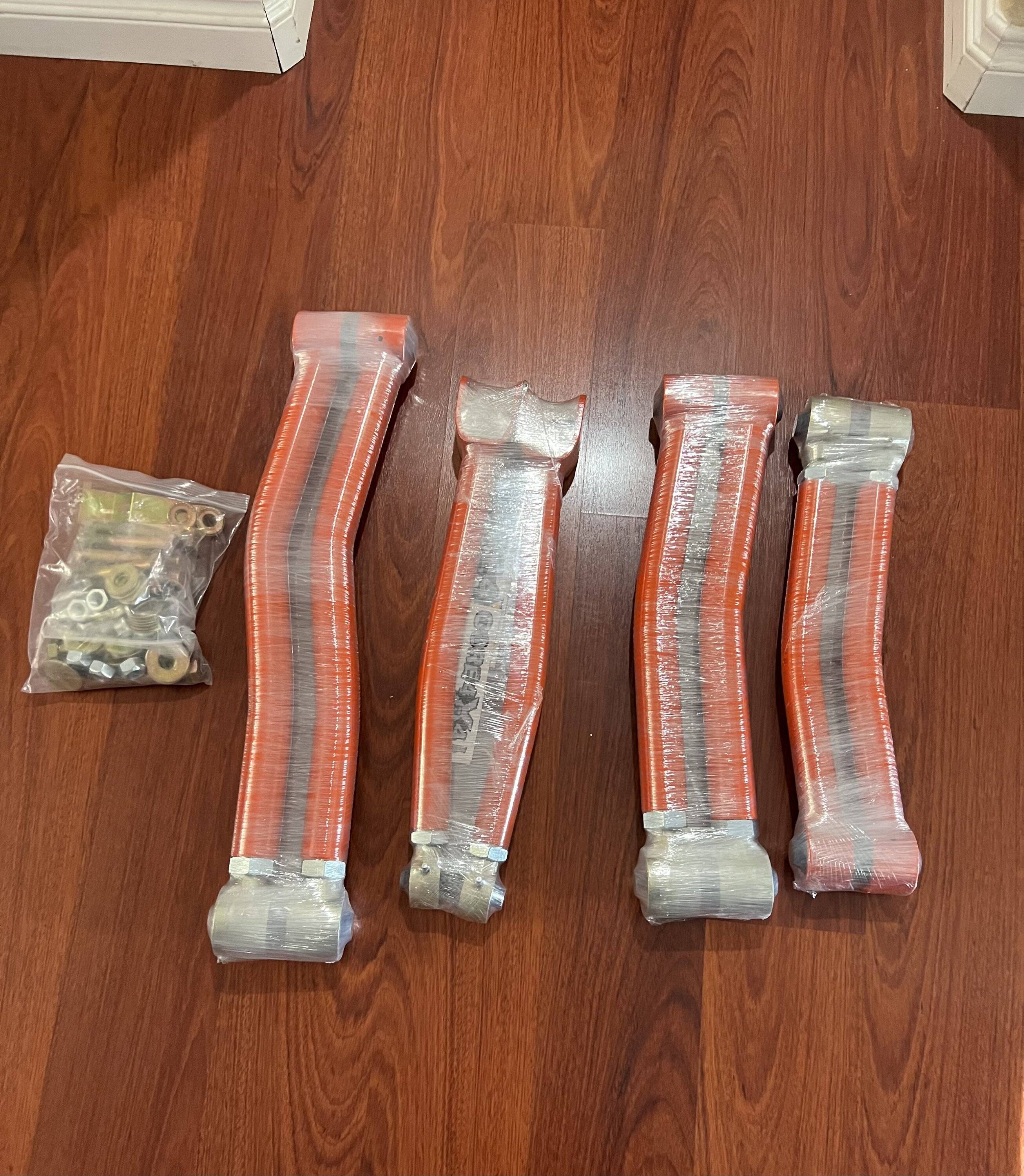

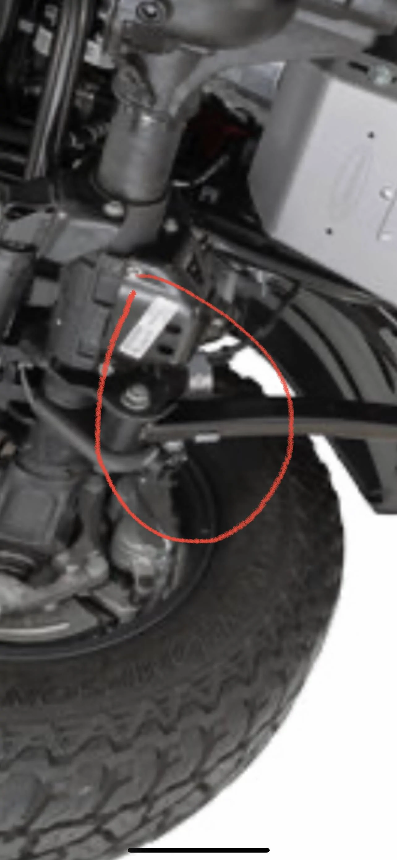

The mopar control arms have a hole to screw in the lines that dangle on them. The aftermarket Lca don’t have that hole to install ,so the wire need to be zip tied to something …. That only thing that bother me about the adjustable control arms vs the mopar ones.
i bought adjustable control arms in July .. there sitting on my living room floor, can’t to find time to install them.
Rubicon express lca's have a bracket welded on so that the stock brake line bolts up FYI. As to the OP's question, smoother suspension travel/articulation is another benefit of almost every aftermarket LCA. They all have some type of flex joint at one end if not both. Rubber bushings bind.

And last but not least, the primary reason I chose Rough County was because they have the notch to mount the bracket for the brake line. So they are 100% plug and play. Tightening the bolts to 190 ft/lbs is a bi*ch though!
