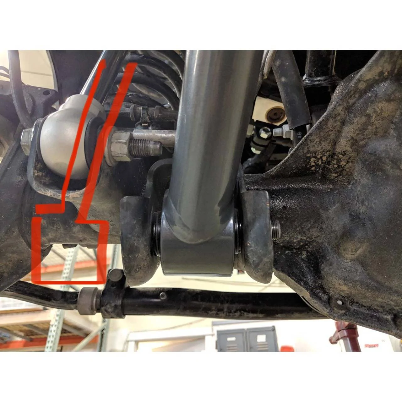

I purchased a set of Synergy adjustable front LCA to replace the factory ones, however they don’t just “fit”.
The instructions state to install the frame end first making sure the pinch bolts are facing up, then swing the axel side up into the bracket.
That’s easy to understand, but the axel side doesn’t swing up and in. It swings up next to the bracket. For it to go into the bracket I would need to force it over a good amount and then up into the bracket.
Anyone else have these or any advice on getting these installed correctly?
Edit: Added a photo of how it lines up with the front is lifted in place.

Try swapping sides…..

Lol no, it’s not that, I wish it were though.
I have made sure the flex joint at the frame end is angled correctly. And the arms have the bend inwards and up.

You can also try disconnecting the track bar if you have not done so. Im assuming the front end has the weight off it. If you are at ride height/ weight on tires, disregard.

Is axle centered.
