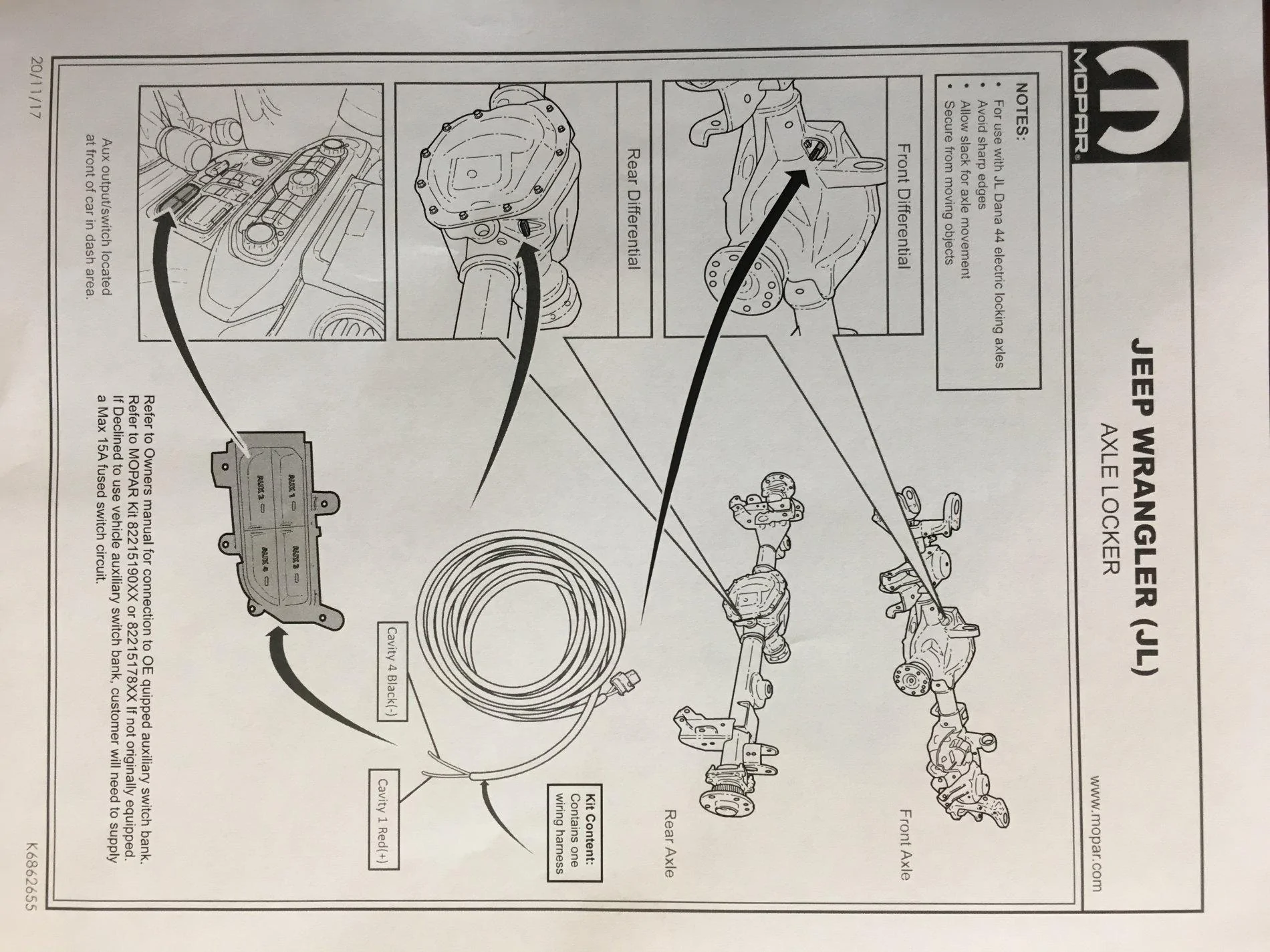

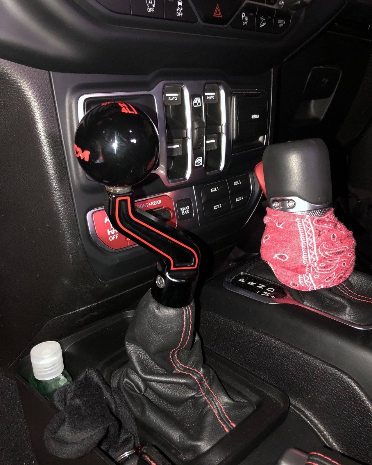

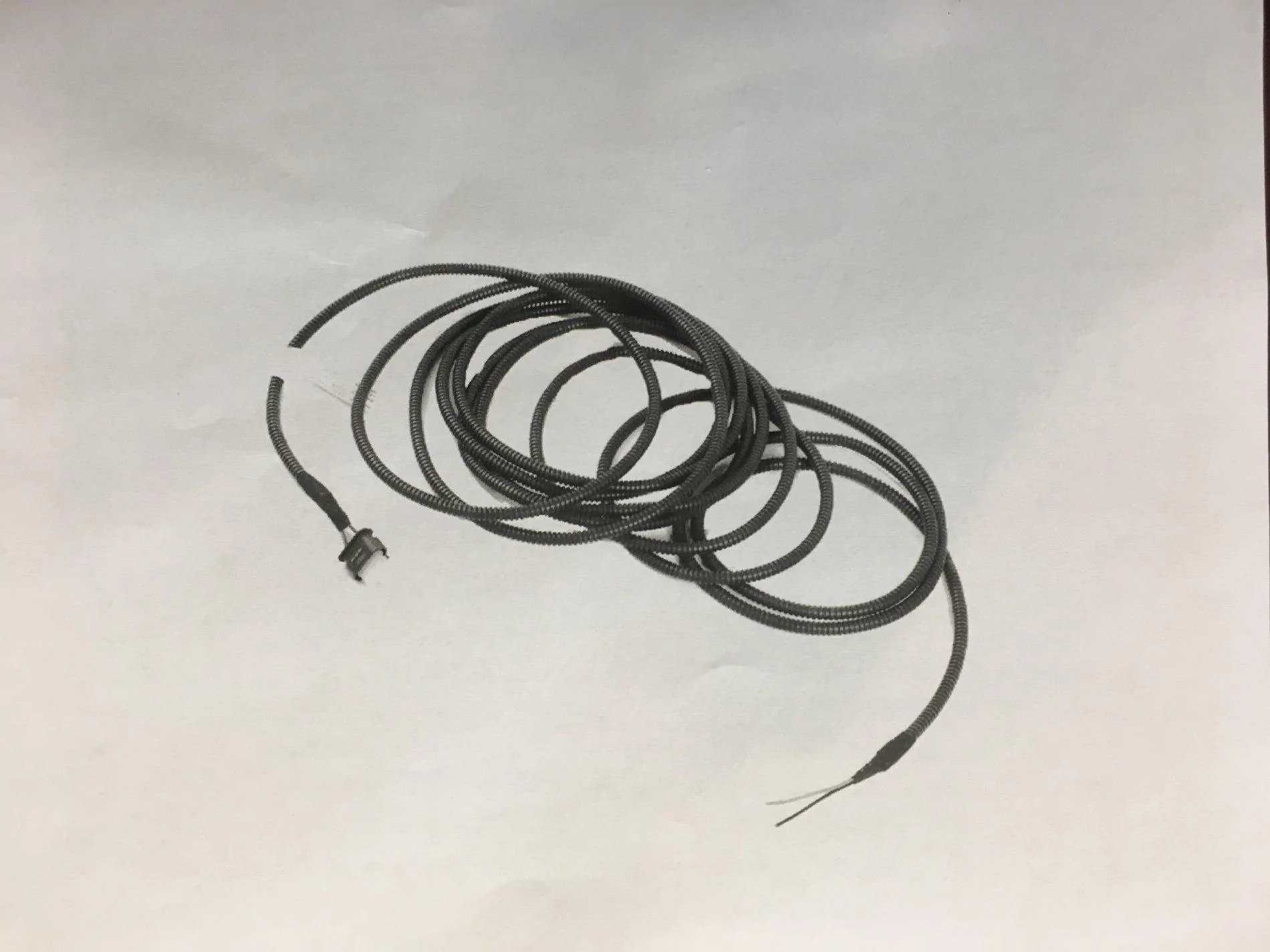

One of the first things I did was to hack the lockers. When running the sugar sand trails in 4H, I couldn’t stand the constant bogging down from the BLD trying to do its thing. So I got the Mopar wiring harnesses and I ran them to my aux switches 3 & 4.
Now I can engage rear lockers in 2wd , which that alone will get you through quite a few places, can engage front and rear in 4H , and also can engage front alone in 4H and 4L .
The tazer will let me do this as well, and I use it for most wheeling trips, but if we’re gonna be running trails at speed, I’ll plug in the aux switches, because it’s quicker to respond, as it doesn’t have to argue with the computer, lol.

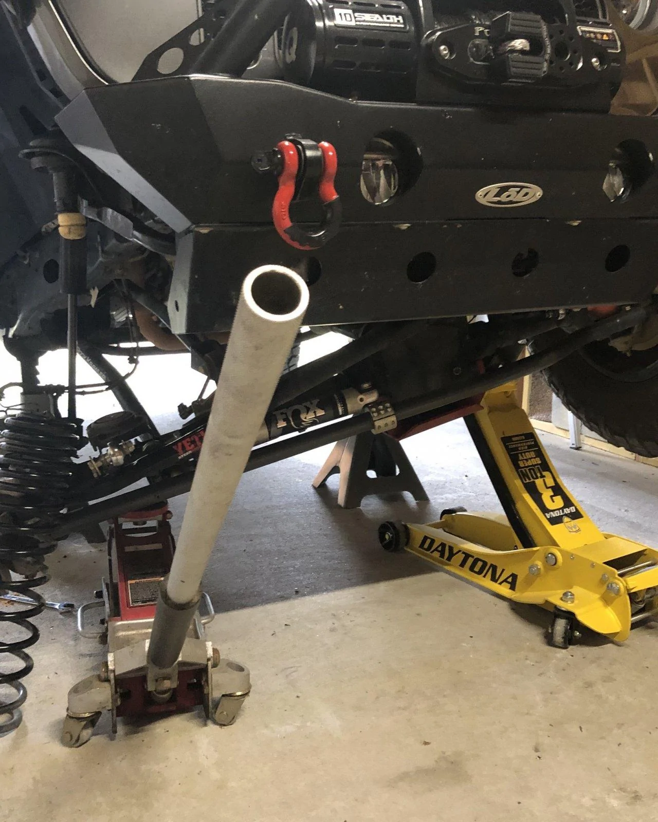

Very nice... would have a hard time not using for everything underneath :)
Roky
Roky
Roky
Oct 4, 2018
3,900
11,248
North Central Florida
  • Thread starter
  • Thread Starter
  • #7
Lol.. yeah I hear ya, I’m definitely gonna do the ball joints over there. In fact I’m gonna try and talk him into doing the other side at the same time . He likes his beer, so a case of Bud otta do it........:LOL:

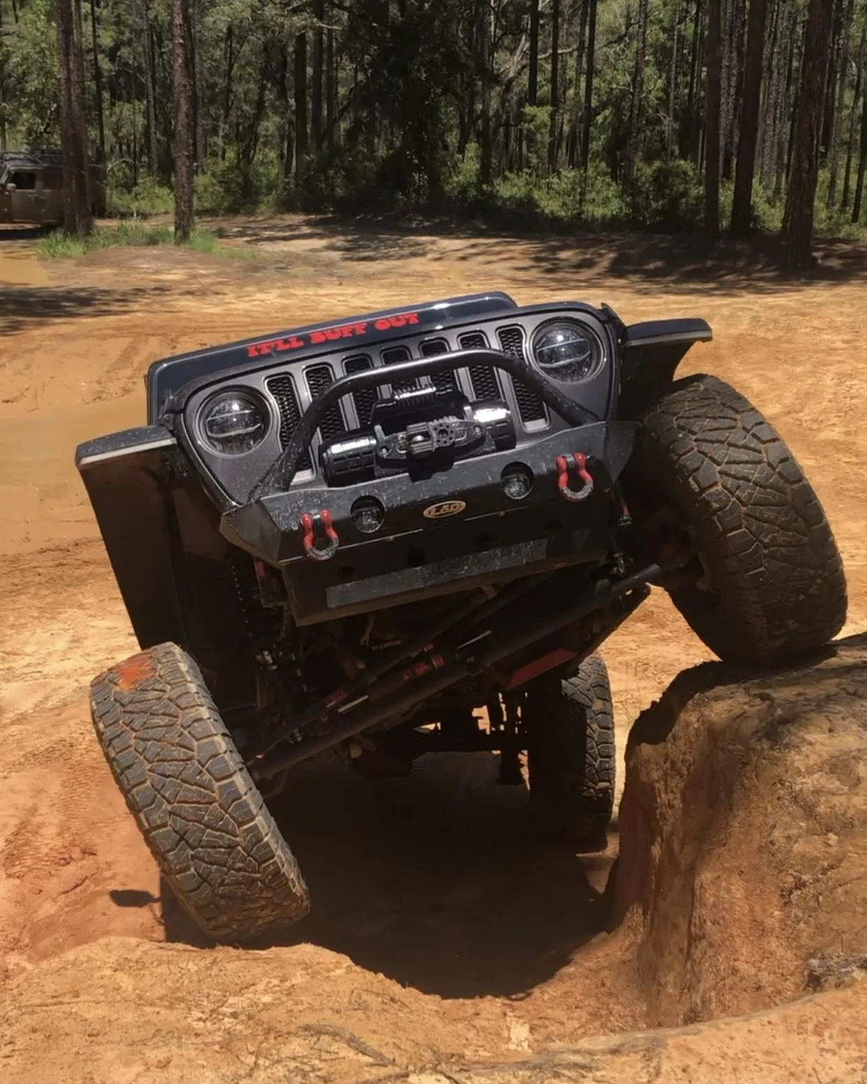

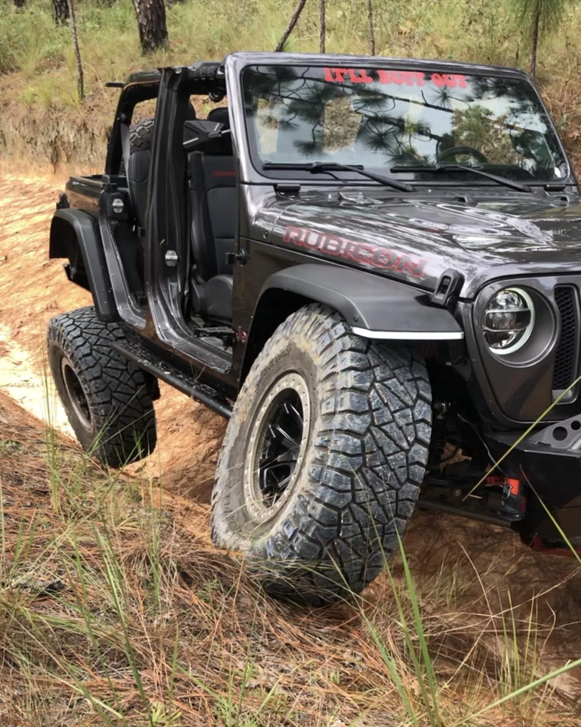

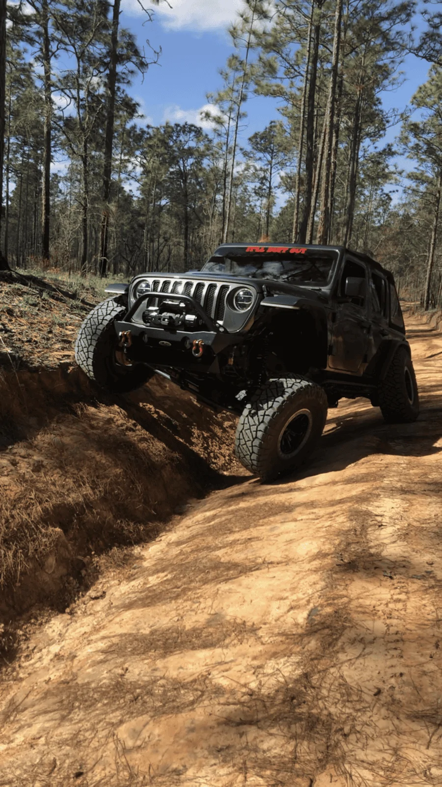

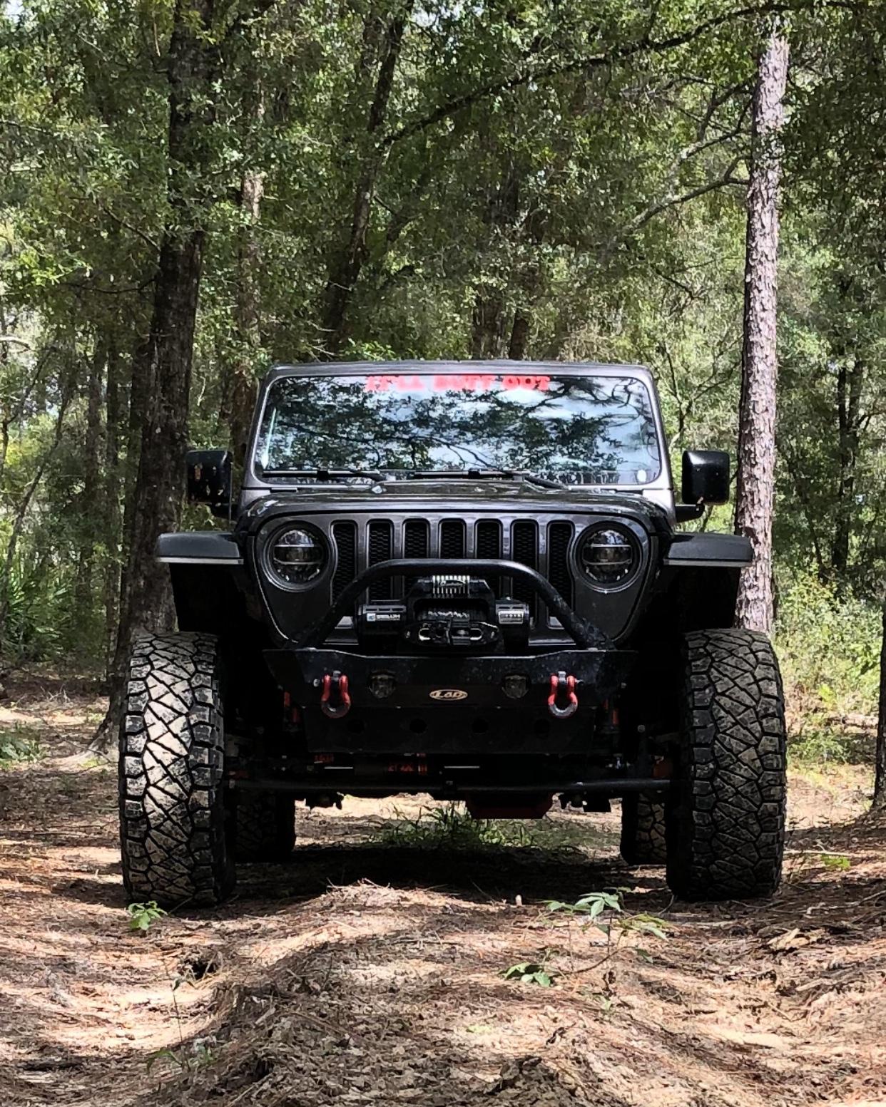

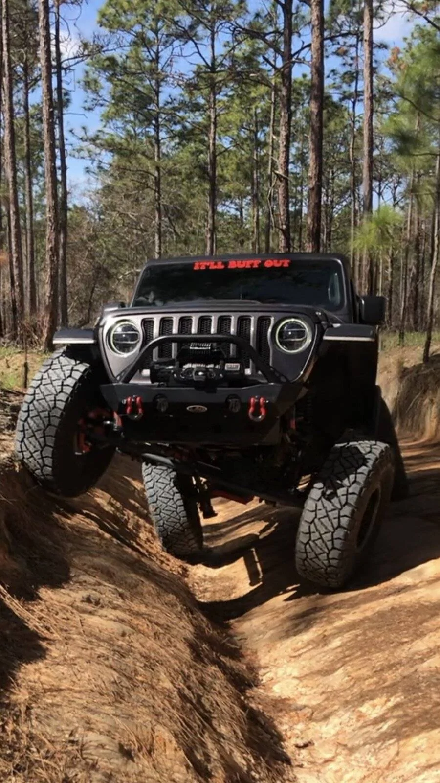

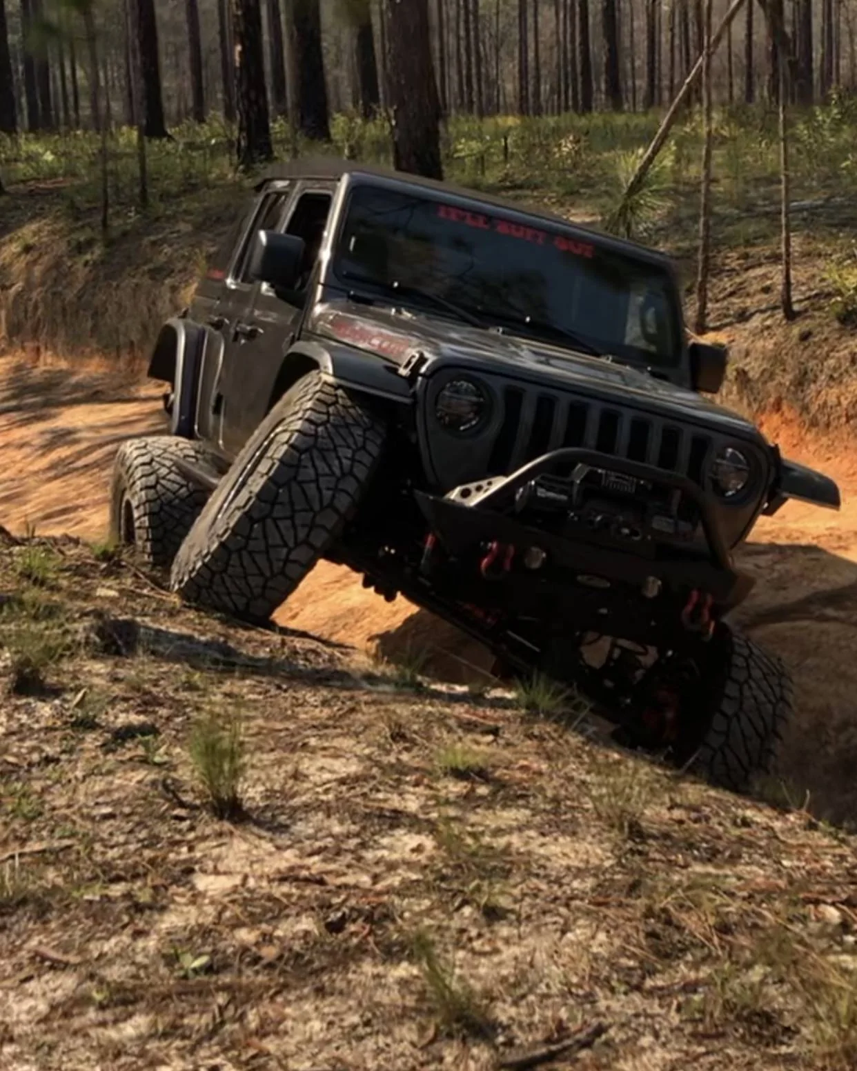

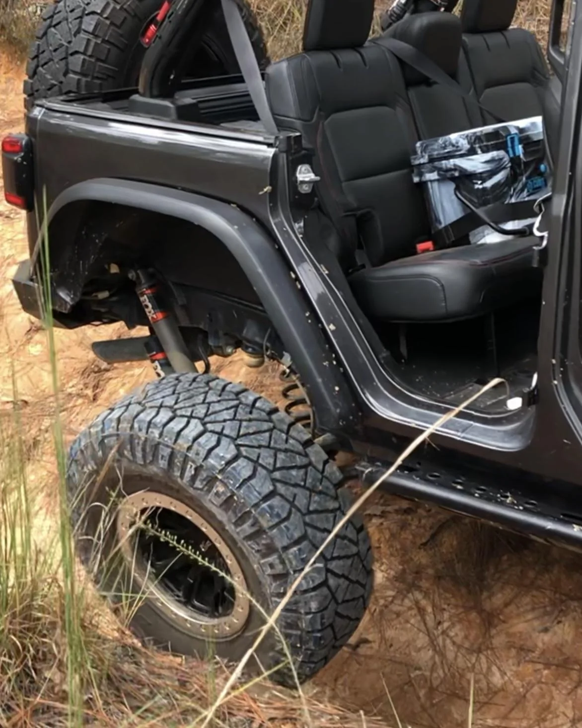

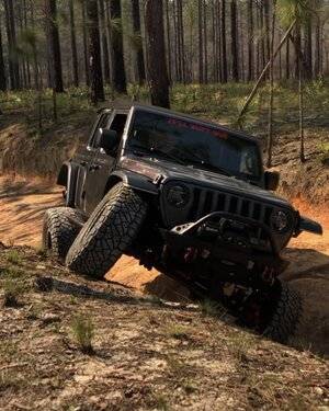

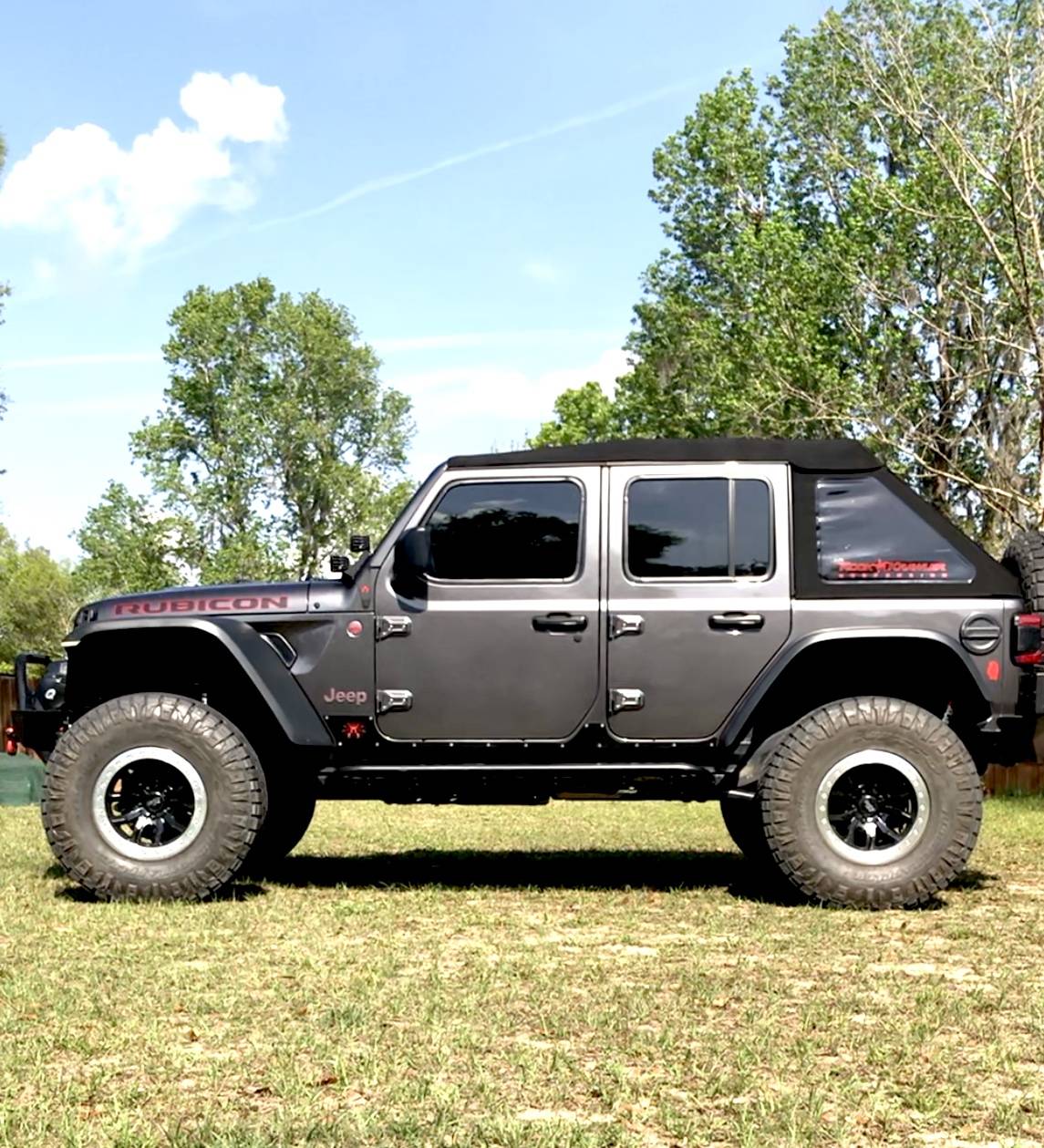

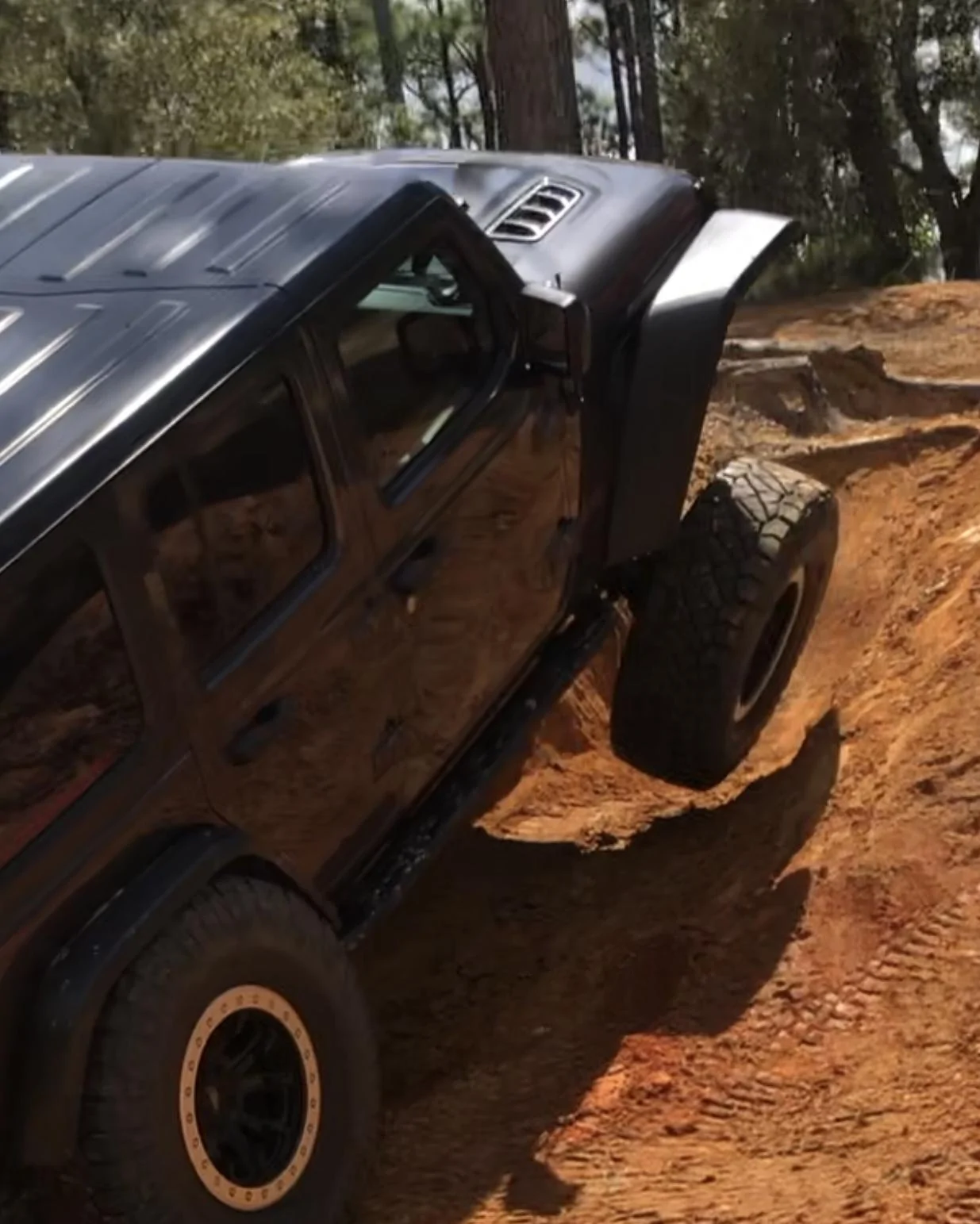

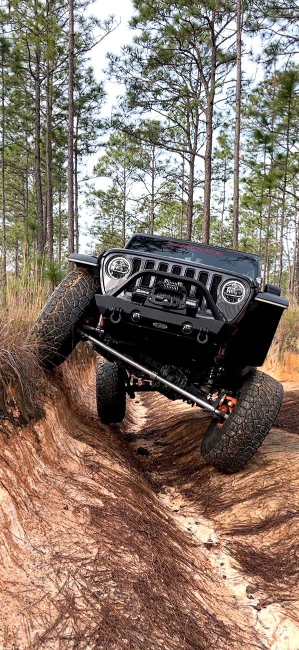

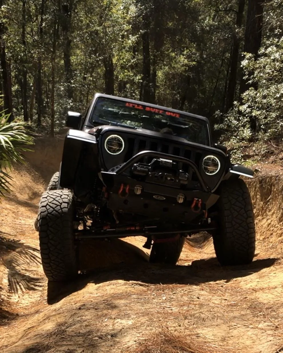

Some pics in the wild........:)...
Sorry, no exotic places, but the wife and I are still working and we own our own business without any employees so almost impossible to get away right now. Hopefully we can slow down soon......:whew:

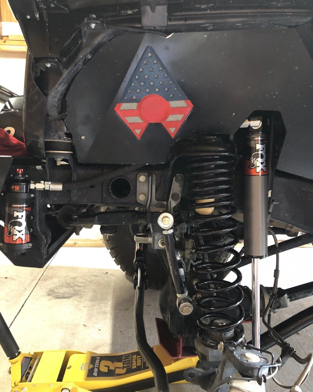

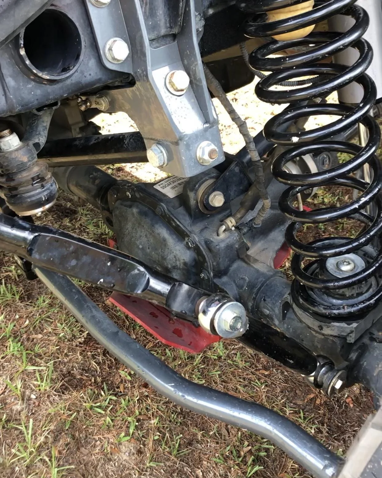

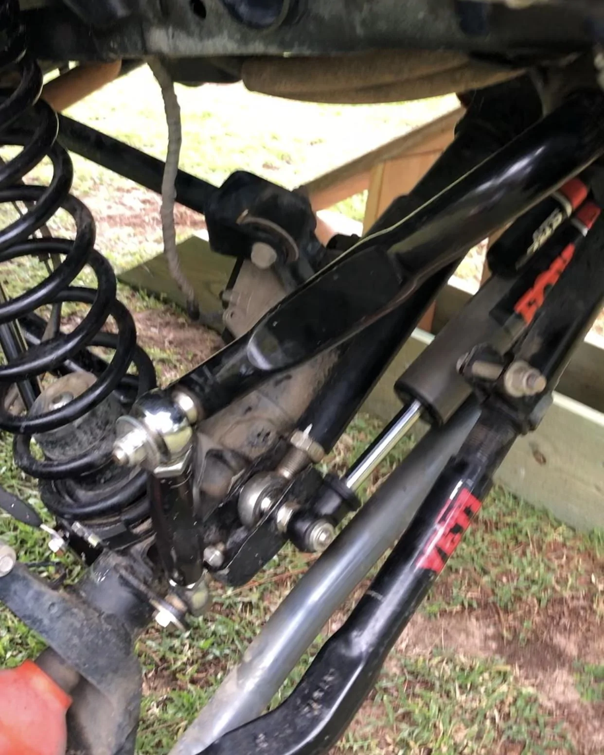

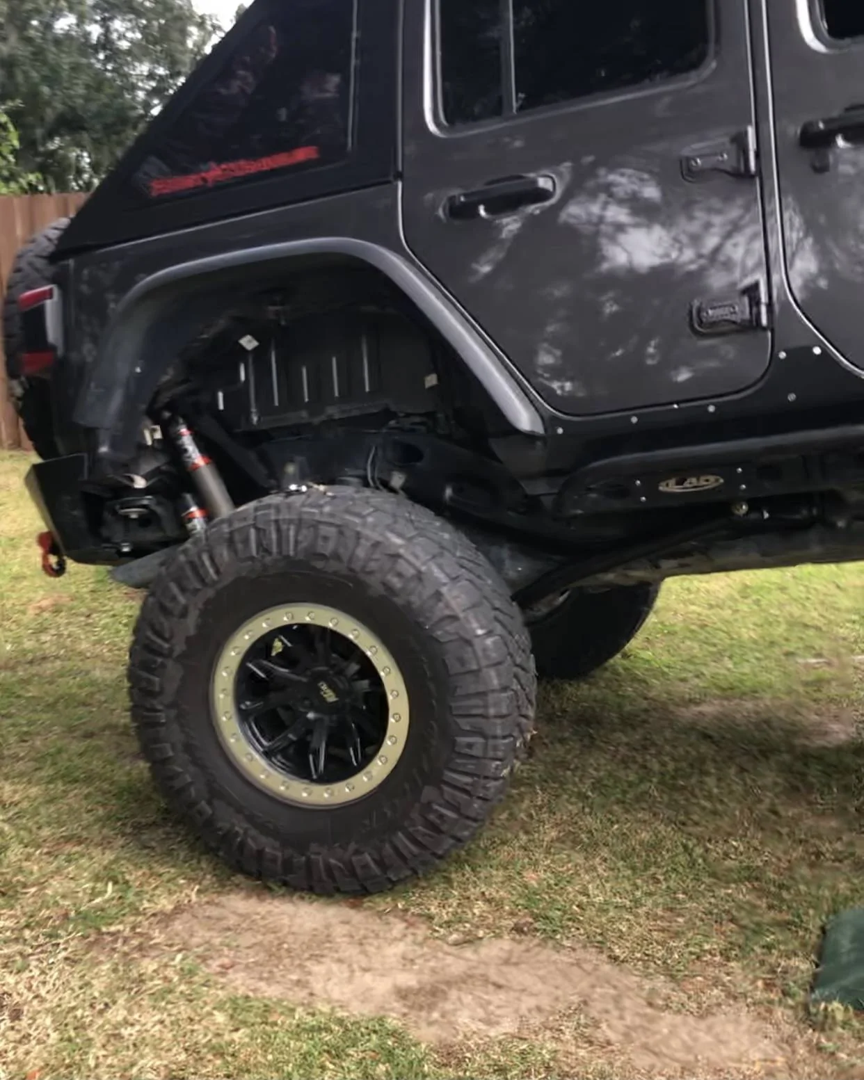

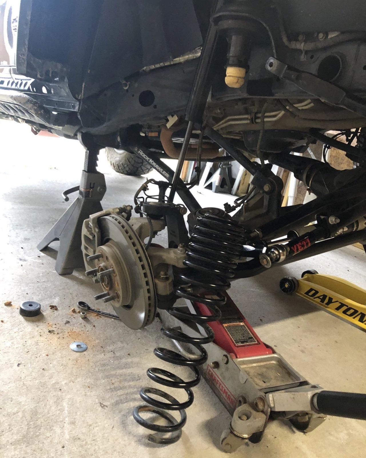

Here’s some suspension shots:
Here’s the lcas , you can see how well the krawler joint works, the control arm doesn’t move, twist or bind.

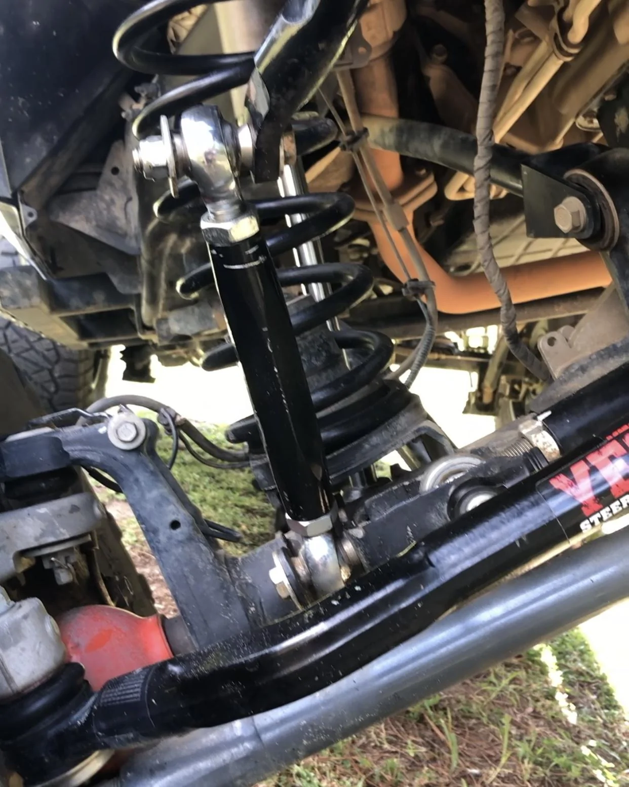

Here’s the no limits sway bar links. You can see how much they misalign.
I had to lengthen them a half inch because they were getting to straightened out at full droop.
After I lengthened them...
I wondered how good the elect sway disco worked compared to unhooking them. I don’t know what I expected but I was surprised there’s only maybe a quarter inch difference:
unhooked
hooked

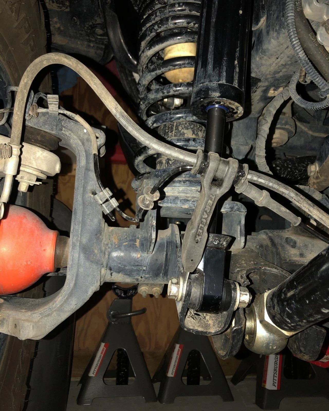

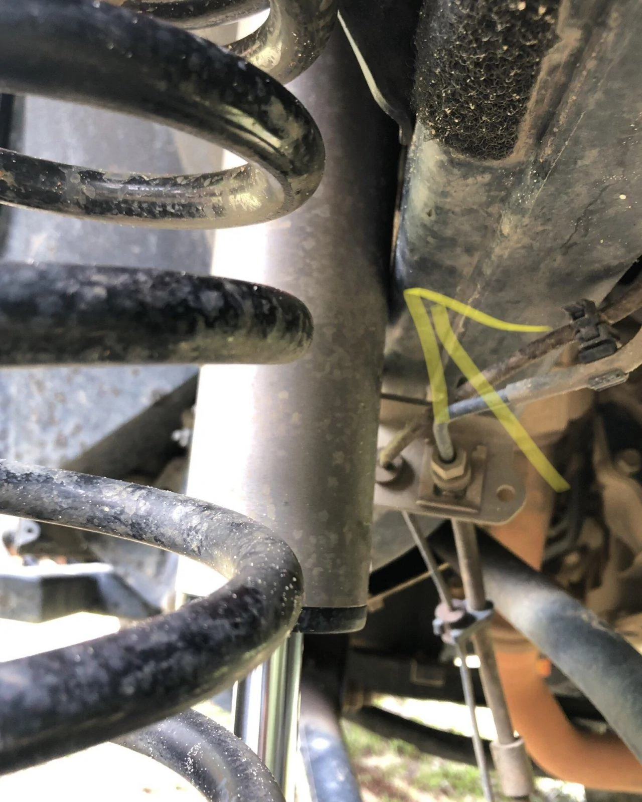

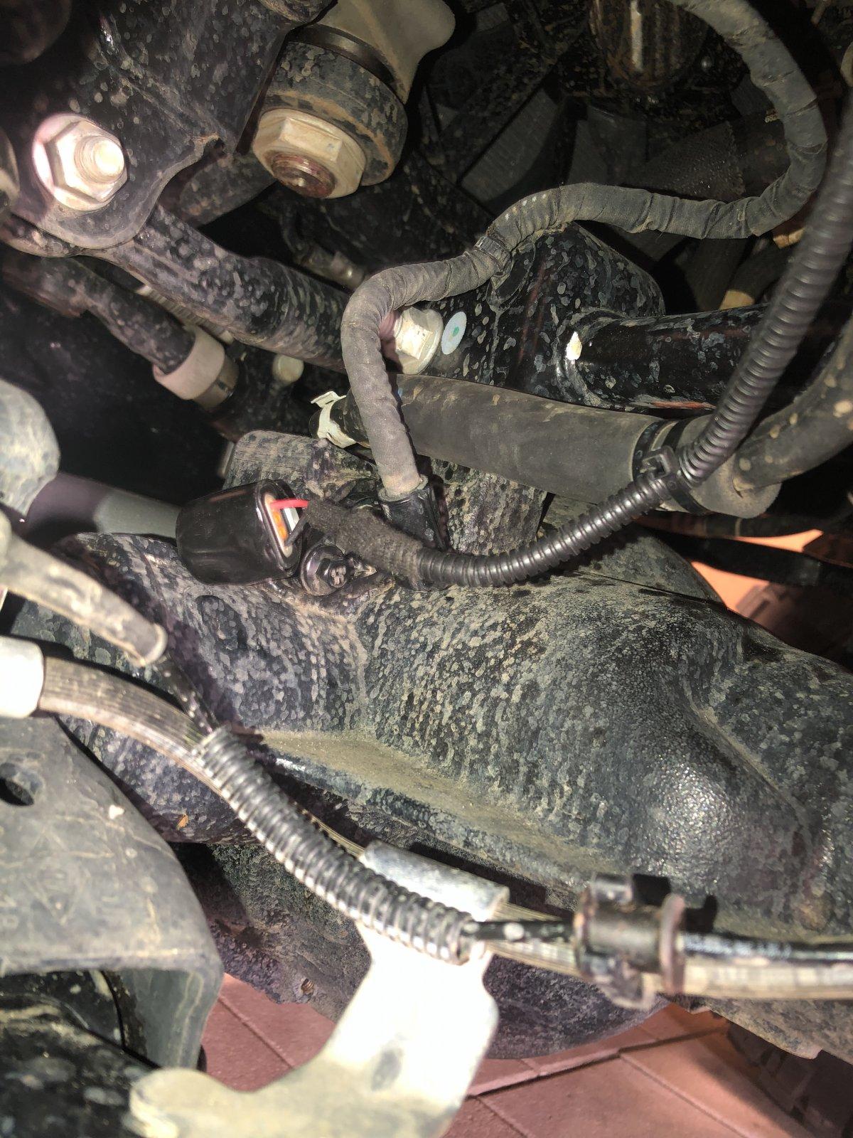

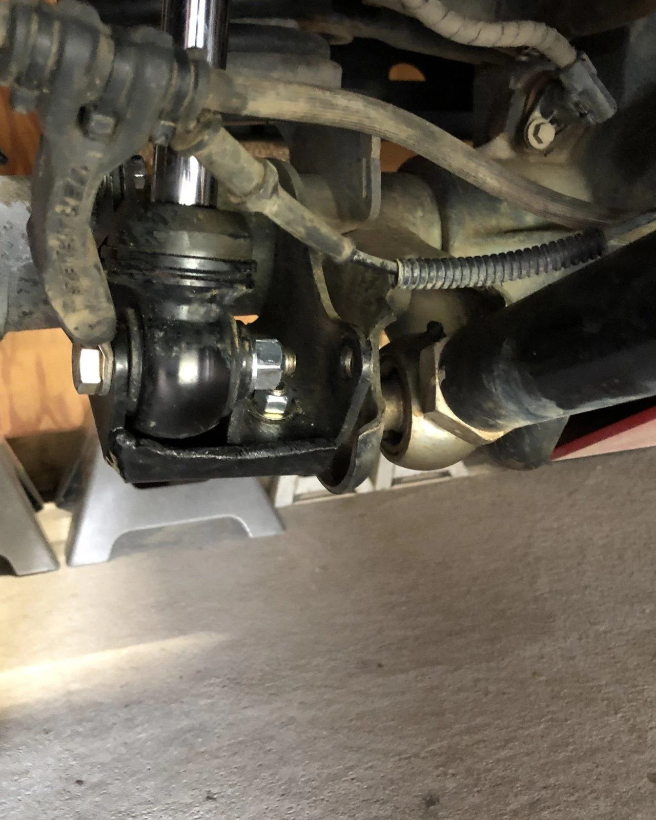

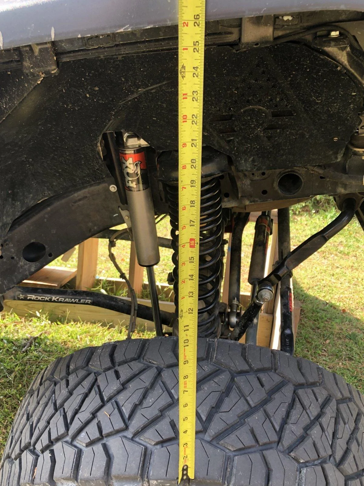

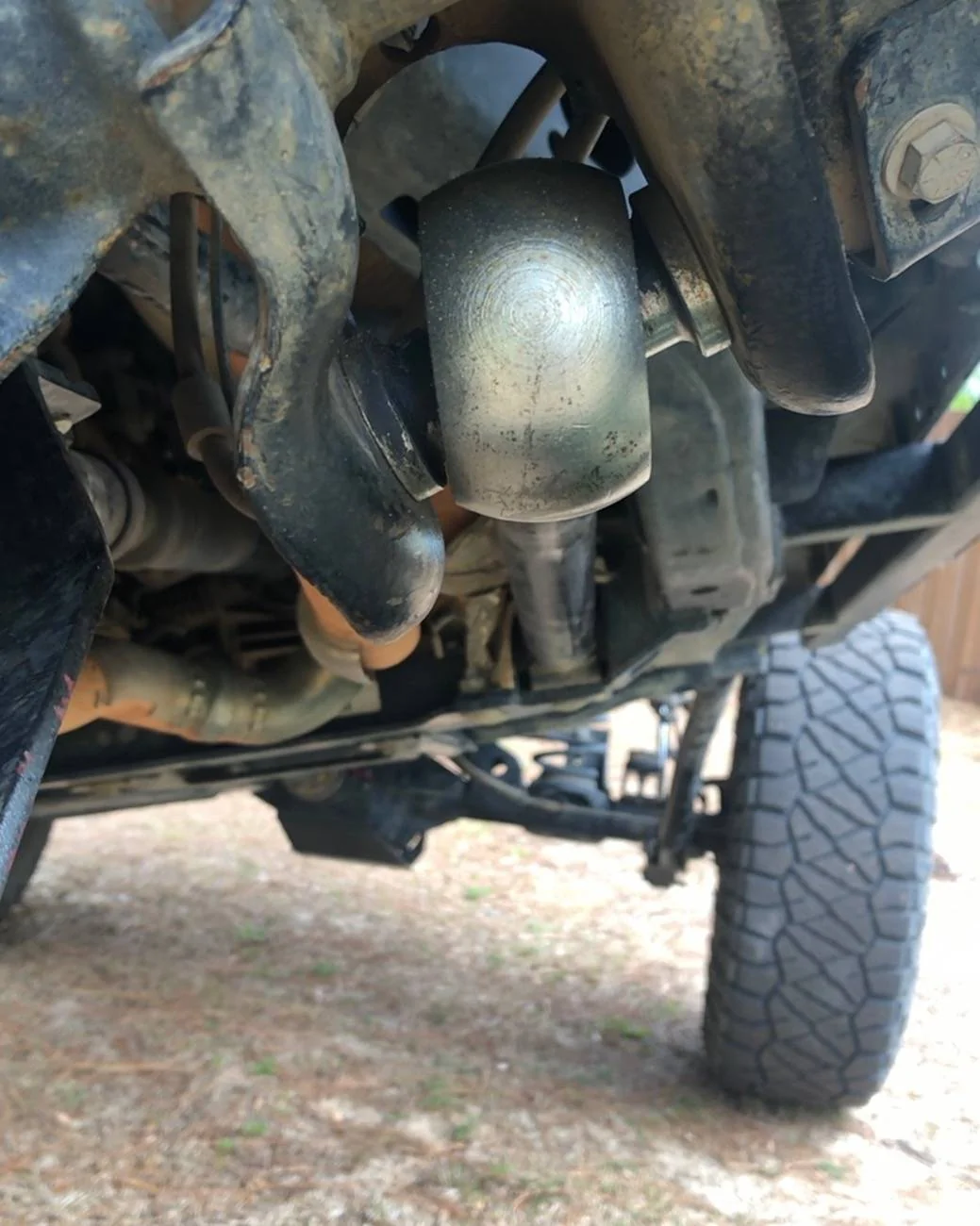

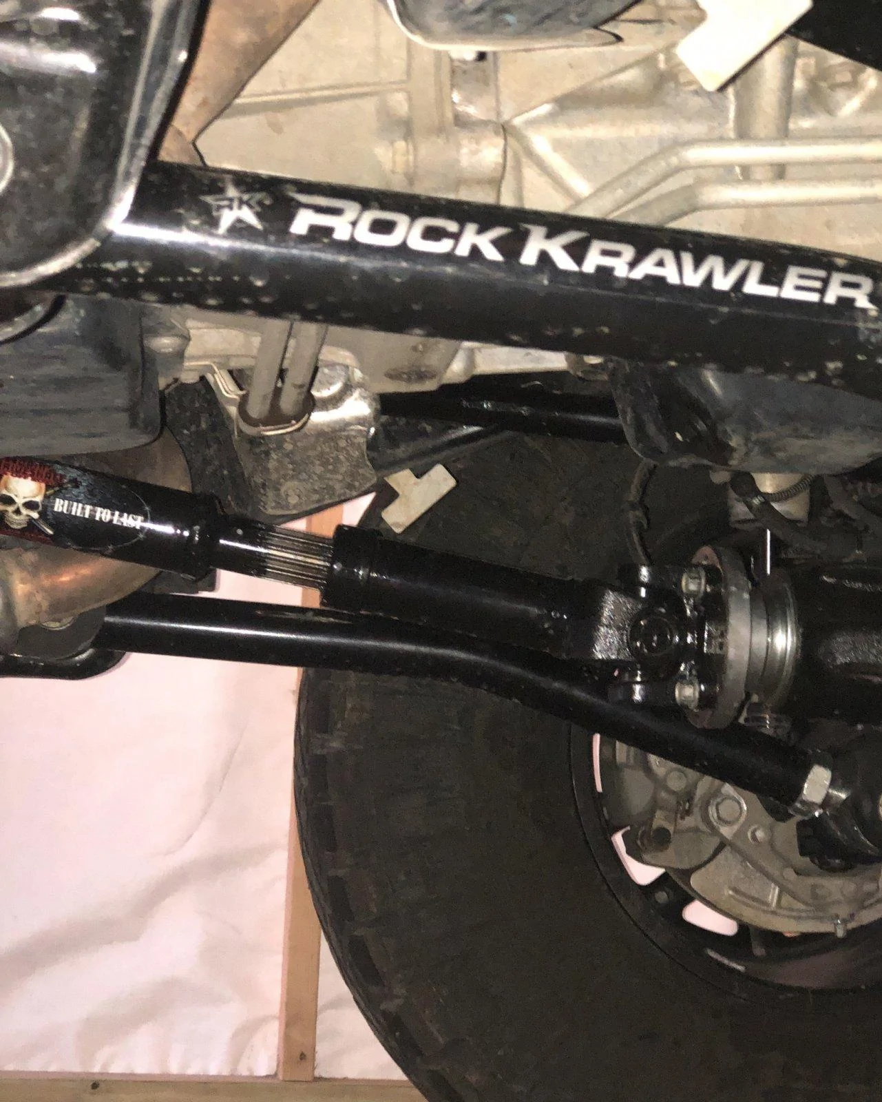

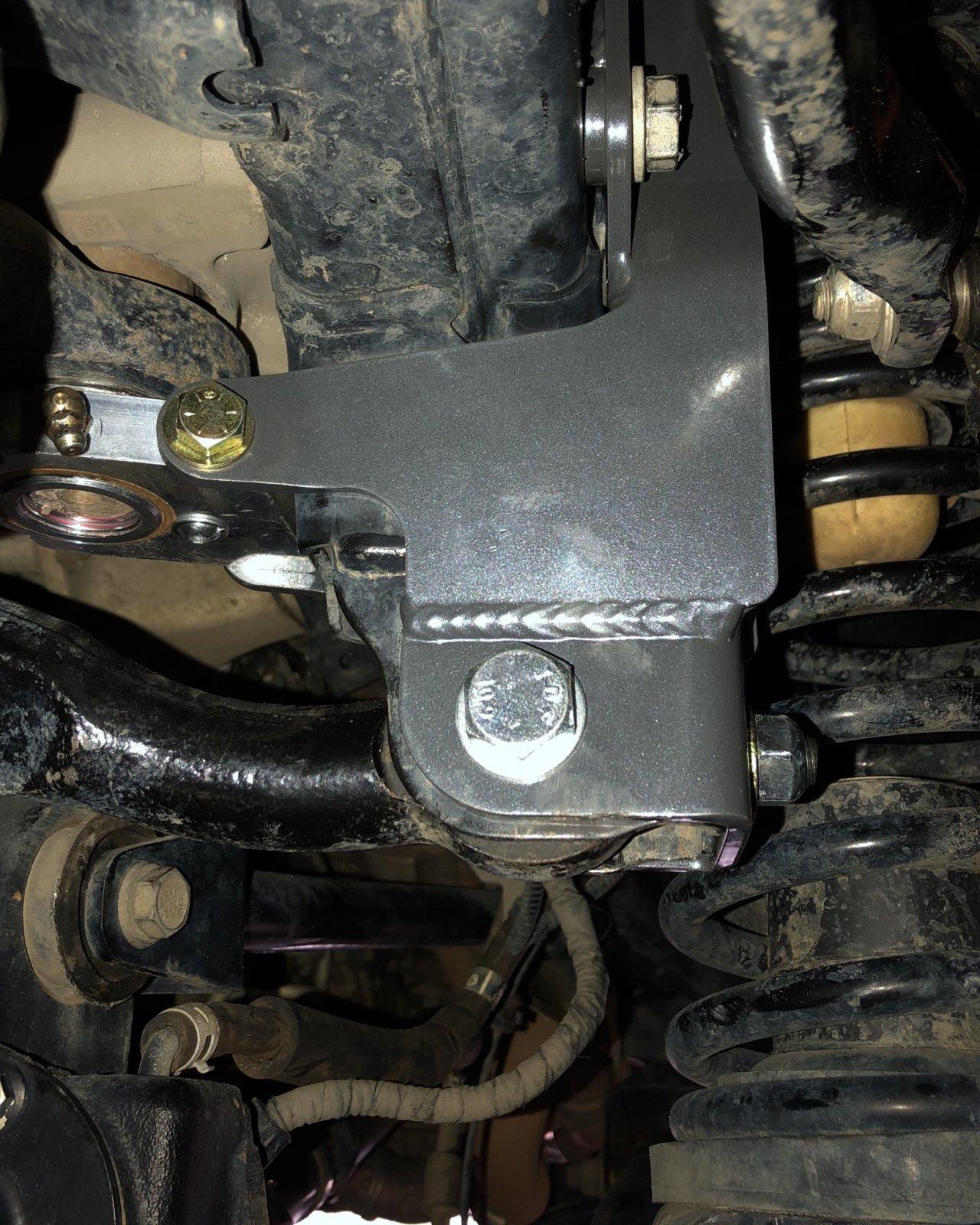

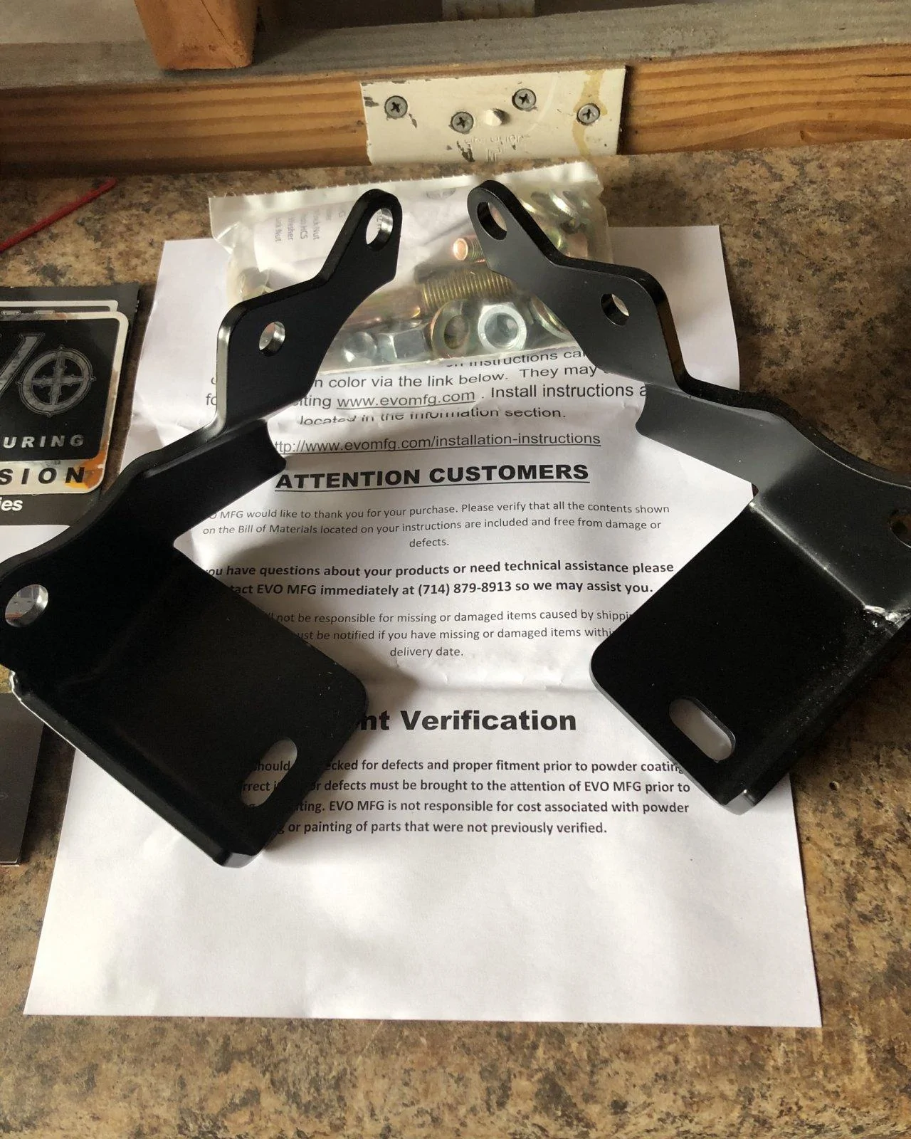

These are a few things I had to address running long travel shocks:
At full extension the shock was hitting the frame.
For this I got some evo shock outboard relo brackets.
they also double as a skid.
Had to relocate brake line, but I didn’t have to lengthen them. For this I got the Teraflex brake line relocation bracket.

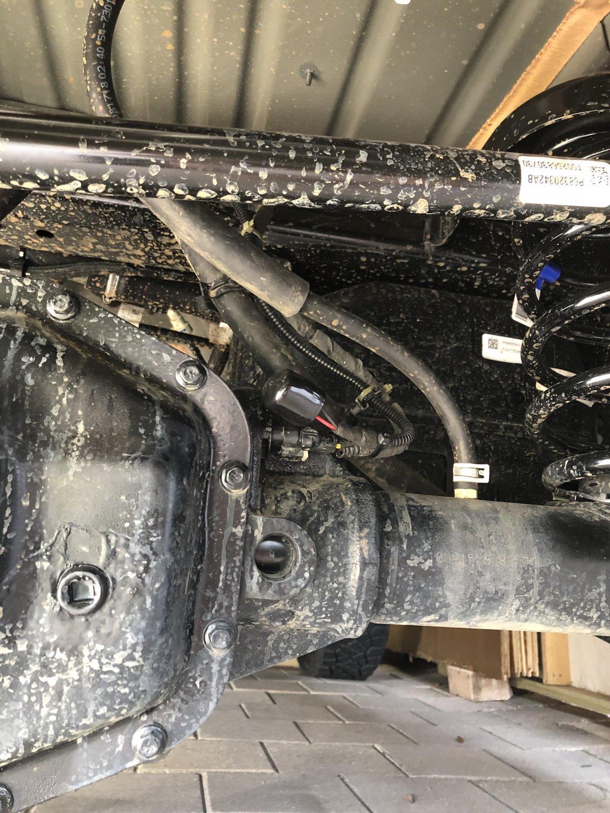

Also had to free up locker harness, and FAD wiring harness. Just unhooked them from a couple zip ties holding them to the frame.

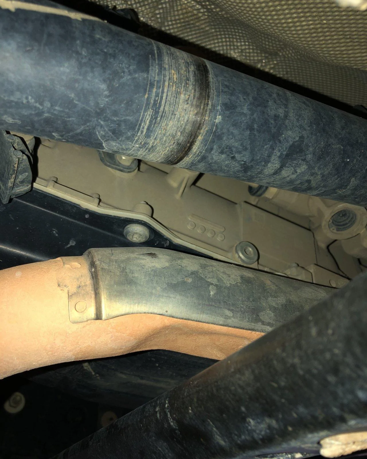

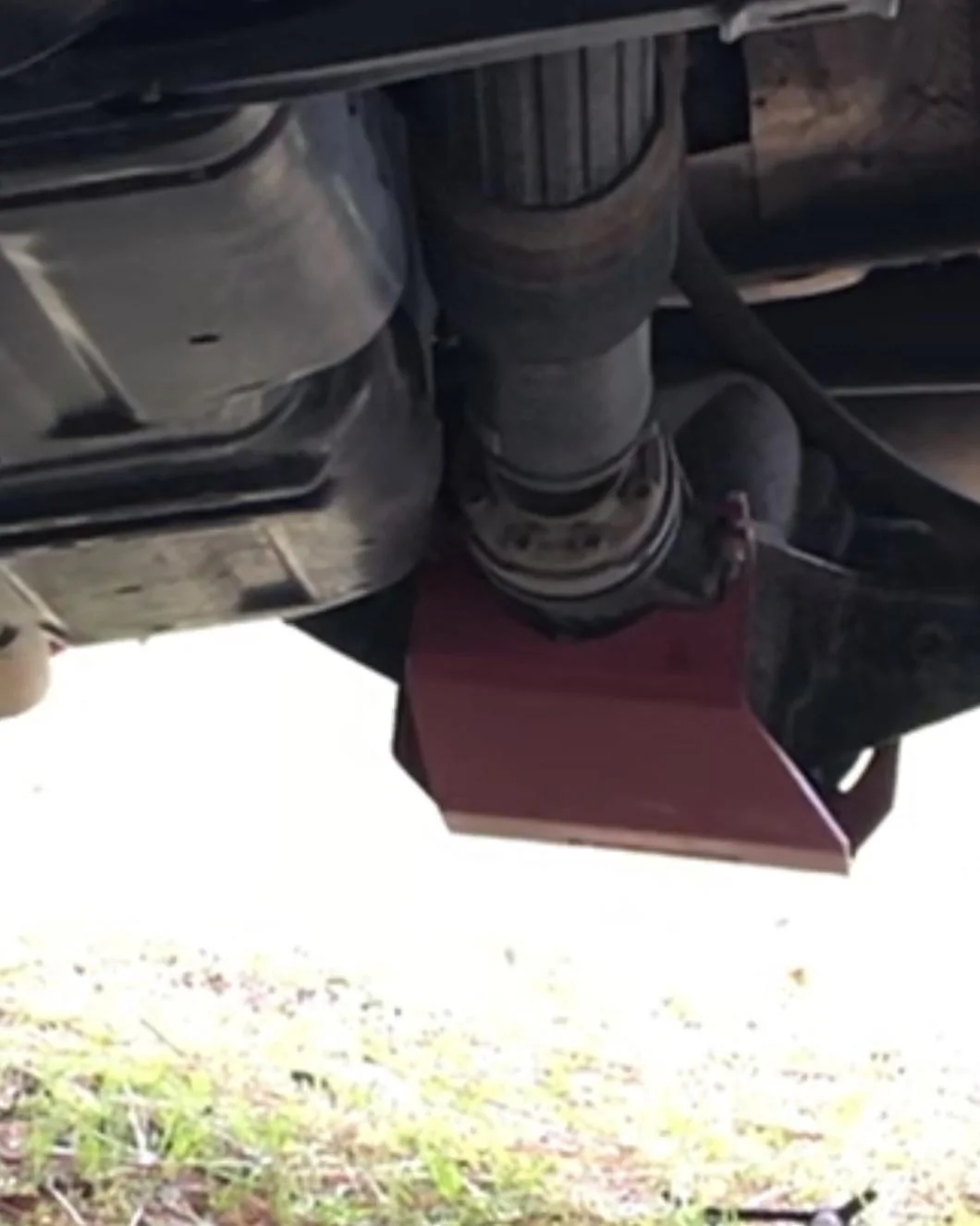

The driveshafts were another place of interest... the rear driveshaft gets real close but doesn’t hit the gas tank, but the front driveshaft does contact the exhaust, however it’s not that bad, and isn’t hurting anything, but I’ll keep an eye on it.
