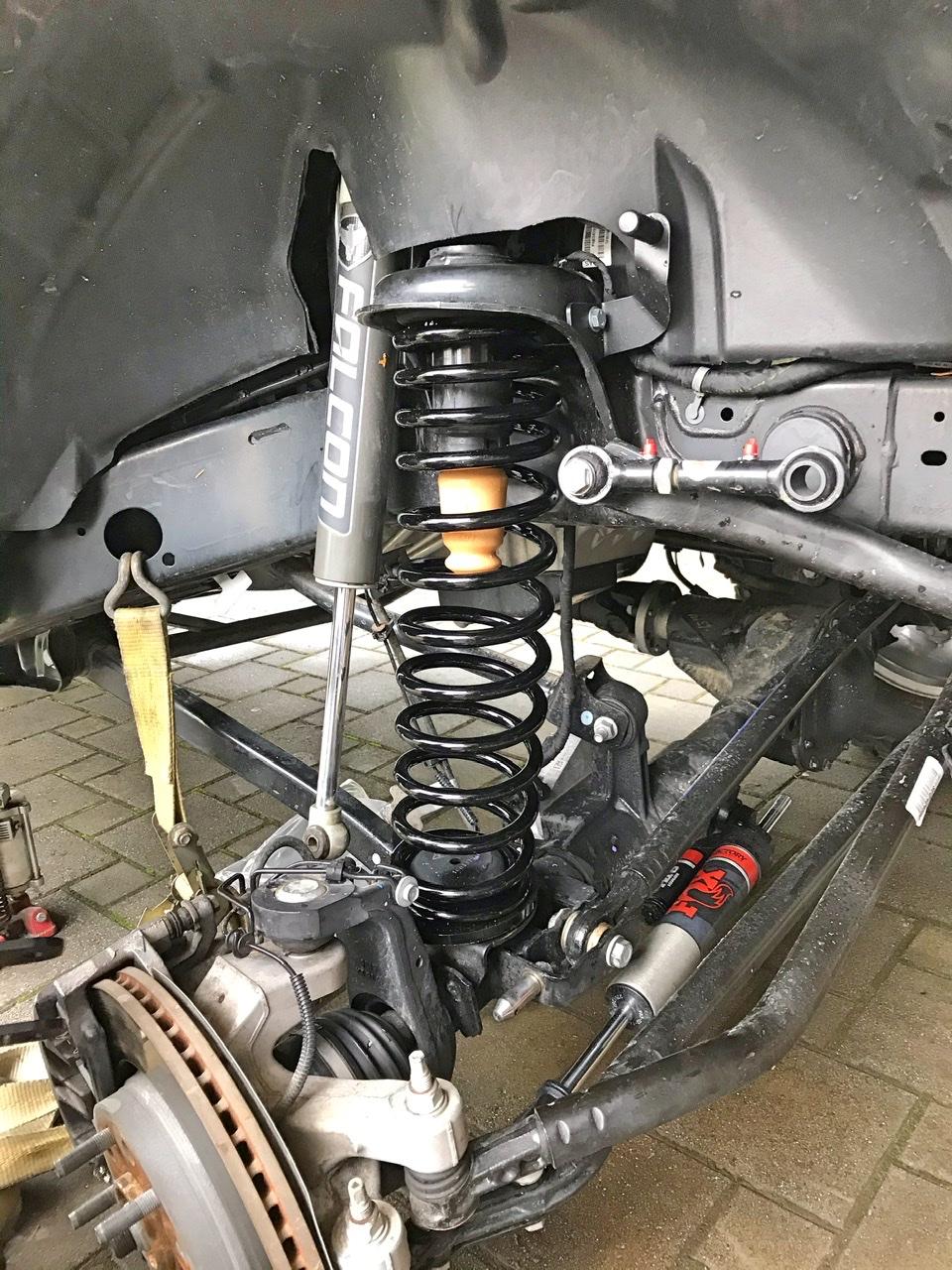

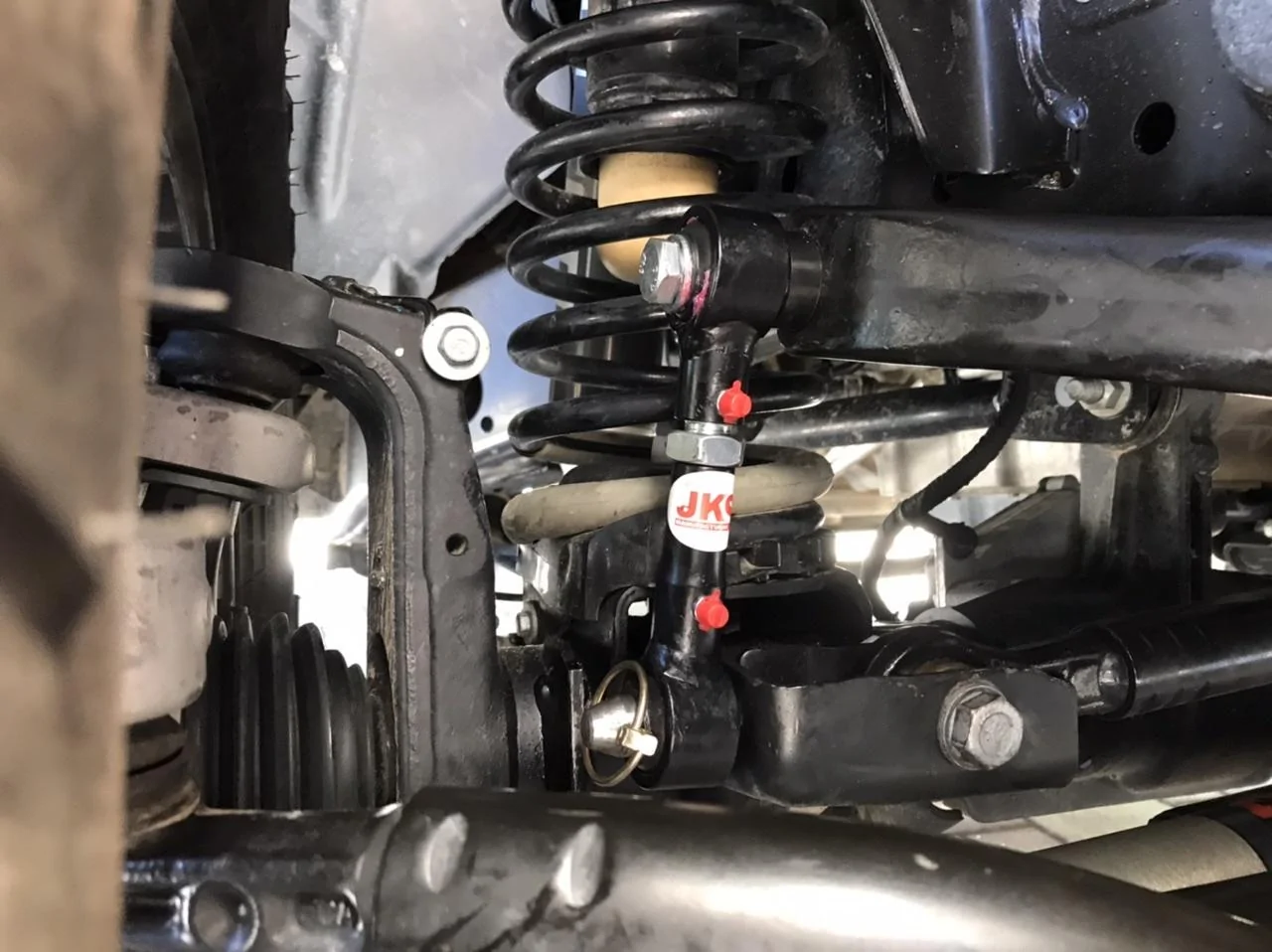

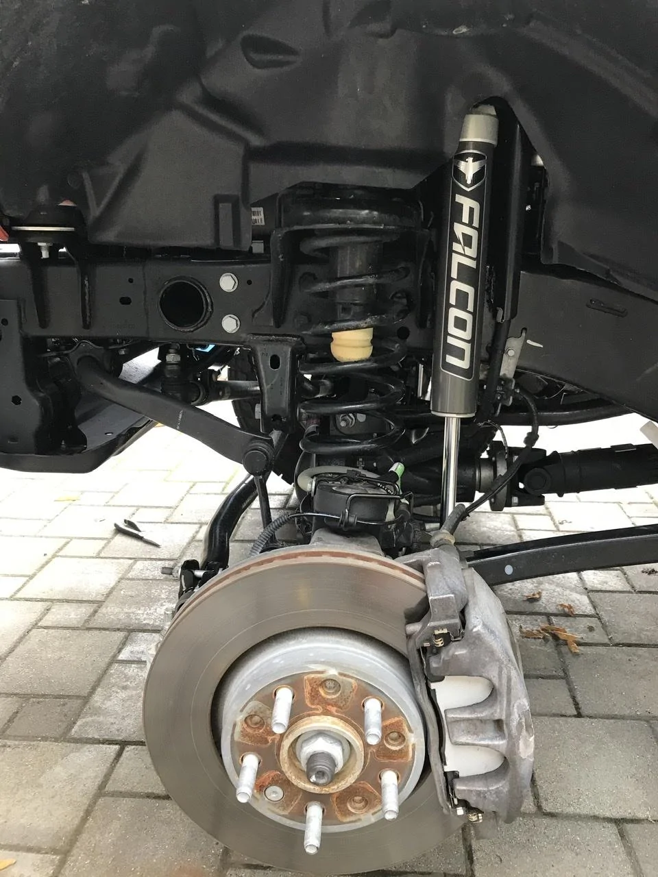

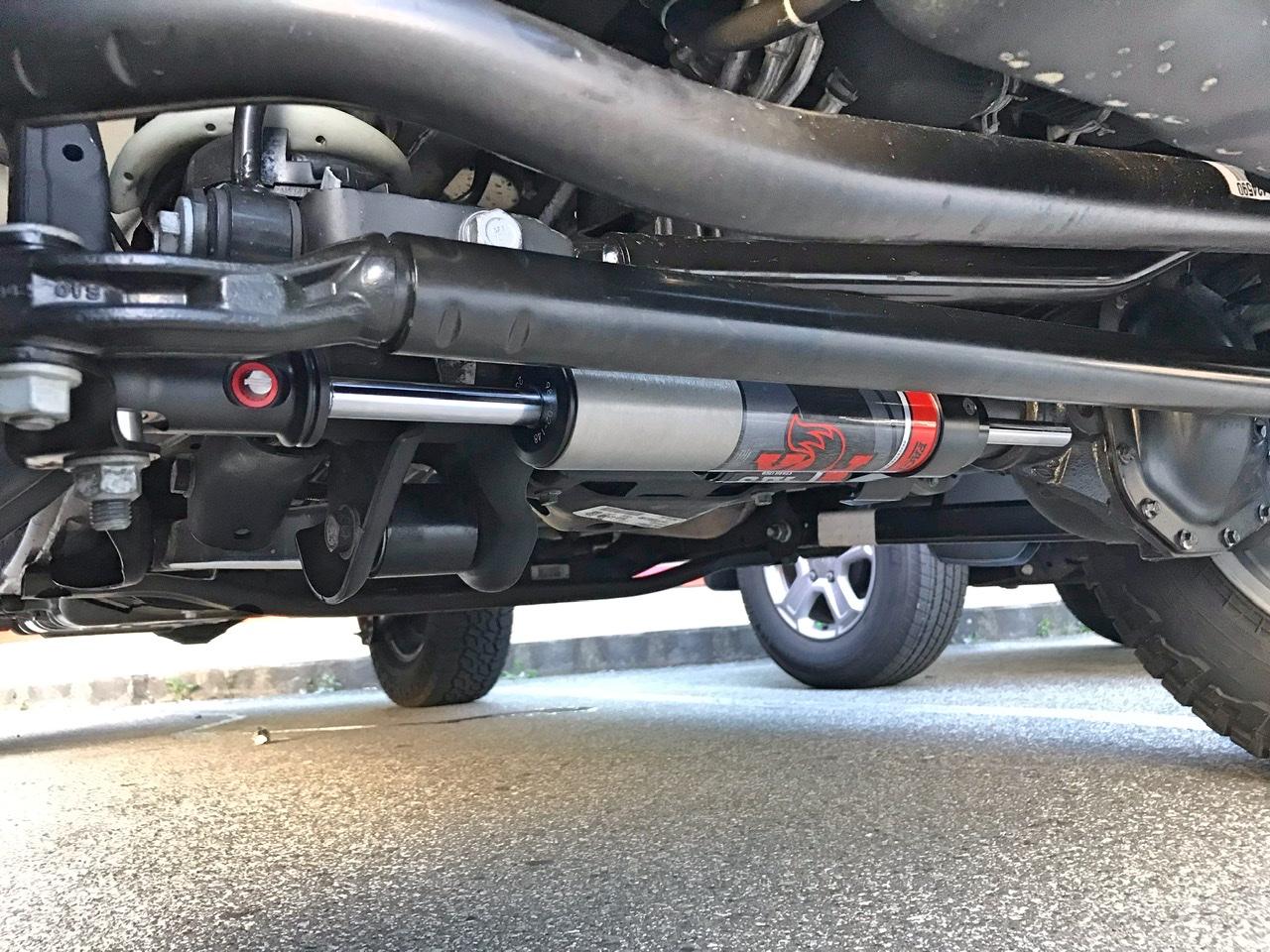

Lol I used to be in the exact same situation, but slowly I started to replace the steering components bit by bit and I can confidently say that at this point, my JL drives like a dream.
Things I’ve replaced in chronological order:
-Longer Mopar LCA (With Rubicon suspension swap)
-Fox factory ATS steering stabilizer
-JKS quicker sway bar disconnect
-Teraflex Falcon 2.1 shocks
-2” Synergy Coils
-Teraflex front adjustable track bar
-Metalcloak front LCA
-Metalcloak rear adjustable track bar
