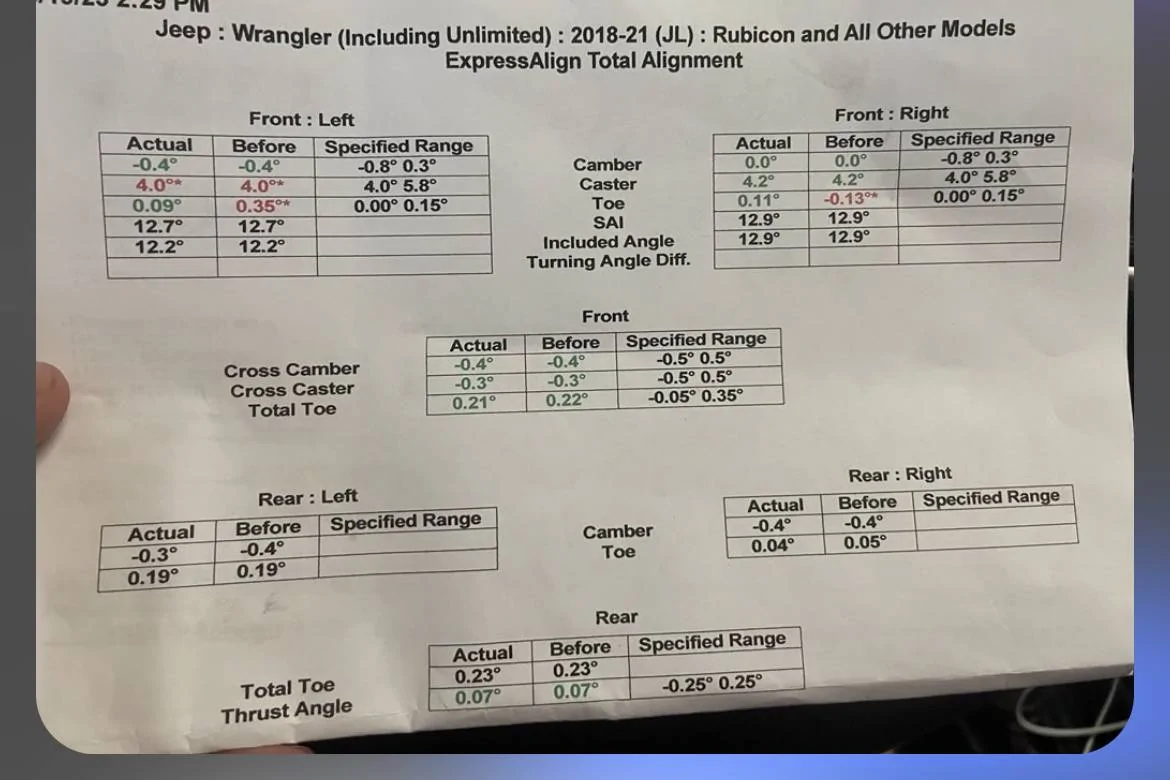

Has anyone actually measured the caster on an XR? There's a possibility that the mounts are in a different location.
Jeep Wrangler JL Mopar LCA swap 54869B50-B317-4EA9-890F-98FC30FFD442
2022 XR alignment after some hard wheeling. Only mod at the time was full undercloak system. Hard top, tow package, plastic bumpers- which according to your spreadsheet (my p/n matched what you have recorded) received the same springs as the steel ones in 22. I have the mopar LCAs coming in and will try to get a reading at some point after. Caster barely in spec in stock form and unfortunately drives like it.

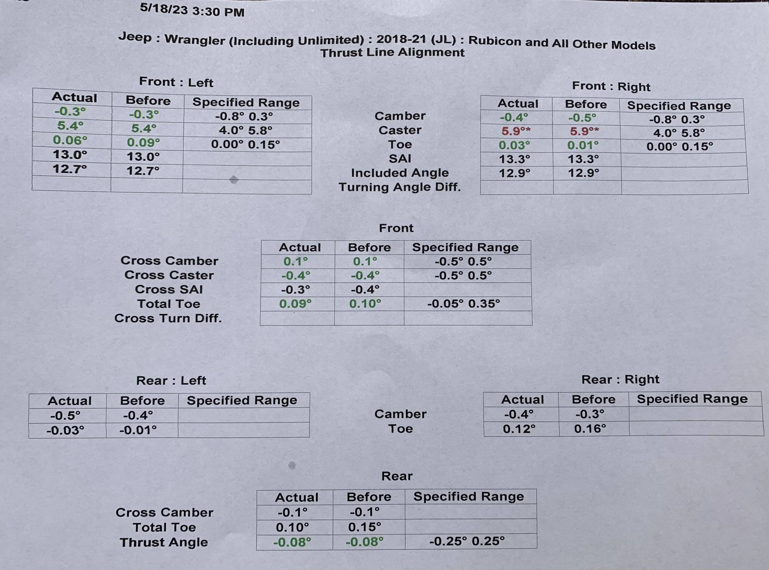

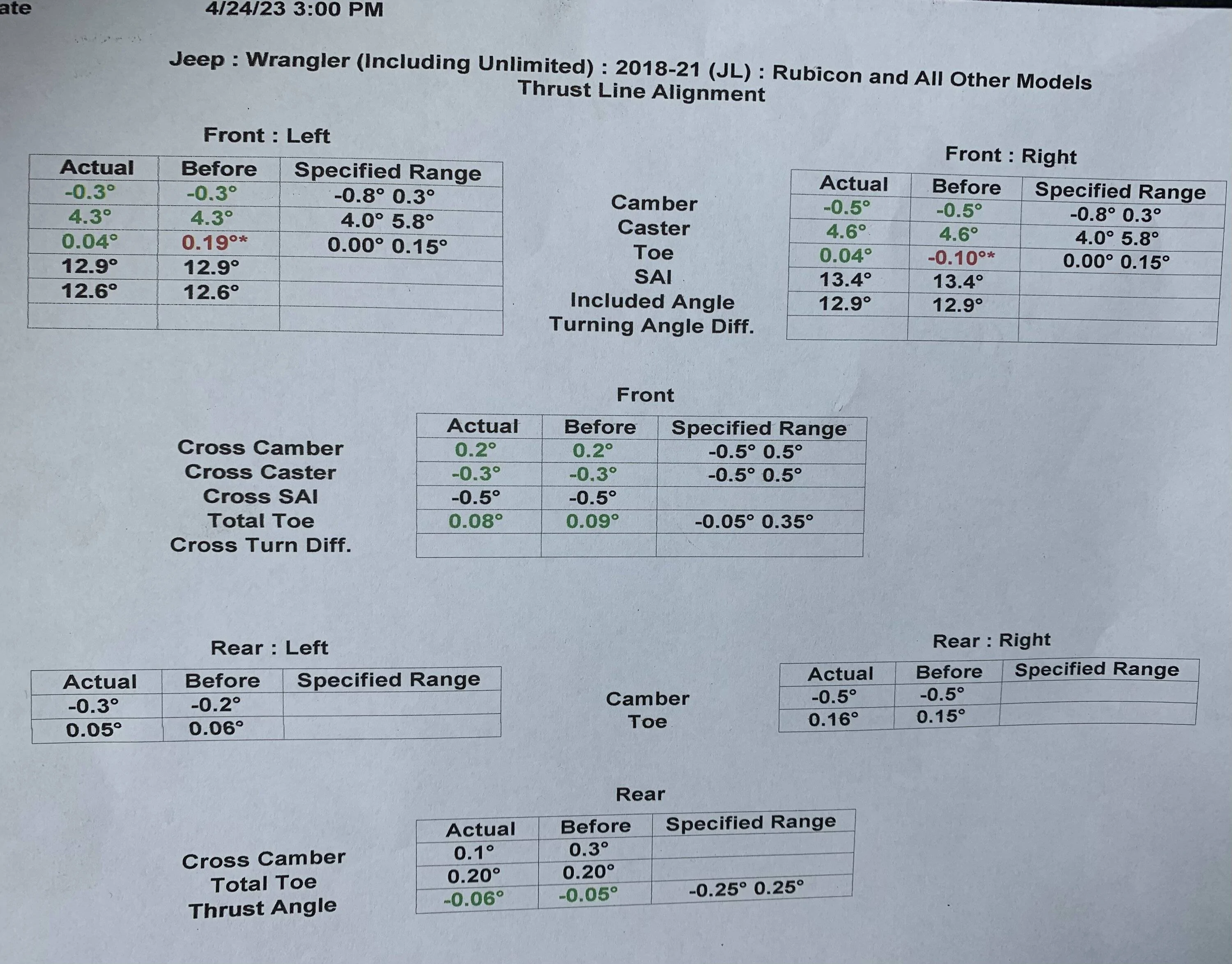

Reporting back after two weeks highway and local runs. I did retorque the bolts. The steering feels tighter and has better return-to-center. I had a slight left pull before the swap, now a bit right pull sometimes, I think it’s all due to road crown. Doesn’t bother me at all. Got the caster angles checked today, see before and after numbers for reference. Thanks everyone for all the useful tips! My Jeep tracks better. No regrets.
