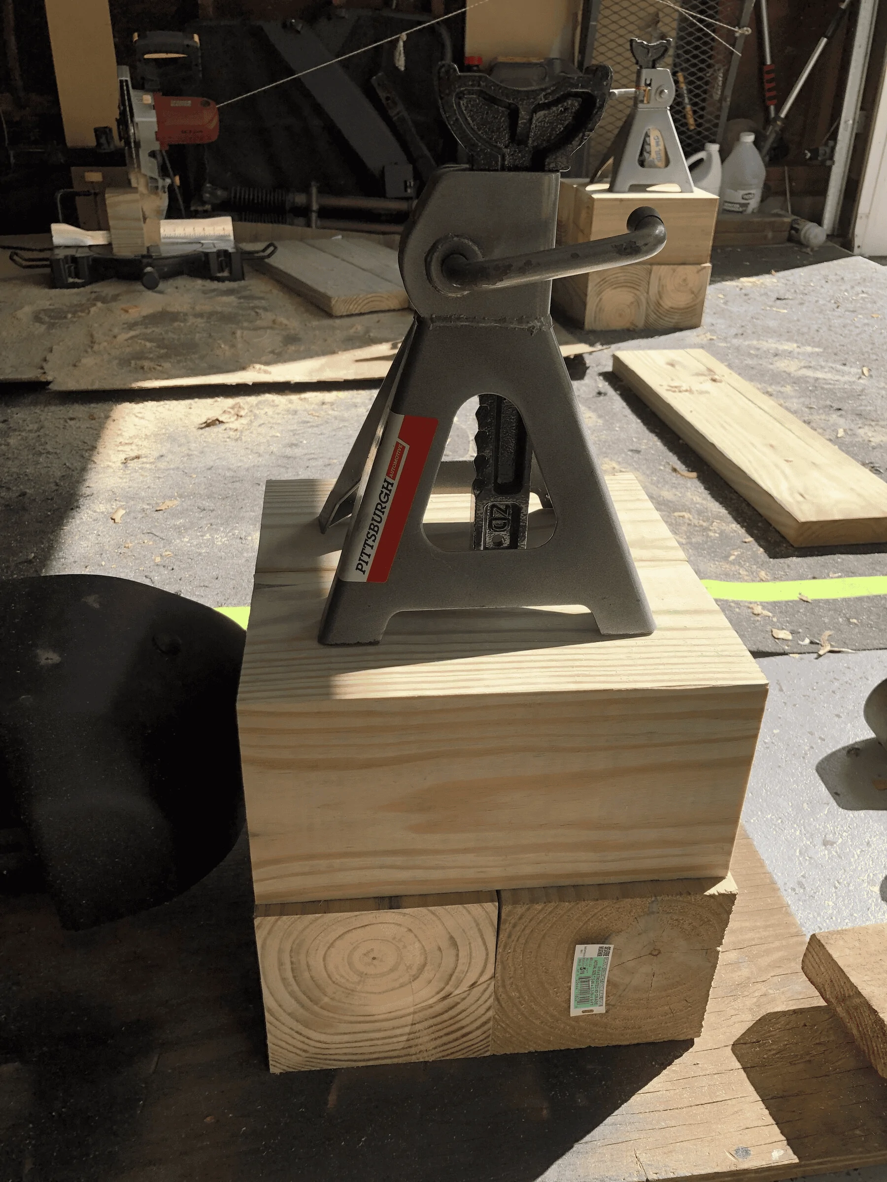

I just can't seem to get enough leverage from underneath.
Building some OSB ramps in the morning to give me more wiggle room under there.
The wheel cribs I built give me 9” extra head room. But my 24” long reach floor Jack barely made it to the point that I can slide the crib under the passenger front tire when I jacked up the axle tube. That’s why you’ll see I put the Jack on a 1/2” board. Otherwise I’ll have to use some small wood blocks which I didn’t prefer. I’ll buy a piece of 3/4” plywood later. No problem on the driver side since I jacked up the pumpkin.
My 90 teeth flex head torque wrench also helped give it more flexibility.
