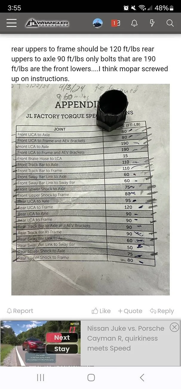

There is a torque spec on the clamp nut. I don’t recall it off the top of my head though. There’s a torque spec thread on here.
This helpful?
Jeep Wrangler JL Mopar LCA swap Screenshot_20240730_155557_Chrom
