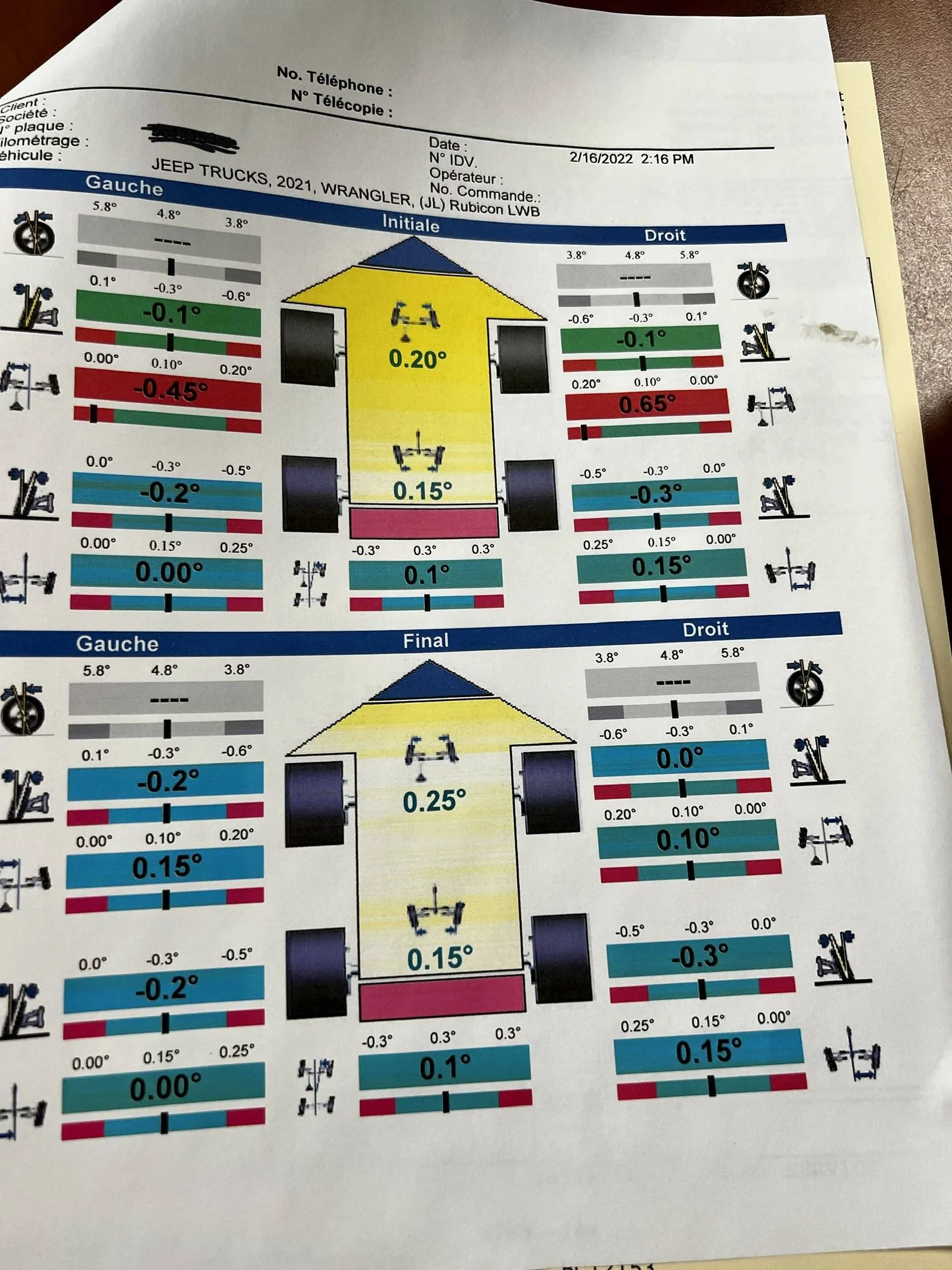

I'm stock Robicon height and the garage installed the 24.25 LCA's. When for another drive tonight and there is even a slight pull to the right if I Iet go of the steering wheel now.... ughhh i feel like it made it worse..How long are your new LCAs? [stock are 24.0"]. Unlifted, 24.25" should get you there. More if you are lifted via lift kit or spacers.
