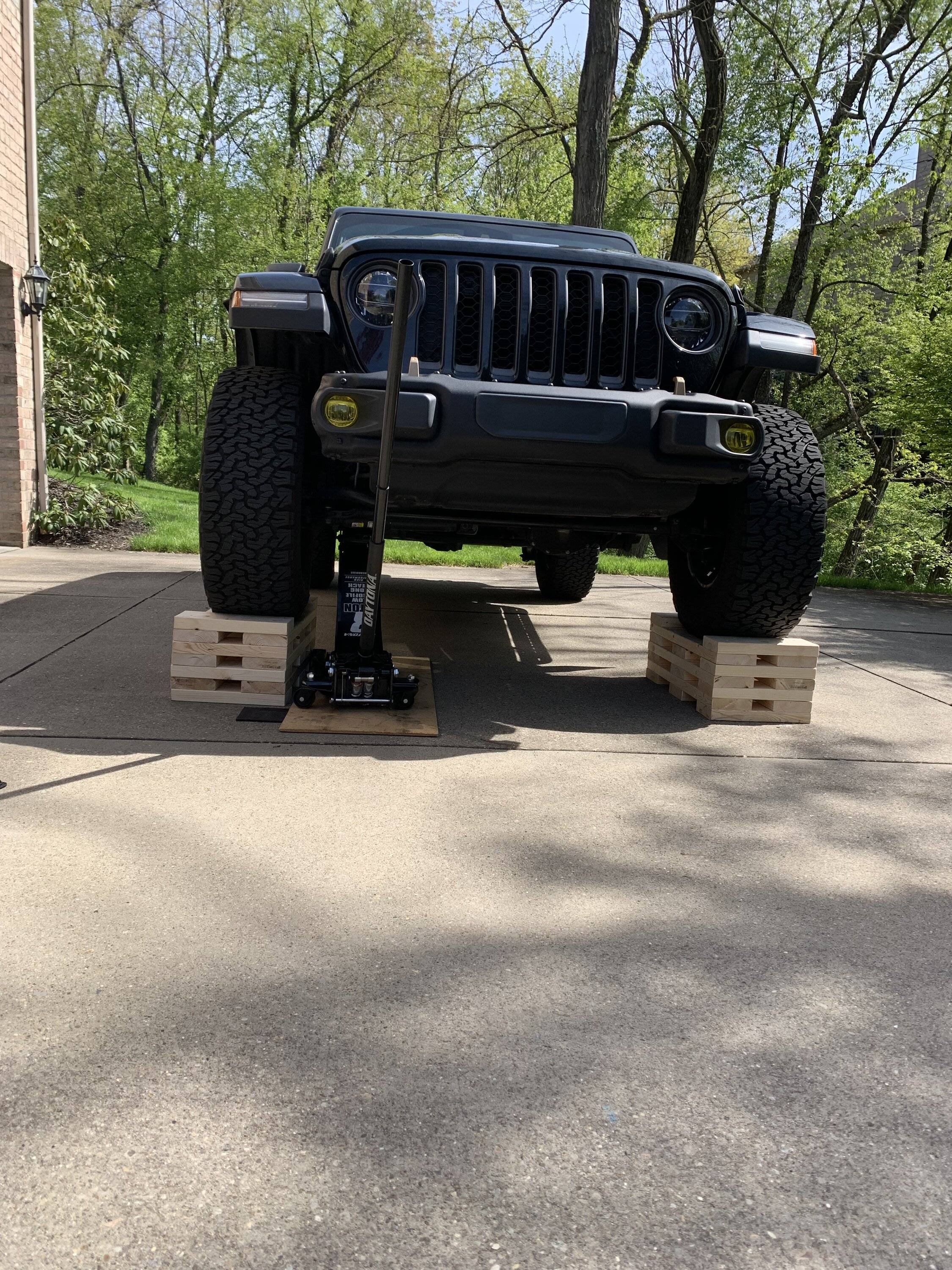

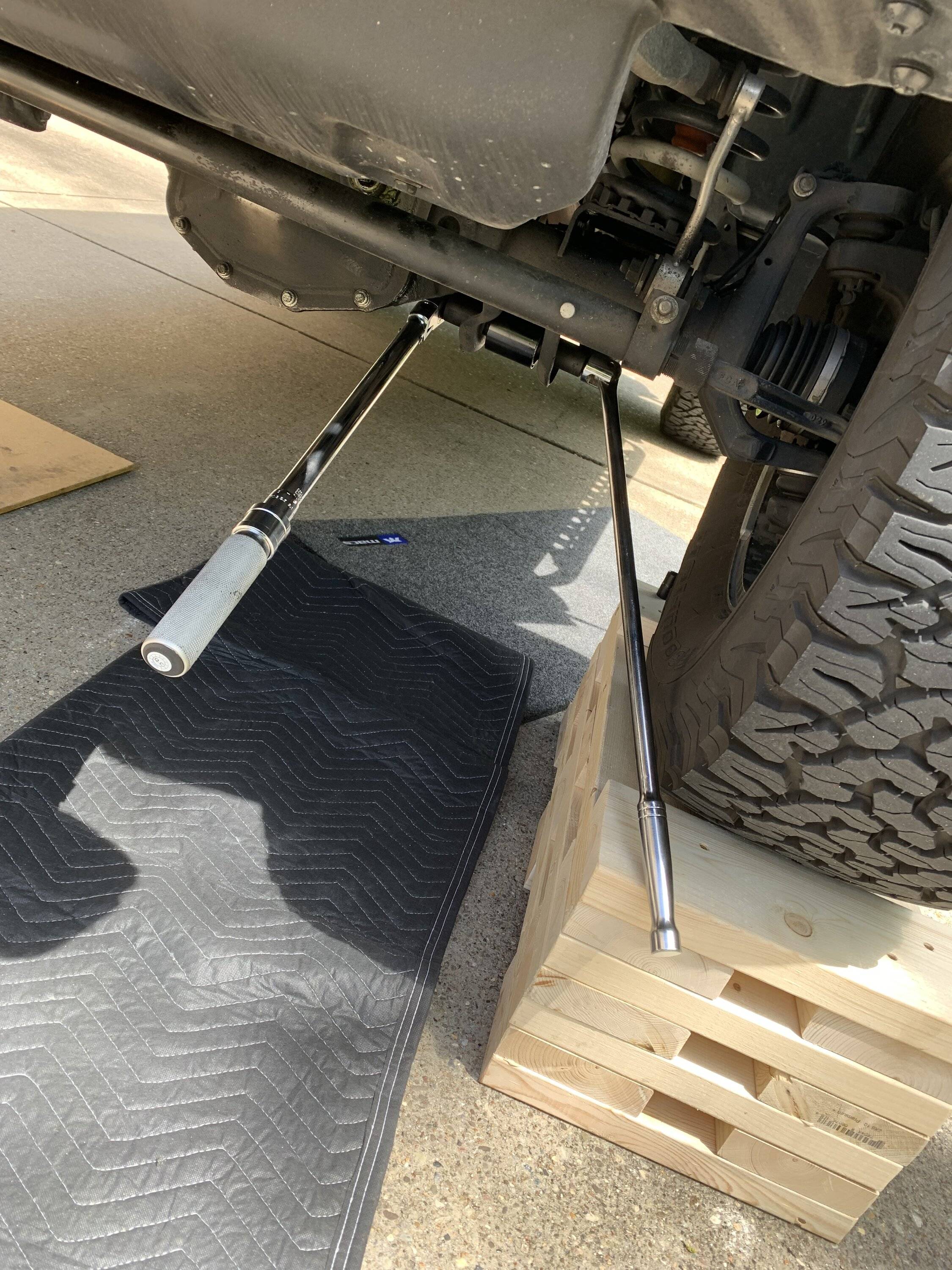

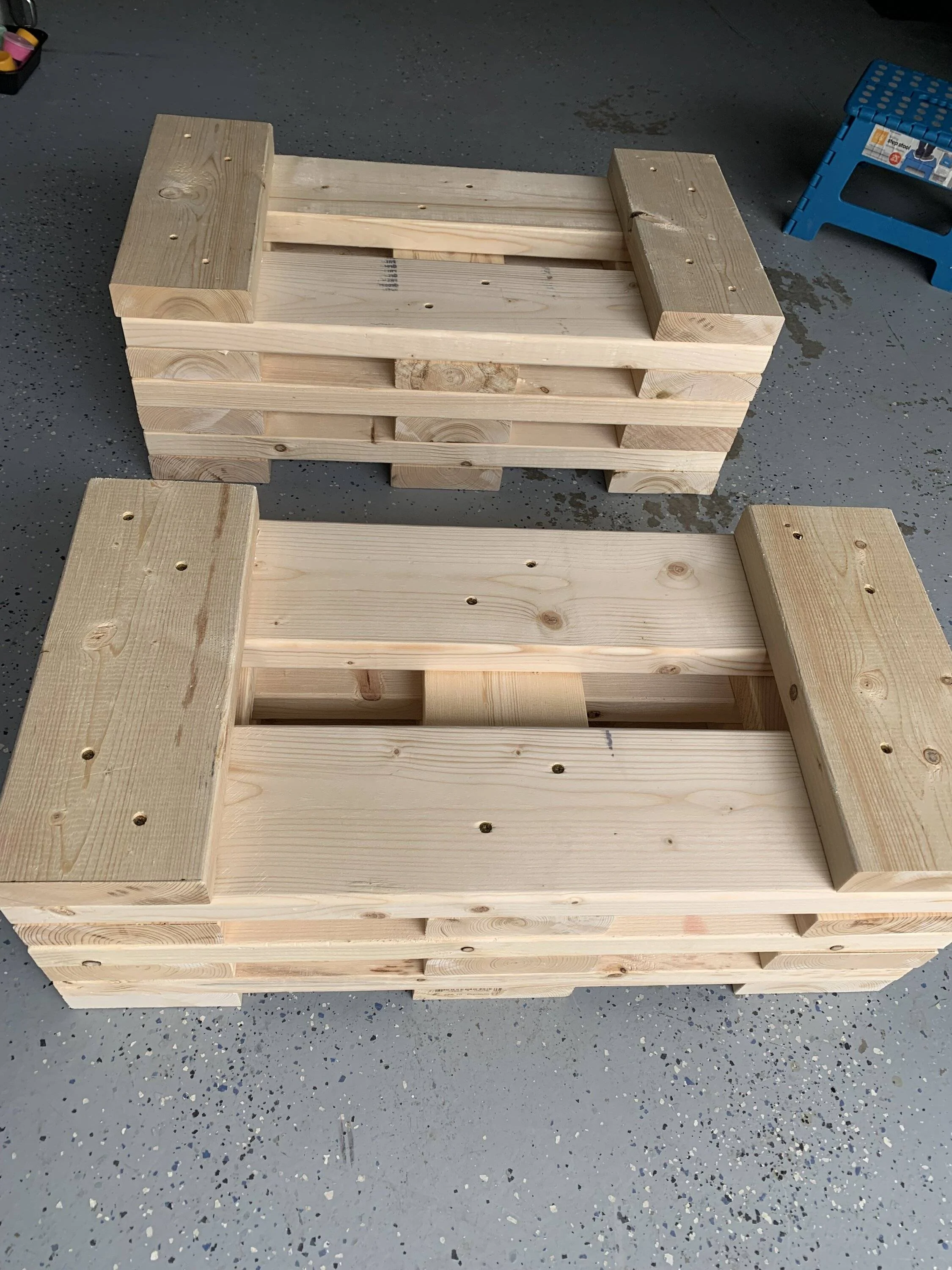

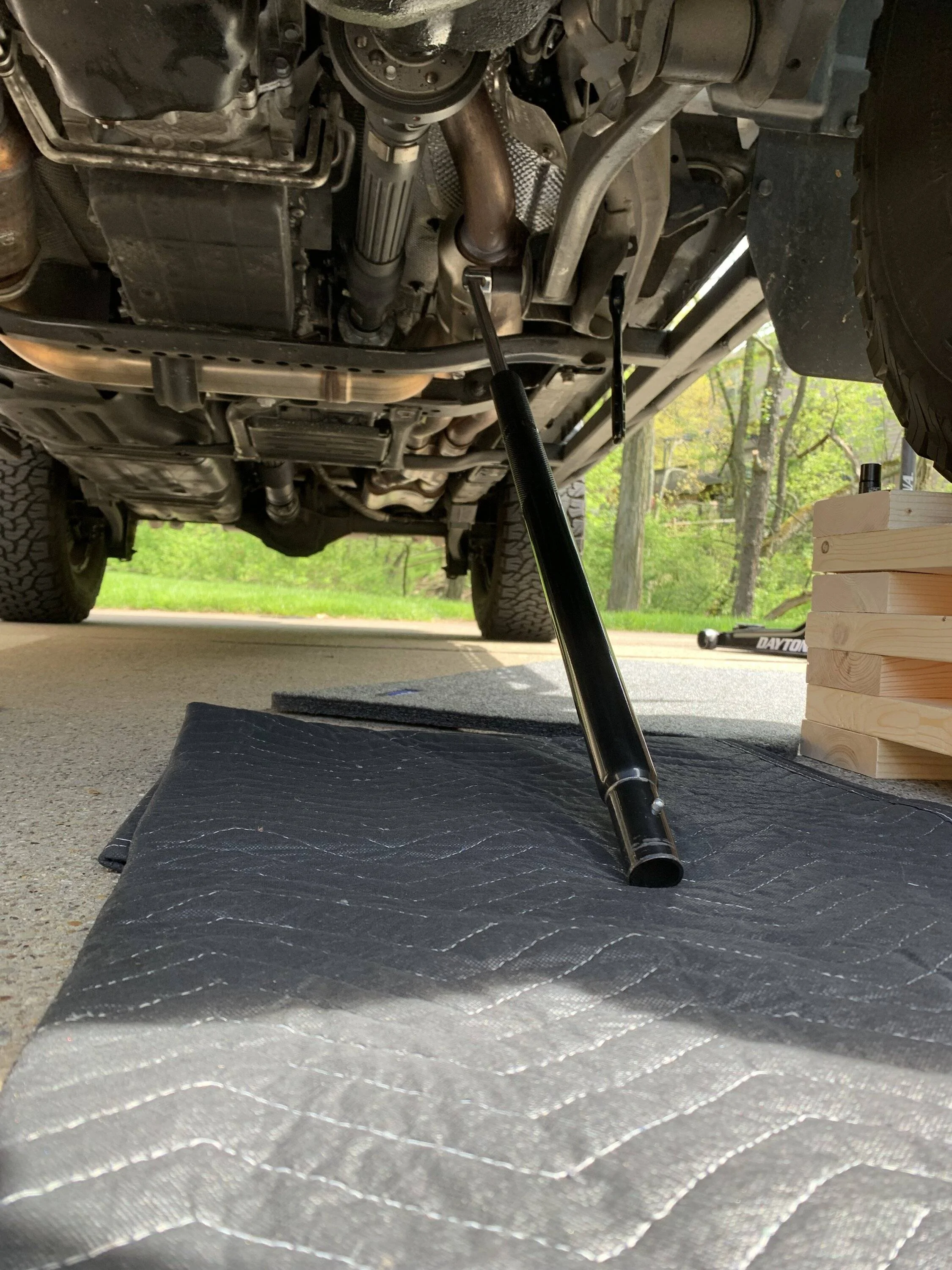

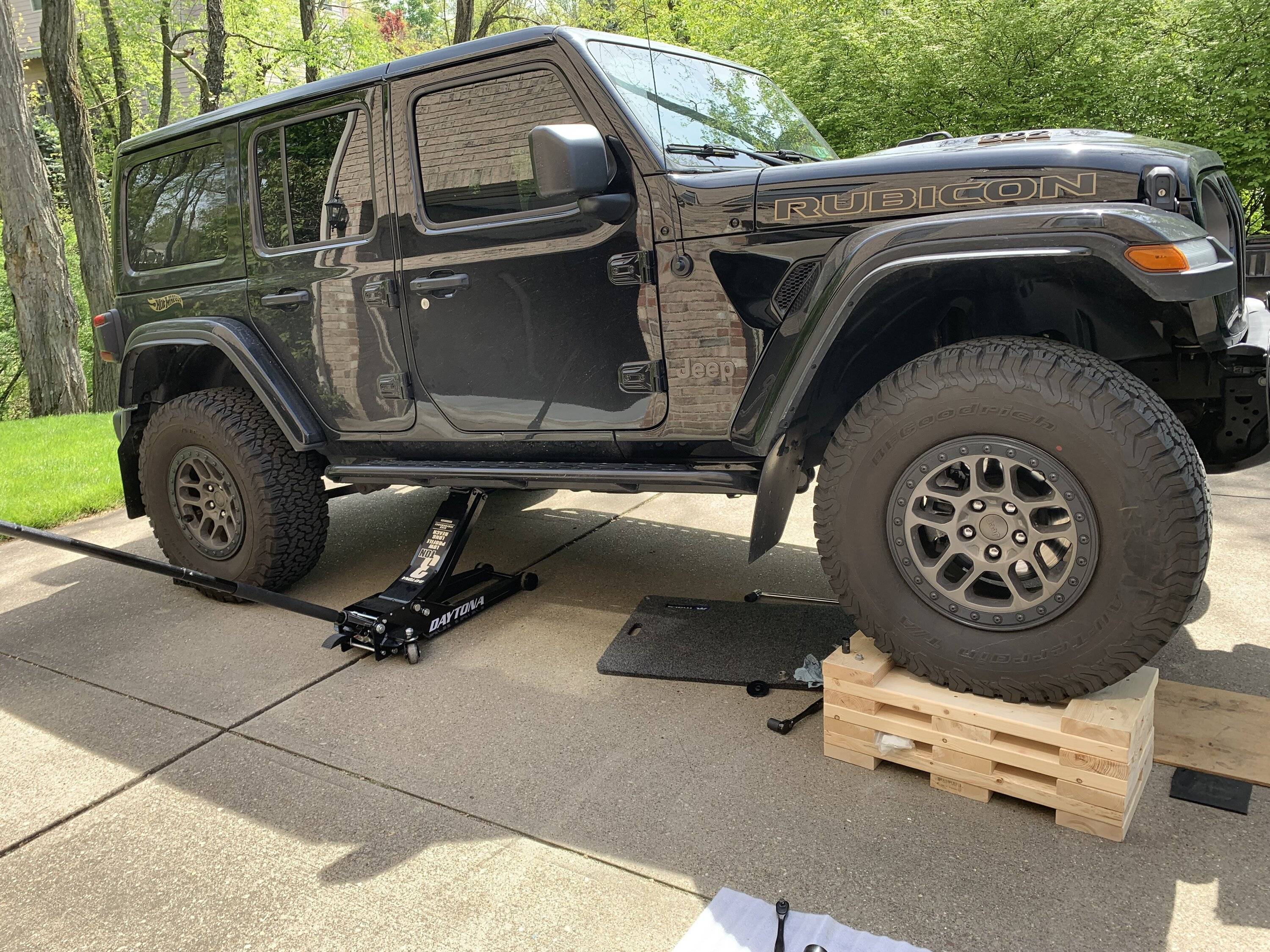

Another weekend project and it was fun. Made a very solid wheel cribs set and the extra 9” helped a ton for replacing the LCAs. I did use the floor Jack extension handle together with the breaker bar to break loose the bolts, not bad. Also used the cribs as leverage when I torqued the bolts to 190. Had to Jack up the frame on passenger side to align the holes but no need for the driver side. Will see if the Jeep tracks better with the increased caster angles.
Nice job on the cribs, should make a lot of vehicle chores much less of one :) And yes, I'm 99.9% sure the Jeep will drive noticeably better.
Thanks! Actually after seeing you suggested ramps, I thought maybe I’ll build ramps like yours. Later I came across these wheel cribs used by lots hot rod builds but very few Jeep uses them. I thought I’ll give it a try. They are solid with the center blocks!
