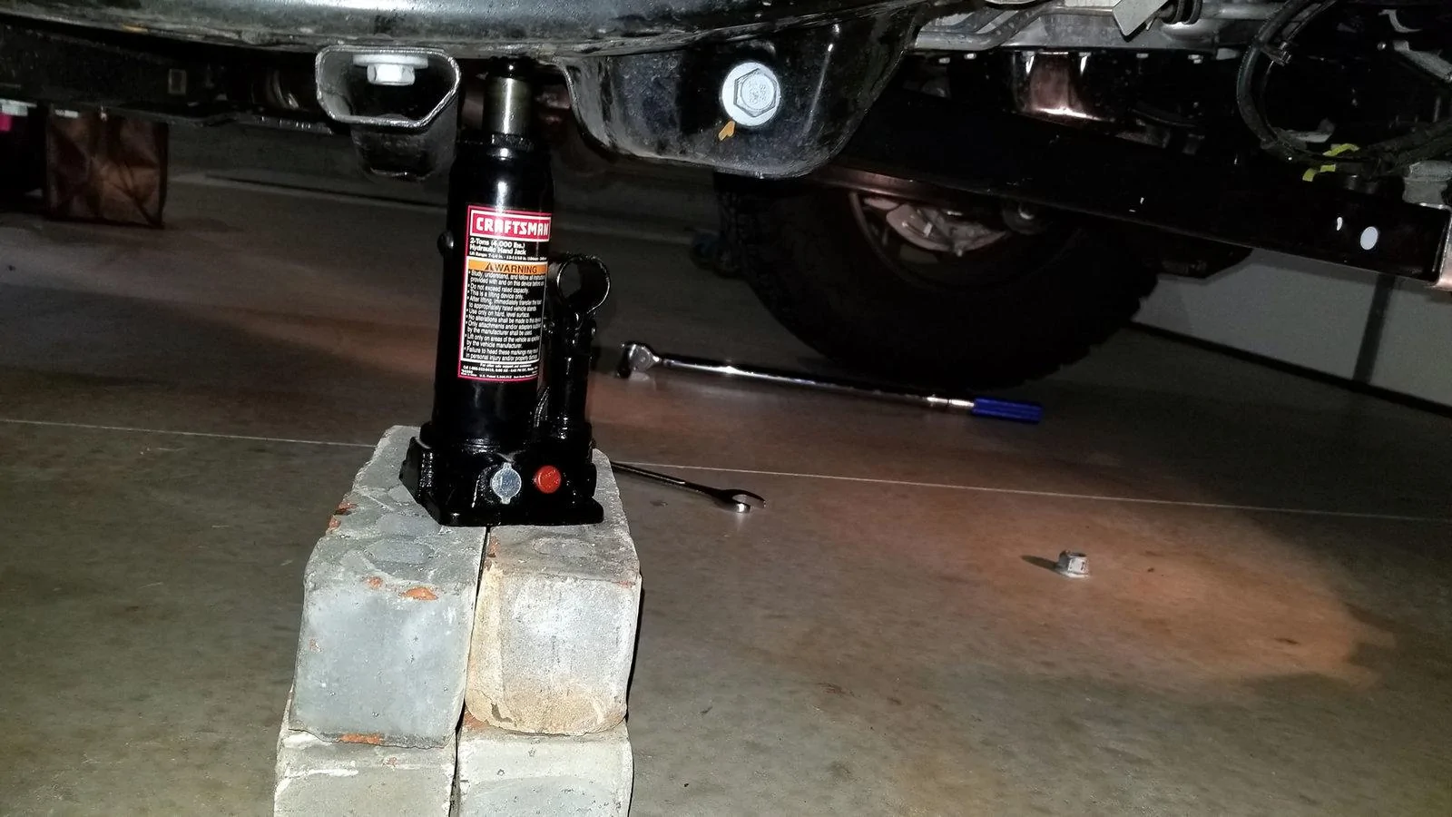

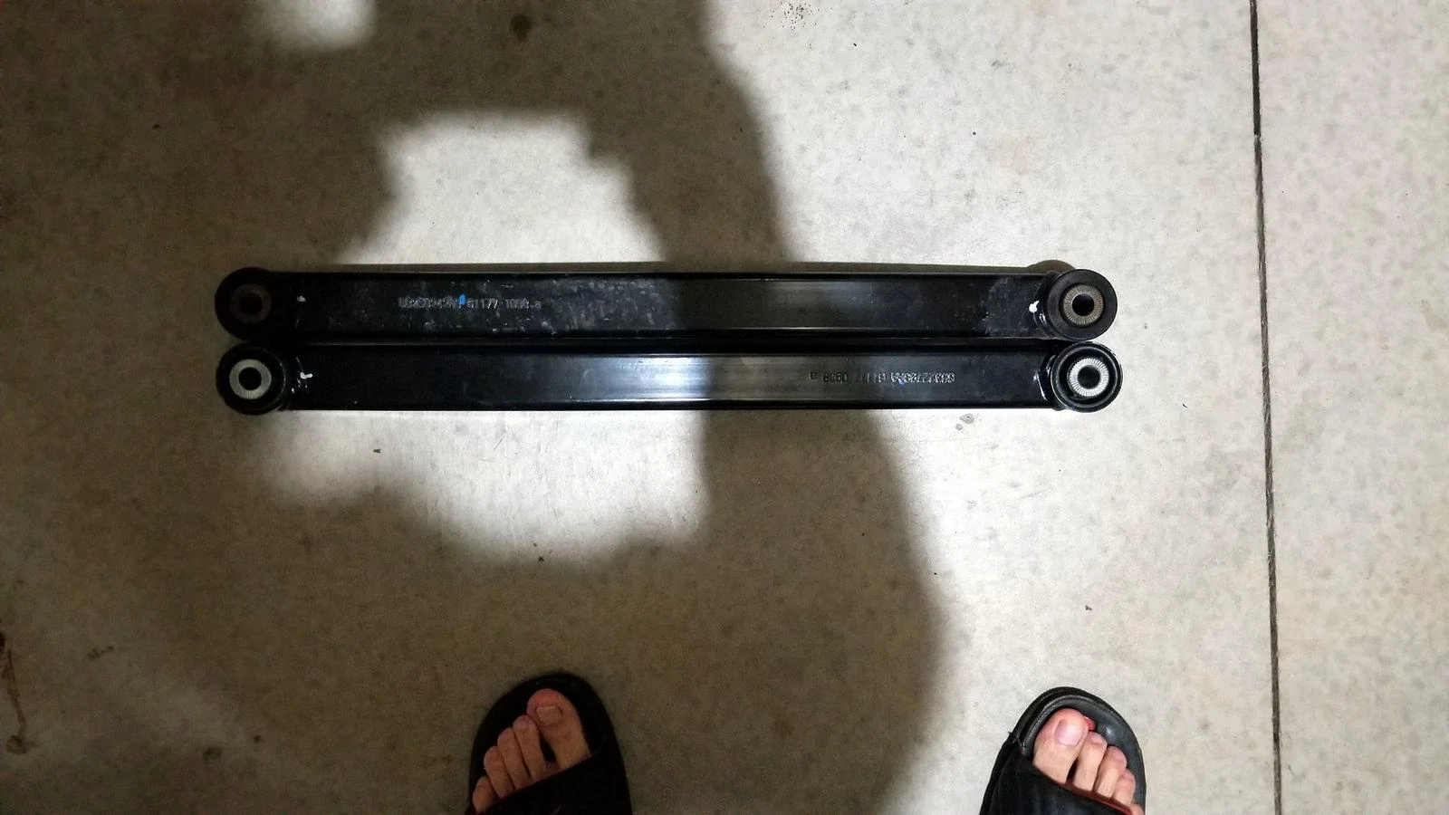

Thanks to this forum, I just changed out my LCA’s to these upgraded mopar pieces. And I do mean upgraded, they only appear to be slightly longer, but they are significantly heavier. They make the stock lca’s feel like they’re hollow when holding both of them side by side. This can be done without any lifting at all on your garage floor. My Milwaukee M18 impact zipped the bolts right out without a problem and the new pieces slid in with only a little nudge with a prybar on the first side. This upgrade is literally 20 minutes in your back and done. Drives much more solid. Mine is an all stock 2019 Rubicon 4dr and I had a lot of play in the steering. Seems to be a cured.
How did it go retorquing the bolts? Mine were a bit of a pain but I finally used the floor jack to lift the torque wrench enough to get them torqued to 190.

I didn’t have my torque wrench handy so I just put them back on with the impact driver, I couldn’t budge them by hand after that more than a quarter turn, so I figure I should be good...I hope. I’ll check them again after a few more miles. They are definitely built more solid than what comes stock for some reason.

Control arms should only be torqued when the vehicle suspension is loaded. So ground, ramps, or a drive on lift.
You can put on stands to get the old ones out and new ones installed, but do not torque them until you put it back on the ground.
If you torque while suspension is unloaded you will damage/destroy the bushings when you put it back under its own weight.

Rubicon stock height can completely be done with the vehicle on the ground, the others I’m not sure of. I went out for a hundred mile drive today on a mix of roads and it was a much improved experience, everyone should be putting these on, I see no down side.
