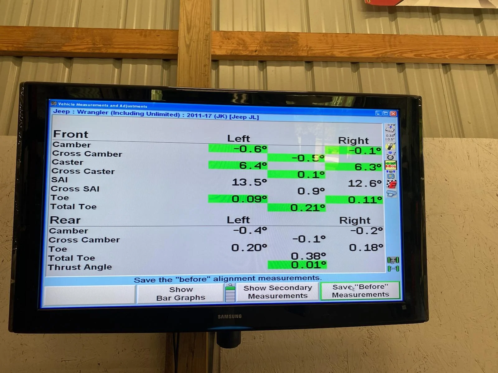

I wanted to report back after the installation of the longer Mopar control arms. Though my Rubicon did not suffer badly from steering wander initially, lately it had started to become more noticeable.
In conjunction with the LCAs, @rustyshakelford installed a new @Metalcloak trackbar, drag link, and tie-rod and a Synergy track bar steering sector brace. I had already replaced the stock steering stabilizer with a Fox model and Synergy relocation kit.
I can happily report the steering is vastly different and is now firmer with no wander. While we did not check the caster prior to the upgrade, it is now 6.4° (left) and 6.3° (right)--the OEM angle was likely in the 4.5° to 5° range. The LCAs may have a more pronounced impact on my caster angle due to the fact my Rubicon is not lifted.
In any event and until I install a lift kit which will include adjustable upper and lower LCAs, the longer Mopar LCAs were the best $60 I have spent.

Does this sound right? Please check my reasoning.
For a total toe of 0.21 degrees, with a 35” tire, the measured distance between the rear of the front tires and the front of the tires, would be:
tan 0.21 = X/35”. X = 0.126”
For accuracy, carefully draw lines on the tire treads as you spin the wheels. This requires something to brace the pen or pencil against.
Ok so you are now and before at .125" or 1/8" TOE IN?
