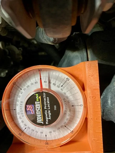

Hi all, I've been following this thread for some time and a few months ago I did the same thing. Got under the Jeep and tried measuring my caster with a magnetic angle finder.
I've always felt that I had pretty good steering, too, though there is some play. May end up trying to get the box replaced, but that's another story.
I was also surprised that my 2018 2-door Rubicon seemed to be showing me about 6 degrees of caster. I measured multiple times and always got pretty much a 90 degree angle on the front diff. This was before I made any changes to the suspension. Stock shocks, springs, control arms, etc. So maybe it's not something changed on 2021s that would explain this...

I have doubts about my measurements and before I saw these posts I shrugged it off to I don't know what I'm doing when it comes to measuring caster. :CWL: What I should have done is taken it in to get put up on the alignment rack and get real readings, but I didn't.
At any rate, I have since added 2" of lift and after that did get an alignment, and the caster was 3.9/4.3. I will be swapping LCAs with the longer Mopars soon, and will get another reading after that. But approximately how much should we expect caster angle to change from stock with 2" of lift without changing out any control arms? It seems that there are a lot of variables.
Just sharing my experience, and always trying to learn more!
It's roughly about 3/4 to 1 degree of caster for every inch of lift, so your 2" extra lift will decrease your caster about 1.5 to 2 degrees.
Since you have a Rubicon and a 2" additional lift you may want to look into adjustable LCAs as the longer Mopar LCAs may not be enough.

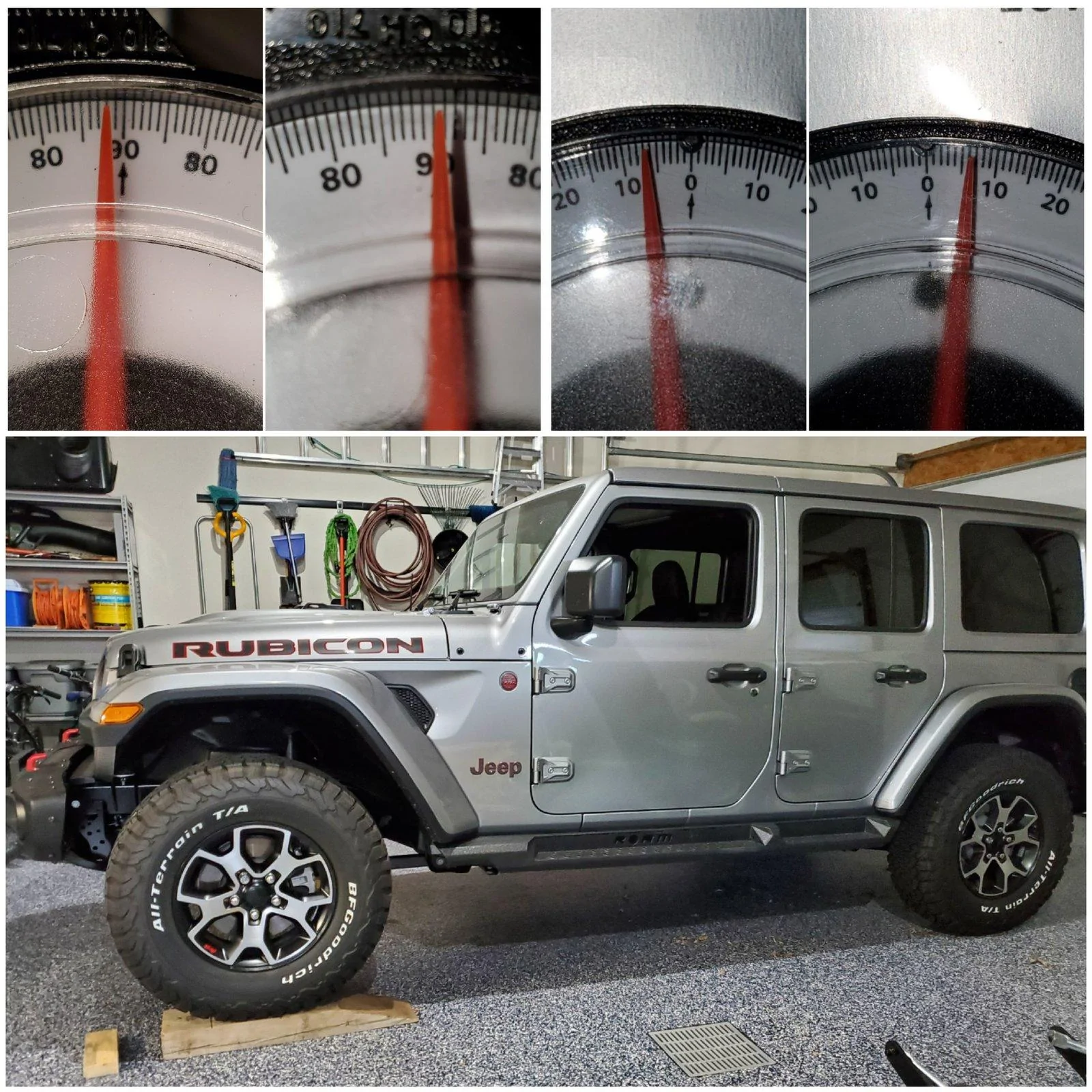

Wow..what a driving difference. Took out on highway with 17mph wind and could easy steer with 1 hand on steering wheel and drastic improvement with the wandering. May have been combination of new steering box a few weeks ago as well as these mopar LCAs.
A few issues getting the LCAs after a few shipping/quality issues but just installed this morning. Great easy project with my 15 year old son and took us 2 hours taking our time. Breaking the bolts loose was tough but with impact and breaker bar we got it. Used 3.5" wood ramps to give more room under Jeep. Had to use floor jack for minimal adjustments to align bolts on new LCAs. Tourquing was a workout as 190lbs is tough..hardest was passenger frame side as tough to get angle and leverage.
Stock 2020 JLUR measurements at pumpkin was 4.5* pre-swap and 6.5* after. Consistent with measurement at knuckles showing 6.5*.
Thx again for everyone's advice and detailed installations.
Stock JLUR measurements at pumpkin was 4.5* pre-swap and 6.5* after. Consistent with measurement at knuckles showing 6.5*.
Awesome feedback there! Great to have your JL driving down the road without worry on your part. Our 2dr Sport w/ Rubicon lift, Longer Mopar LCAs, and the new cast iron steering box is now as perfect as I could have imagined prior to all of that. The new box seemed similar to the old aluminum unit until I racked up 1500 miles last week on a Vegas road trip. I think we had air in the steering lines that worked out of the system as it's so tight and true now, and that Caster at 6 is just right!
