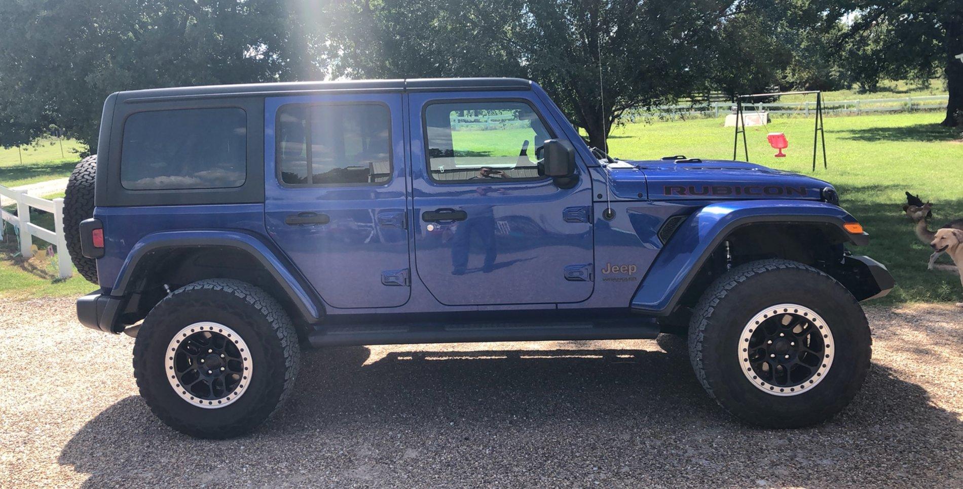

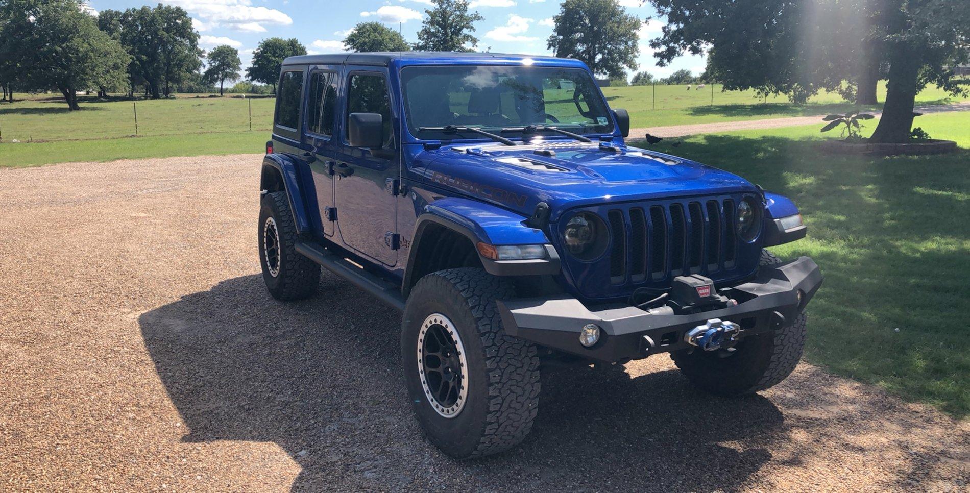

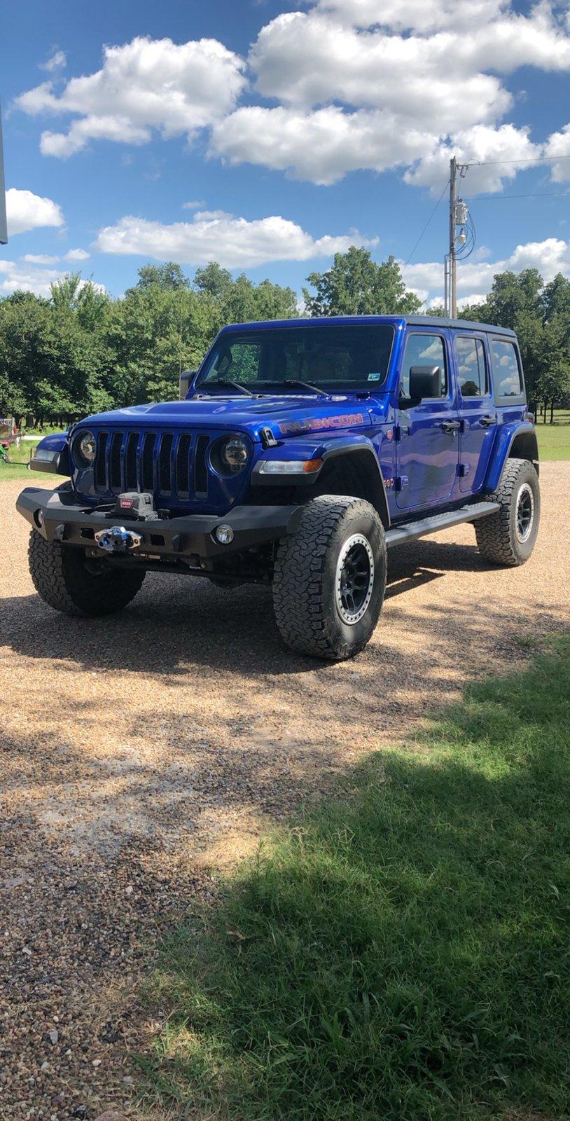

Swapped in the Mopar lift LCA’s today after installing my Dynatrac EnduroSport 2” lift with .5” Teraflex leveling spacers in the front. The control arms themselves took maybe 10, 15 minutes. Lined right up with a little pushing.
