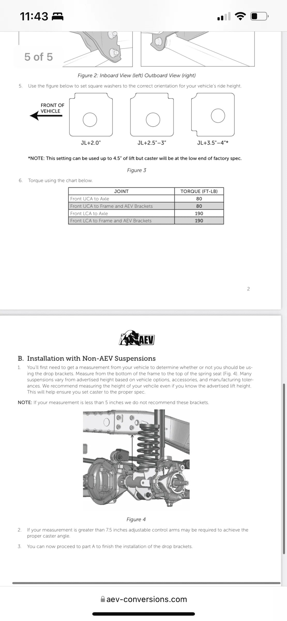

First, forgive me for being lazy but, I only read a few of the first and the last couple of pages. So, My JLUR has a build date of Aug 21 and is currently stock. New house being built should be done by May so waiting to have a garage before starting on Mods. First up, AEV 2.5 Dualsport and 35"s. So, my question is...even though the AEV lift comes with Geo Correction Brackets, should I do the Longer LCA's anyway at the time of installing the lift or will the Geo Brackets take care of the caster with the stock LCA's?
The Geo correction brackets have 3 settings and should get the front caster to spec. You’ll want 6-6.5 degrees. In the event they don’t, you can run the longer Mopar LCA with geo brackets.
I am running the same lift and you will definitely want an adjustable front Track bar.

@Hucke_250 I guess my question/concern is...did AEV engineer their Geo Brackets based off of the Actual stock LCA's or what the correct caster Should be for the positioning of the settings.
I would think that AEV designed the geo brackets to get the caster within factory “spec” with the stock lca’s. Here is a link for the factory alignment specs https://www.jlwranglerforums.com/fo...heel-alignment-specs-toe-caster-camber.17832/ I ended up installing Clayton adjustable lca’s before my alignment because I wanted my caster to be exactly 6.5 and liked the idea of having upgraded bushings.
check out the AEV suspension thread. I am pretty sure members were/are able to get within the 6-6.5 degree range with geo brackets and factory length (short) lca’s.
