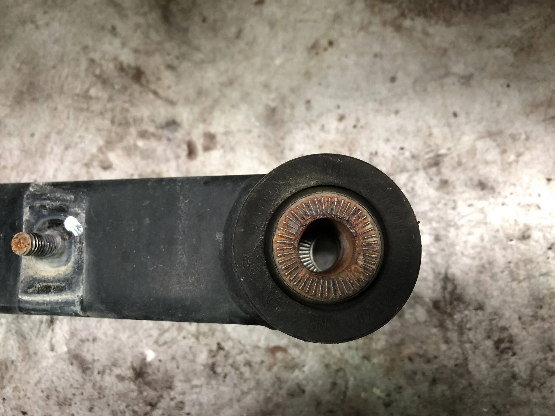

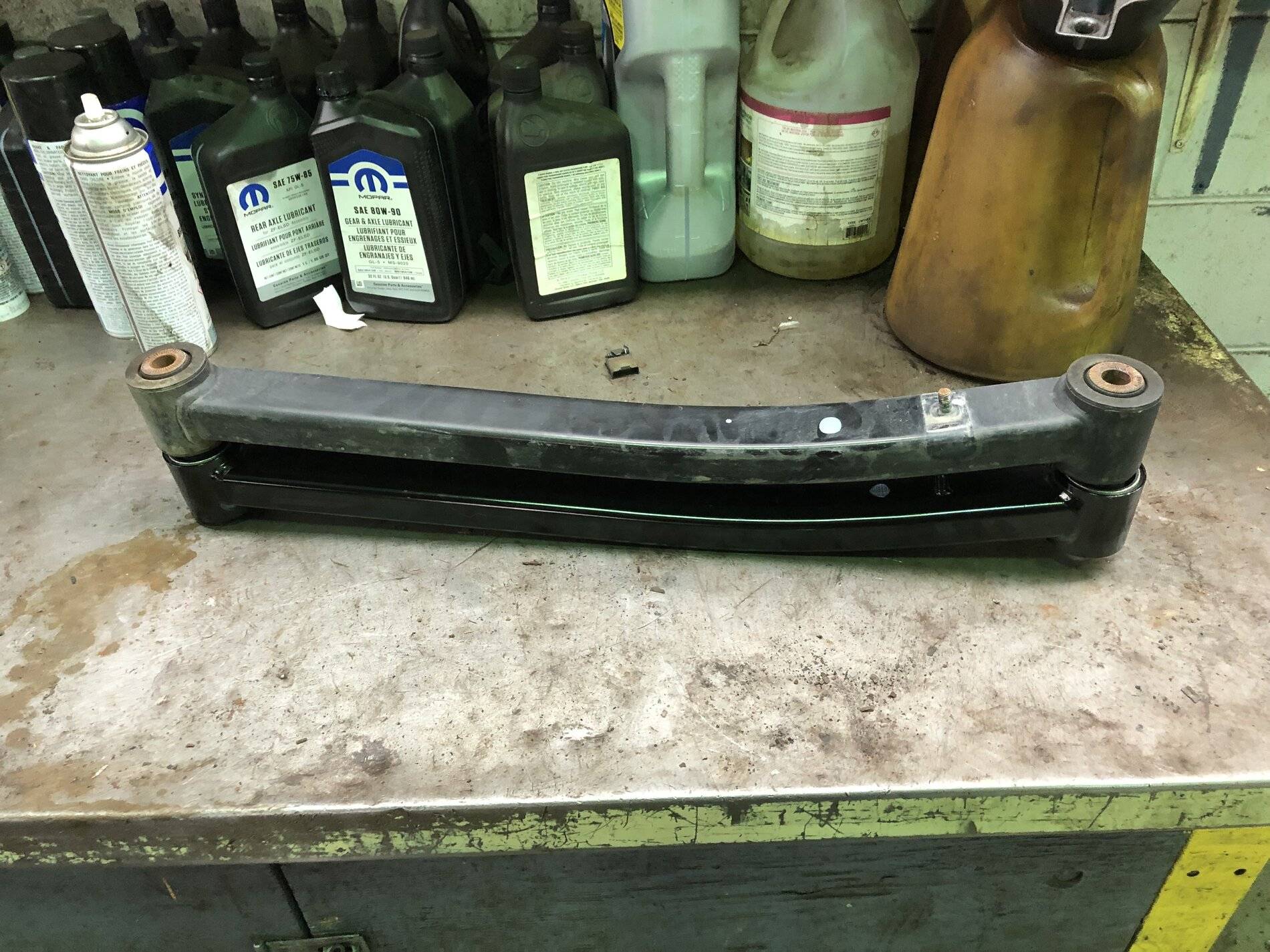

I got my LCA replaced with the 68322798AA on my stock Rubicon this morning, my caster went from 4.81/4.93 to 6.07/6.30.
With the new steel steering box and the longer LCA, it almost handles like a regular car… I’m happy !
Since the front LCA hole/bolt/frame had some play, we did a full front end alignment.
I was surprised that the technician’s computer had different torque specifications. In lieu of the 190 ft-lb as stated in the Mopar 2” Lift Kit instructions, he had something like 103 ft-lb plus 145 degrees, it was the first time that I saw such specs. His torque wrench also had the settings for the ft-lb and the degrees. So he had one beat when he reached the correct ft-lb and another one when he reached 145 degrees after the 1st beep.
Here’s some pictures showing the difference in length between the old and the new LCA:
