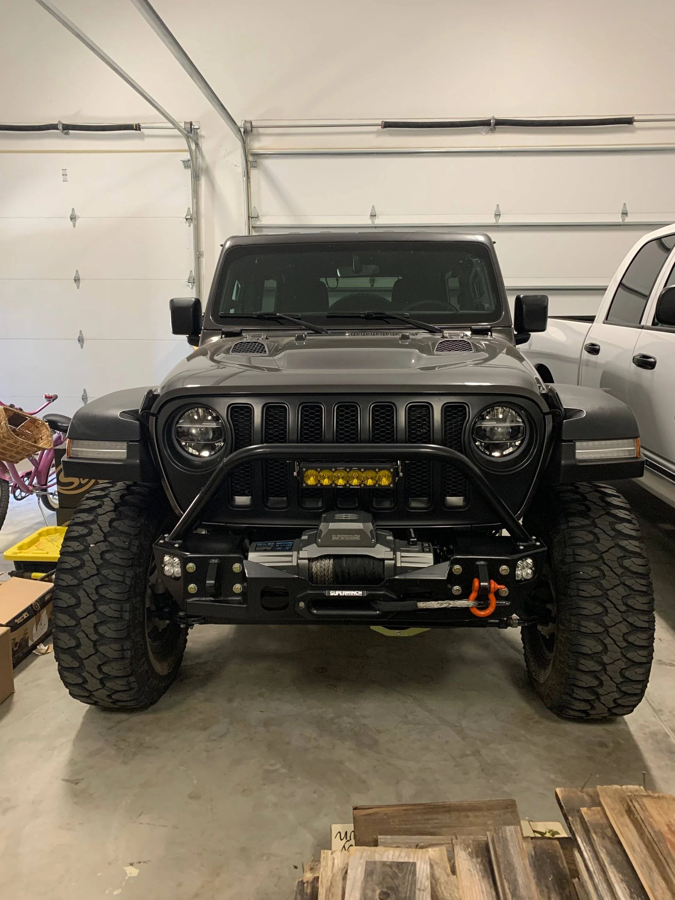

Careful with that. You'll scar the fairlead which will cut your line.
I cut a piece of rubber that sits behind it now to prevent that, just not pictured. I’ll upgrade eventually but lift and tires were more of a priority and I don’t like leaving line out to attach it to the recovery point on the bumper.

Yeah price makes sense, that way if it gets damaged, it's really no big deal.... $20 buys another one. Have you put it to the test ???
Multiple times, worked like a charm. I've only run soft shackles through it, but I'm sure a steel shackle would work just the same.

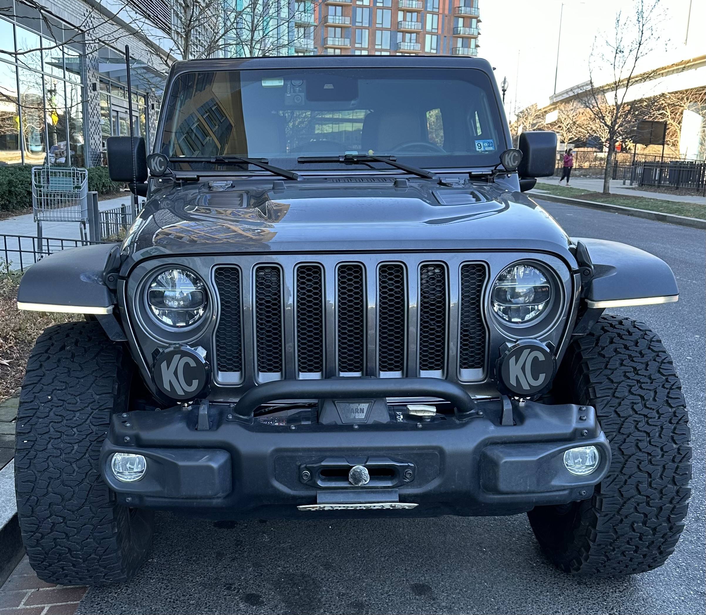

I'm a fan of the Factor 55 gear. The yellow plastic is just a template (flexible cutting board) to see if it keeps my winch drum/synthetic cable from getting road salt/chemicals all over the drum.

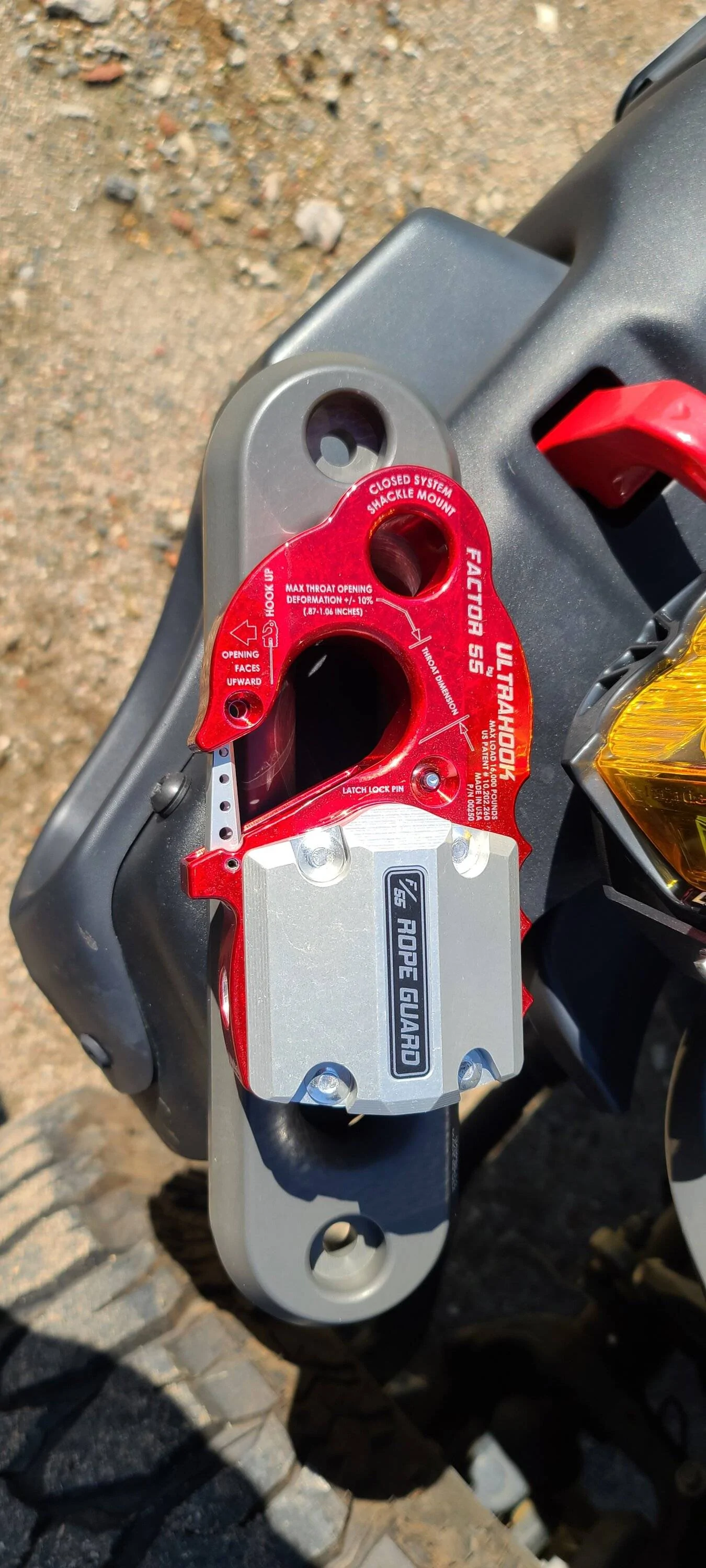

Except for my Bubba recovery rope, I went with Factor55 for the rest of my winch equipment, including the Ultrahook with rope guard and 1" fairlead...

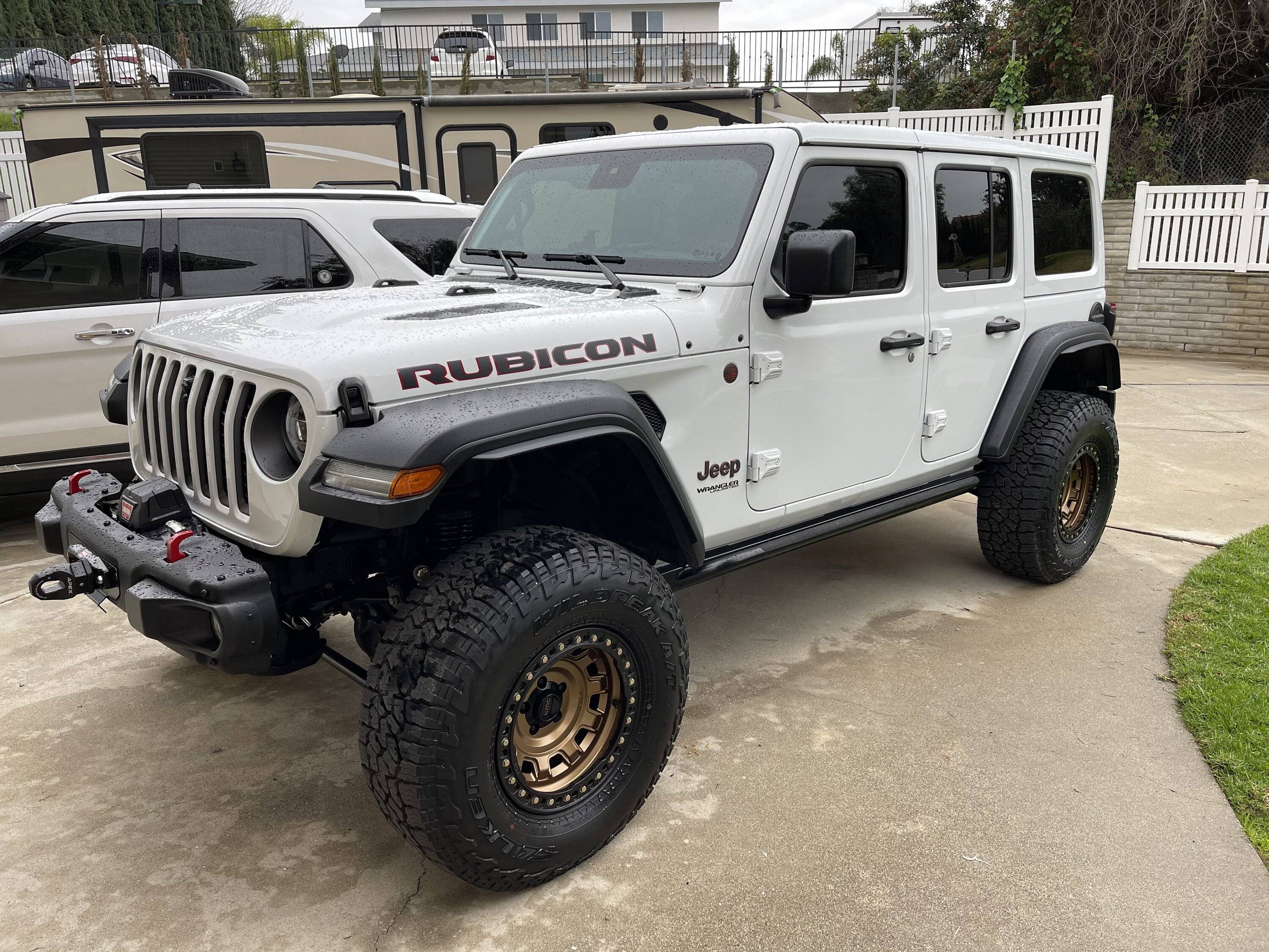

Another option to consider is no hook. I try to minimize the amount of metal needed for all of my winching operations. I just leave the rope thimble open and attach it with a small steel shackle to secure it. When I need to use the winch my first choice is to use soft shackles with the thimble.
If something breaks during the operation, there will be no metal pieces flying at me or anyone else. I always carry metal shackles and other recovery gear just in case I need them, but my default is soft shackles.
