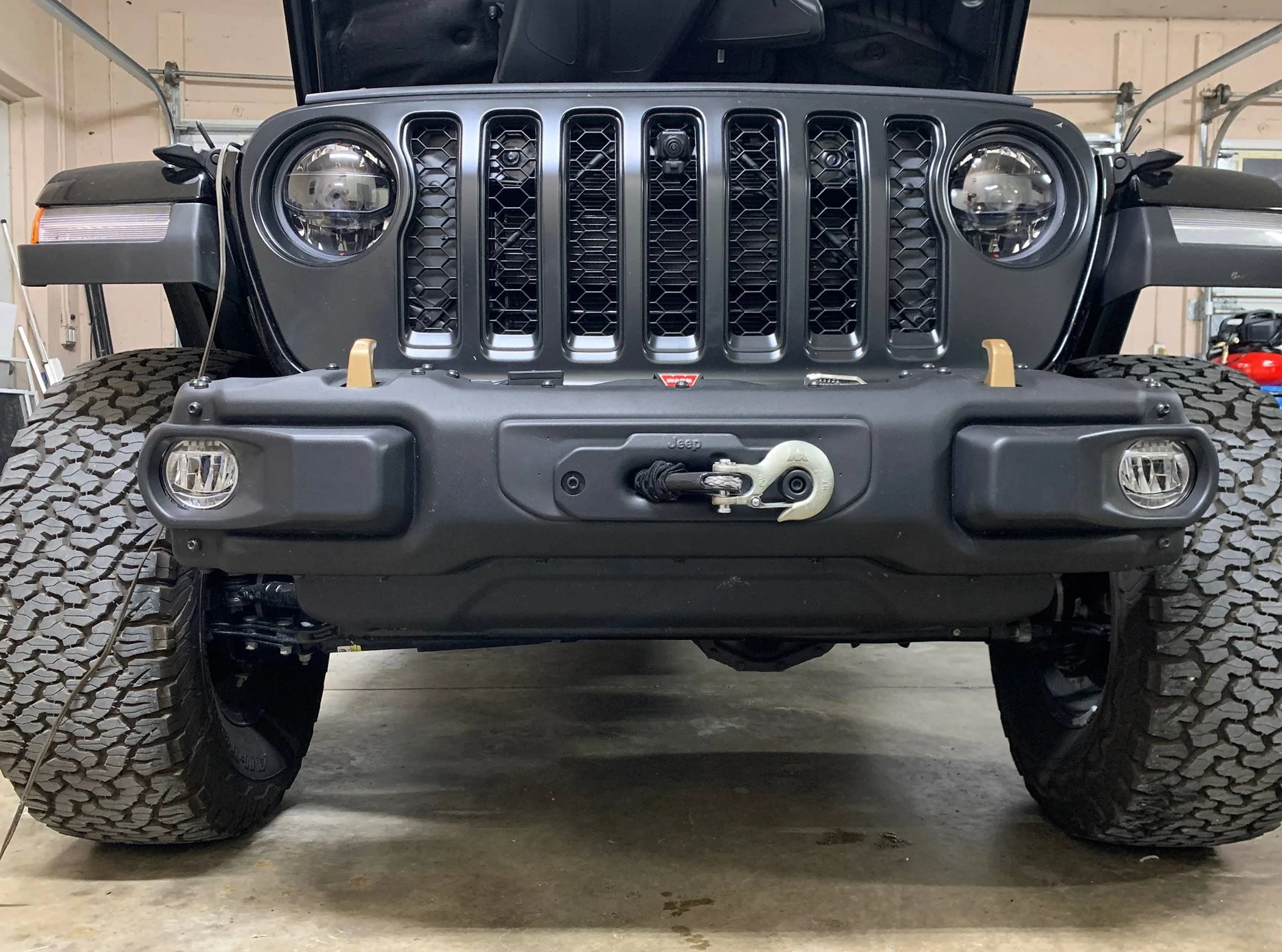

Really depends on how much you will realistically use the winch?
Or is a "look" you are going for?
Basci Warn hook that came with winch served me fine over the years when I did a lot of hard-core rock crawling. Lots of winching.
With my new Jeep, I knew I wouldn't use winch much, I tried to keep it as simple as possible. I ordered a factory 2024 Jeep fairlead for clean look.
Remote mounted winch control pack inside engine bay for lower profile. Warn Zeon 12S.
Do you have pics of where you mounted your control box?

You can pull the Warn rubber control cable cover from the metal housing and use to protect plug, where ever you end up mounting it. For me, as you can see, control plug is just in front of where control pack was mounted. I later used factory rubber plug cover to protect in newly mounted location.
