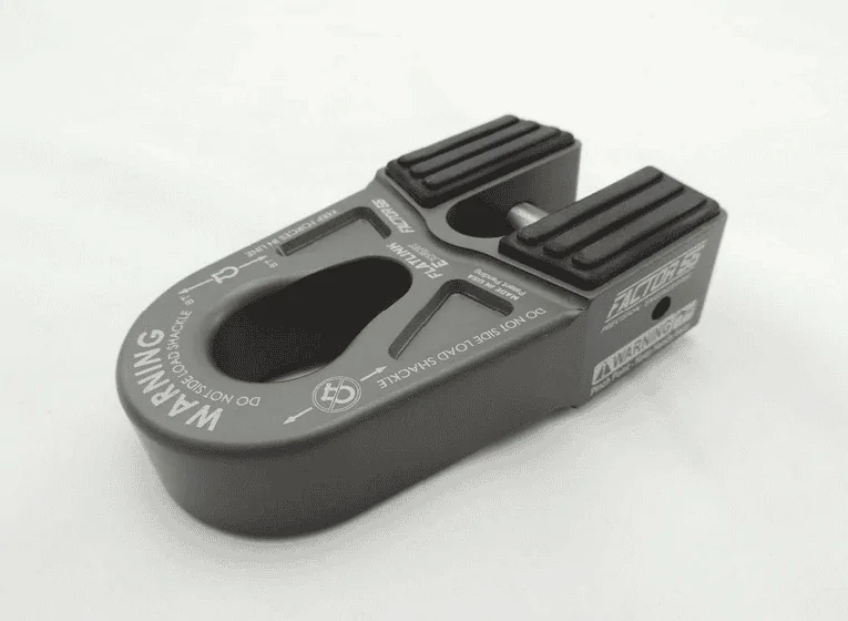

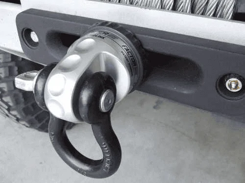

I’d go with the flat link. The pro link sticks out much further than you’d expect. It’s not ball hitch deadly but it’ll smart when you whack into it in the dark ?

Yeah, didn't think of that, I'll find out how long it is.. thanks.

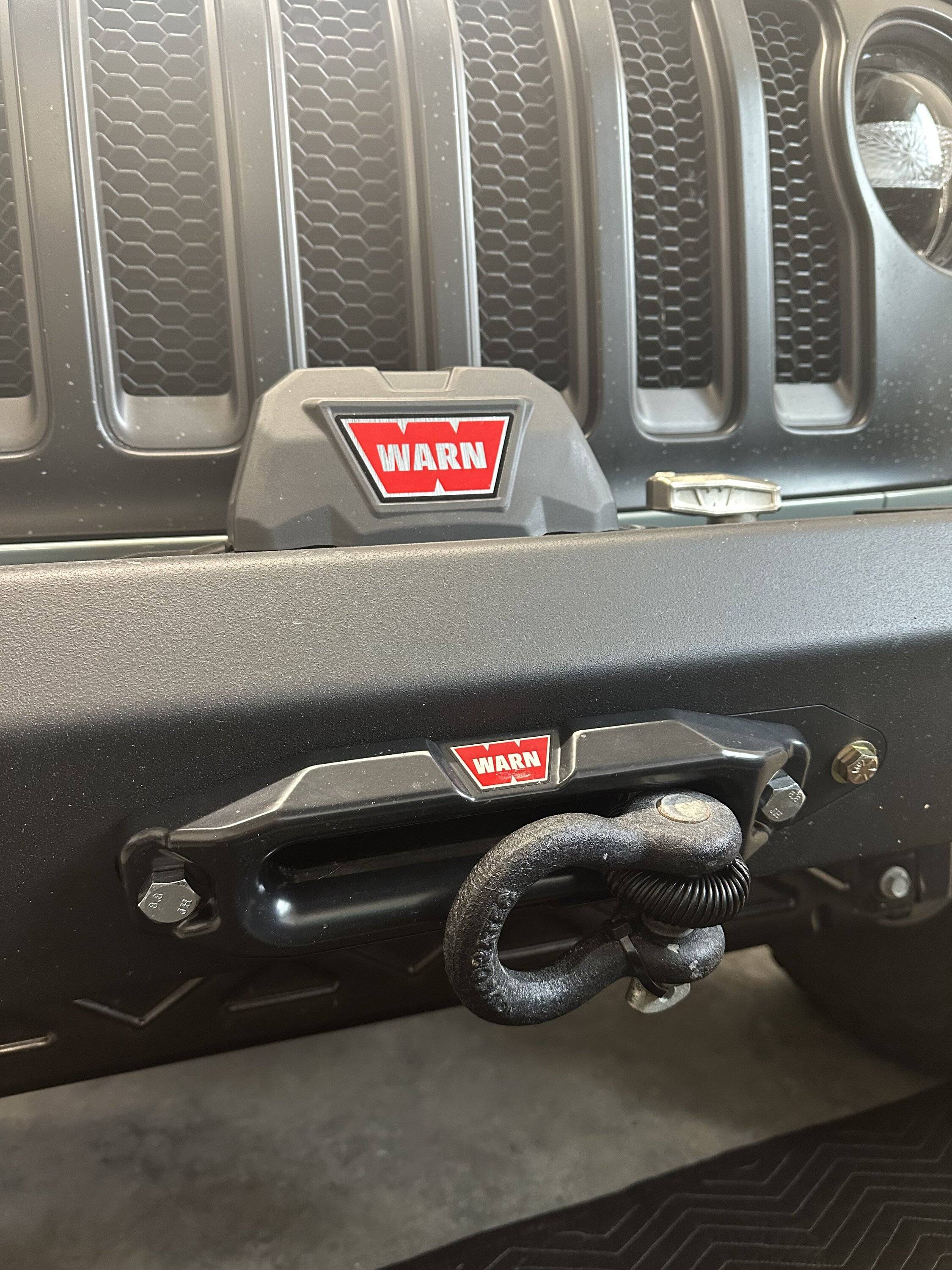

I didn’t like the hook and wasn’t ready to spend more on fancy shackles. I just put a shackle on and zip tied the pin so I can’t fall out. Suck it up tight to the fair lead and it doesn’t move. I also put a piece of wire loom over the end just to help keep the winch line out of the elements.
Careful with that. You'll scar the fairlead which will cut your line.
