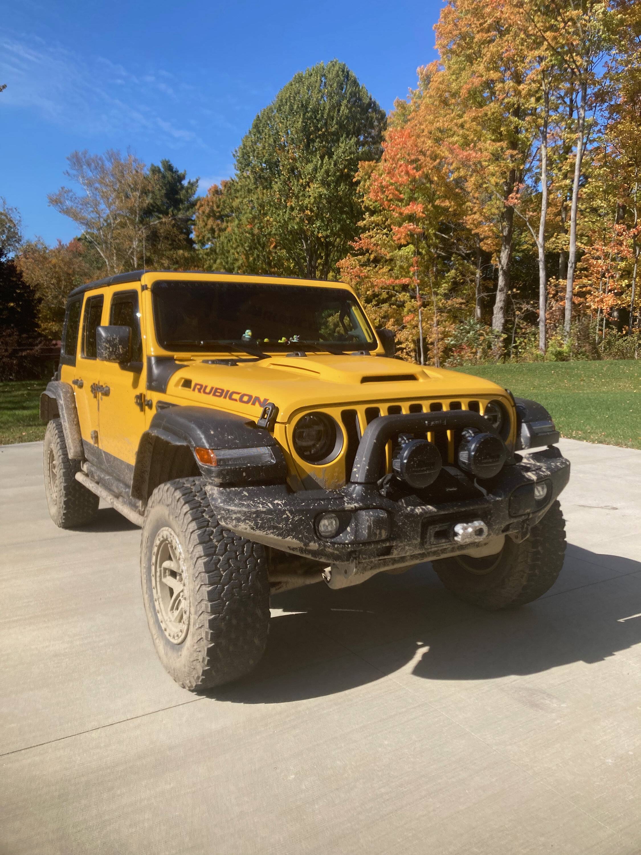

Warn makes Stealth winch covers specifically designed for either the Zeons or VR Evos. They both include zip able windows for the drum which allow full functionality without removing the whole cover.
https://www.northridge4x4.com/part/winch-covers/107765-warn-stealth-series-vr-winch-cover
https://www.northridge4x4.com/part/winch-covers/102639-warn-stealth-series-zeon-winch-cover

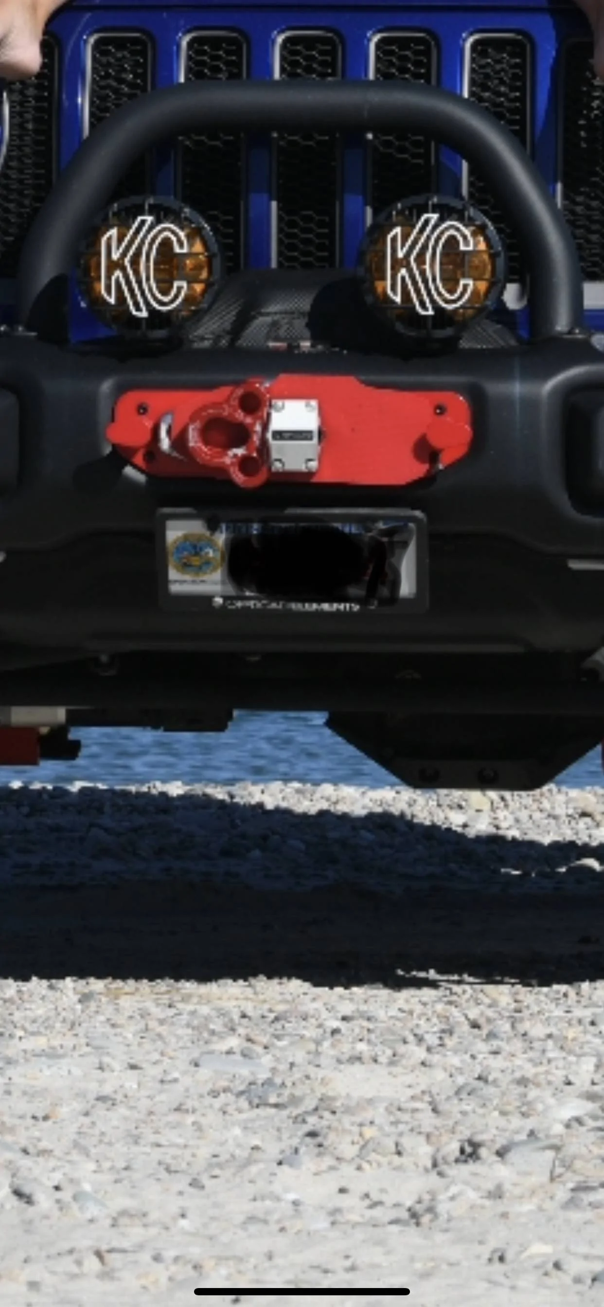

I have the winch cover. But where my winch is inside the factory bumper it still leaves an opening for the road salt/chemicals up here in the Northeast to go directly onto the drum/synthetic cable.

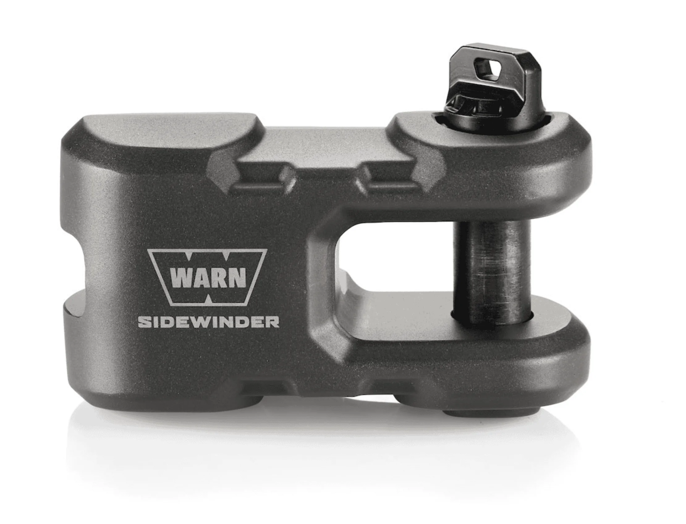

I use the Warn Sidewinder. I like that it protects the winch line end from branches and such poking at it. Also if using a tree saver, you could pull the pin and use it without a shackle if the need arrises. Same with winch points on trails.
Only downside is if you screw it all the way tight and put tension on it, you will need some pliers to get the pin loose. I just make a habit of tightening it and then backing it off ever so slightly and it doesn't bind up anymore.

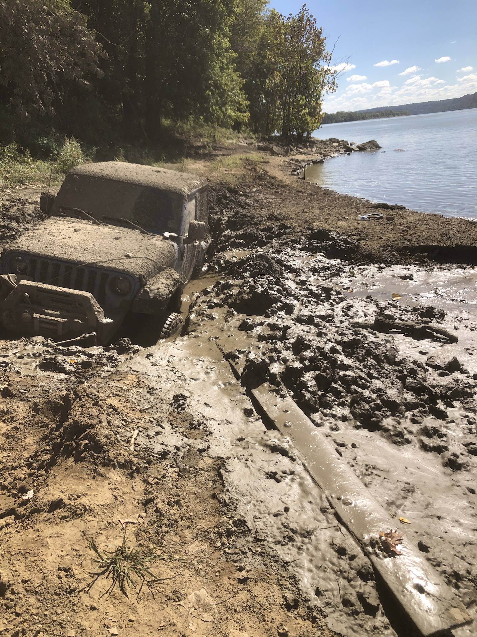

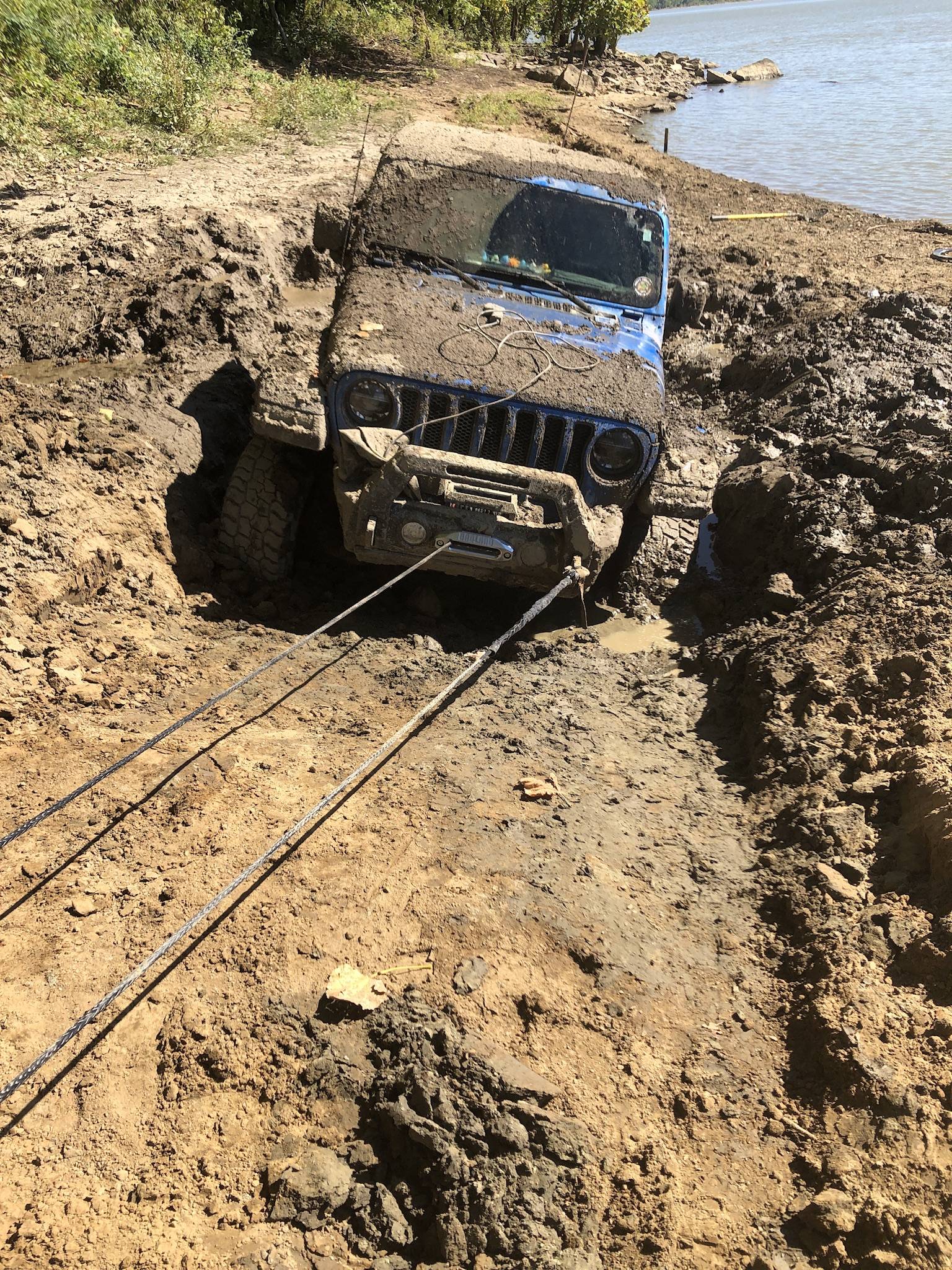

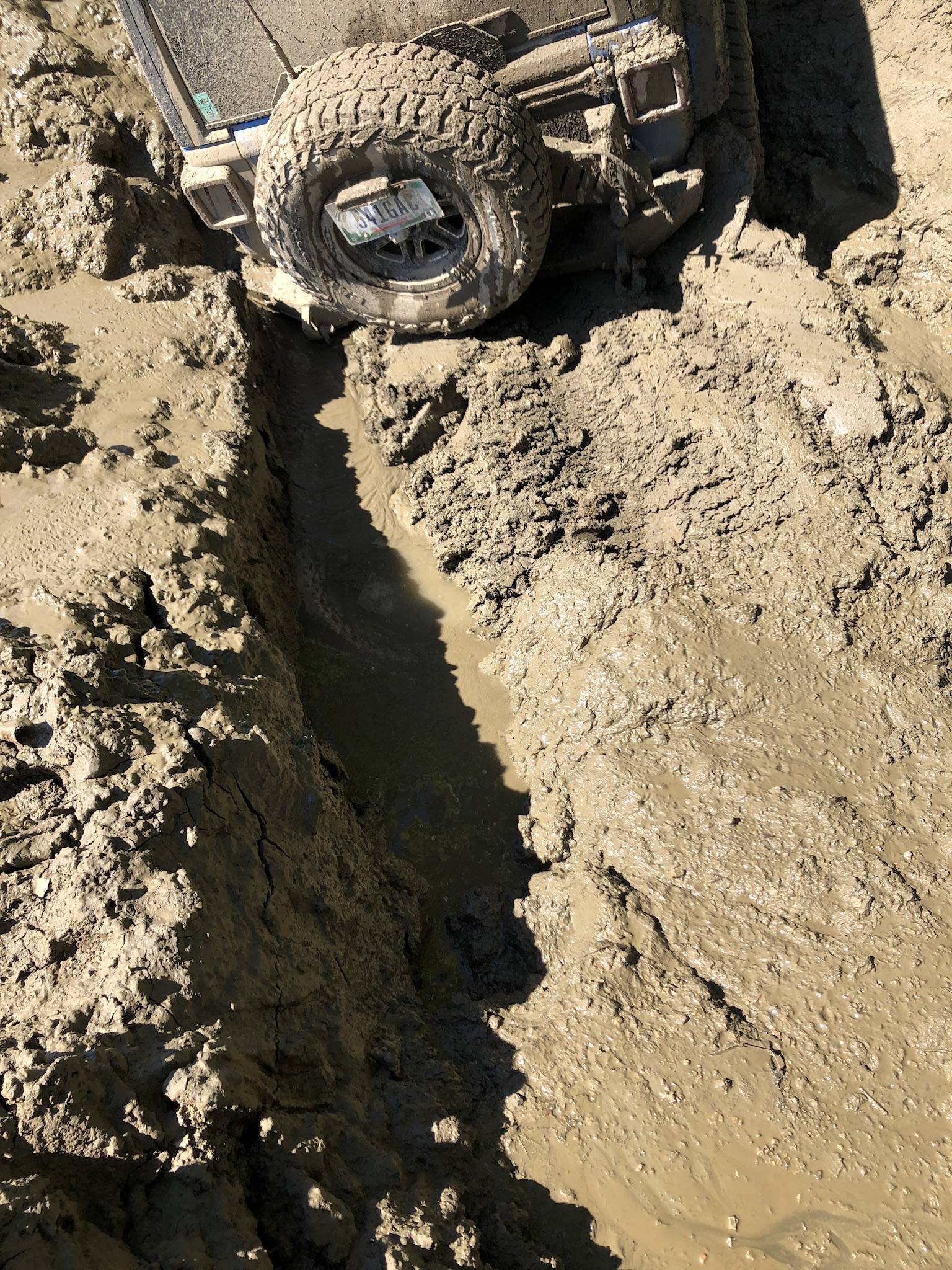

So nobody uses the standard hook..... ? I just left the standard hook on and I've used it multiple times. It is a hell of a lot safer than the tiny OEM recovery hooks. I dont see much wrong with it. Why spend money on something else?
i used it on this sunken ship right next to the Ohio River in quicksand and it worked just fine ?
