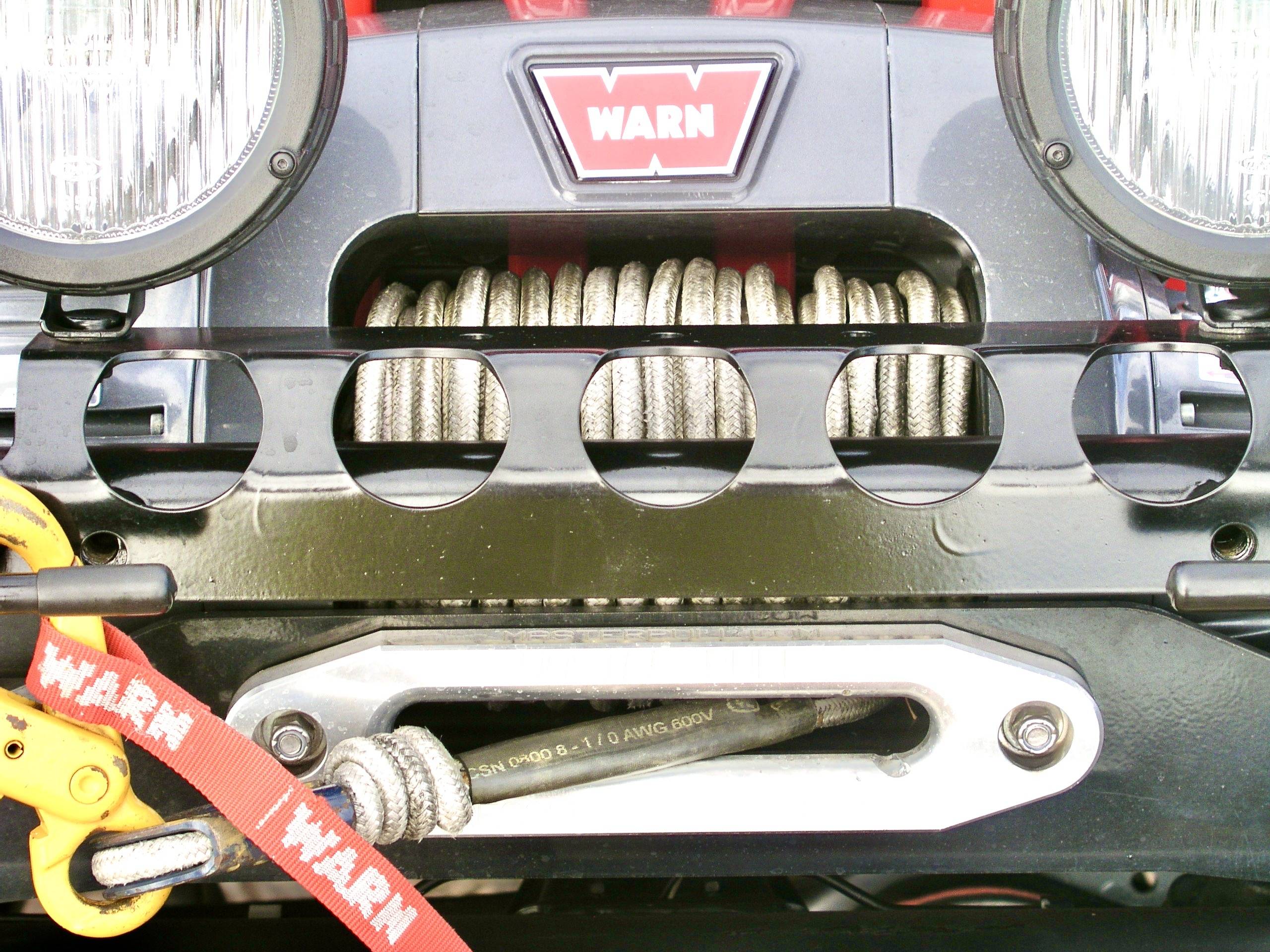

I run a Masterpull winch rope, full sheath on the rope and a 5 ft drum guard sheath. My rope is rated at 29,700 lb tensile, it has near-zero stretch so there is no snap back.
Been running this rope for 21 years and have sent it back to Master pull most years for inspection and repair. It started out at 100 Ft and its now down to about almost 80, the working end take a beating. Masterpull does not charge me for this service and they ship it back at their cost by the same manner in which it was shipped to them.
They make the best rope in the industry bar none! https://www.masterpull.com/superline-xd-industrial-winch-line-7-16-12mm/
This is it on my 12k Warn Powerplant winch, on my F 450 truck. On my 2 Jeeps I have the OEM Warn rope.
Historically lots of winches on Jeeps on trail runs, I have taken NOTE that no really wants to winch, so I guess most are for show. I am the trail run leader I am the only one to winch. Seen to much carnage due to somebody wanting to be the SAVIOR only they know nothing about winching, and doing it safely. Seen someone die, lost hands, fingers, leg below the knee.
Steel cable just say NO! Every injury, death or physical damage to the vehicle I have seen in my 40 years has come from a steel cable. 99% of the time due to operator stupidity, mistake or not understanding how to. The other 1% came from equipment failure, kinked steel cable, rusted steel cable, and overloaded steel cable.
ROPE is your friend.
Warn Powerplant 12k

I'm running the OE Warn 3/8"rope. When I wanted a 100ft extension, I researched the synthetic ropes and Samson Amsteel Blue SK-78 stood out as the standard for bulk rope. I found 7/16" for $2/ft and bought 100ft. It's gone up a bit, but this source is still a much better deal than buying "winch ropes" that are pre-terminated. Putting an end on a winch rope is too easy to pay several hundred dollars or more above the cost of rope.
https://sregear.com/products/samson-amsteel-blue-synthetic-rope

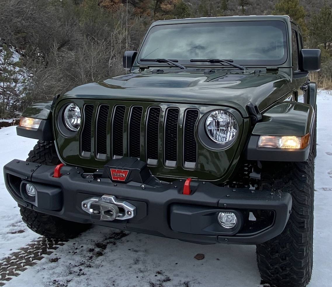

I currently have some kind of flat link copy of a Factor 55. After considering them all, none of them make any more sense than a brummel eye loop so you can run a soft shackle through it...
this is what I'm thinking too but it's blowing my mind a little and requiring a new way of thinking about recovery gear for me. I need some new skills.
Metal (shackles, hooks) would still be useful for various purposes after I've mostly switched over to soft shackles and winch rope eye. I just don't need them as much as my habits are telling me I do. The metal shackle advantage that occurs to me at the moment is when you need to attach a soft shackle or rope to something with sharp metal edges you don't trust not to abrade your rope. That wouldn't be ideal for metal shackles either, but recovery situations are...situations.
I only switched to synthetic cable a year ago when I sold my TJ with its winch. So many advantages to these new methods, and very few disadvantages.

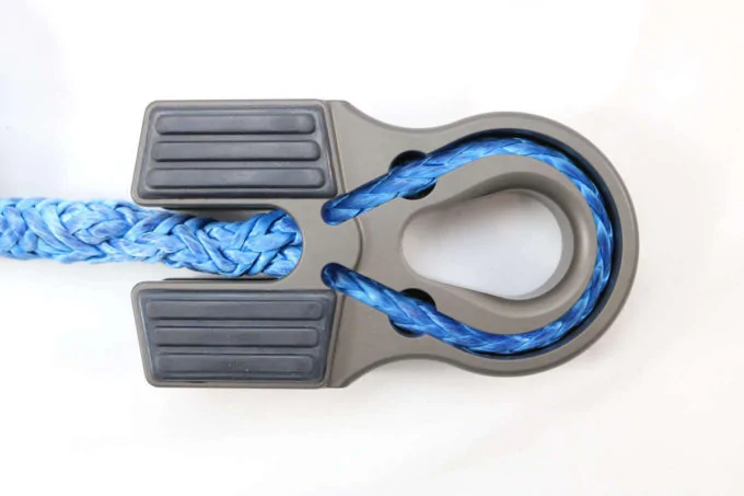

Just ordered the Yankem. No hook/thimble. Less energy flying around. Have run a hook for many years. I consider running No hook a game changer...
I agree on the advantages of no hook / no thimble but you can do that with any (synthetic ready) fairlead.
The purpose of the Yankum fairlead, as far as I can tell from their video, is to store your rope in a way that prevents it from bashing on rocks you bang the fairlead on. It's a good idea and makes me want to mill out (and polish) my thick fairlead.
Preventing that kind of damage is nothing new and not specific to using a rope eye with no hook.
And there are other easy, safe ways to store a rope eye while wheeling.

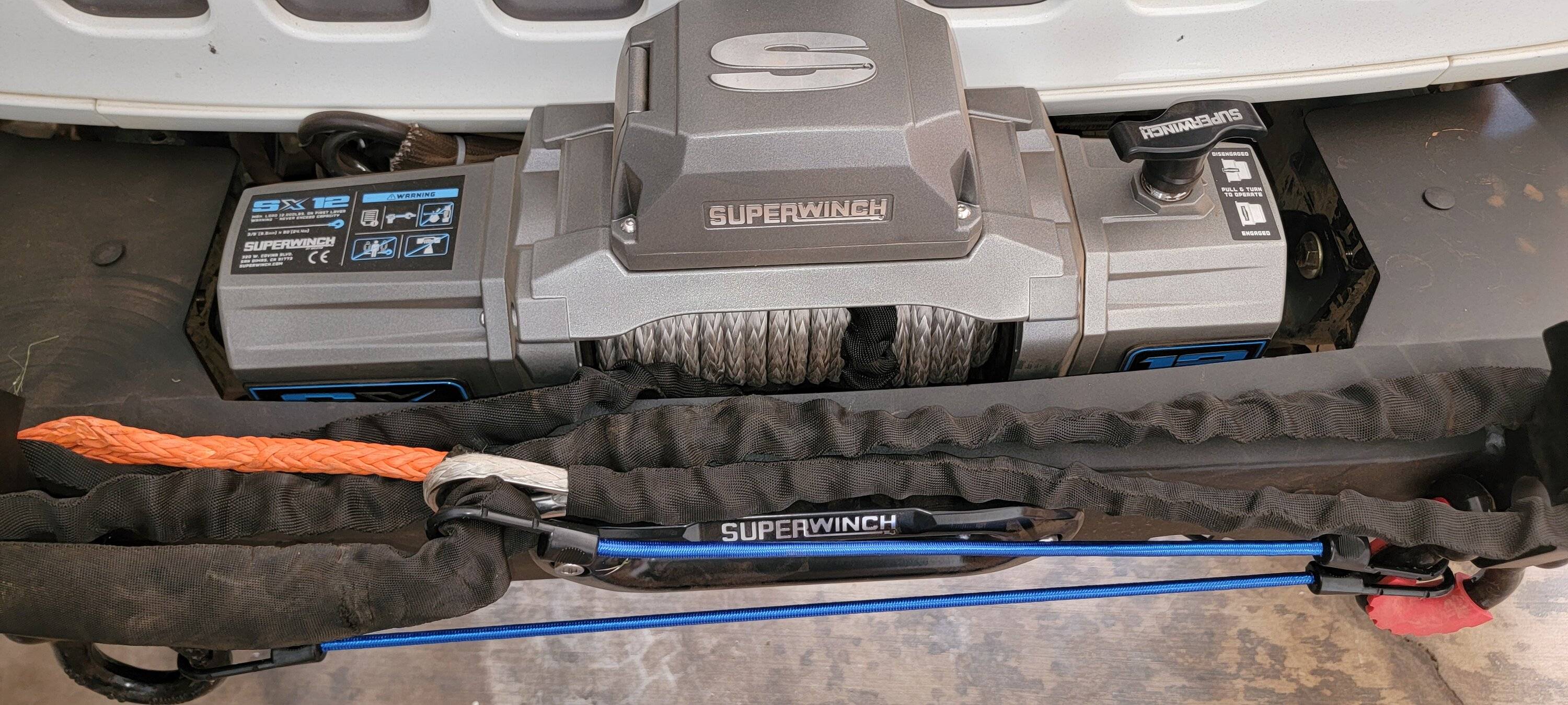

I run a soft shackle at the end of mine; less weight to kill me if my line snaps...
I do the same. The soft shackle I use is a well used one I found on the trail. Since it’s constantly exposed to the elements I won’t use it for actual winching, I have another 4 or 5 fresh ones I can use.
I attended an off-road recovery class and they were big proponents of eliminating as much metal as possible. They are also fans of roller fair leads, even for synthetic rope, because it reduces friction on the rope.
This is how I do it:
Jeep Wrangler JL Which winch hook/shackle do you guys recommend. 2023-01-24 11.01.50
It only takes a few seconds to fish it through the hawse fairlead. Jeep is a dedicated crawler and stays in the garage when not wheeling. OCD is forcing me to wrap the exposed rope with tape to protect it from the intense Hawaii UV's. The Yankum fairlead is cool, not sure it's worth replacing my system.
