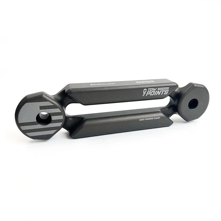

I went with this ridiculously overpriced fairlead:
https://yankum.com/products/winch-hawse-groove-fairlead
so I can just run a Brummel splice at the end of the rope, no metal. At least I'm recovering some of the cost by not buying a hook, I suppose. Tucks up nicely behind my Cascadia Designs hinged front license plate mount.
Can't report on durability, though, since I haven't used it for anything yet besides dragging a log across the yard. But if it breaks in the field you can just splice a new loop in a few minutes.
I bought the same. It works really well with my the setup I have to hide the winch inside my plastic bumper.
