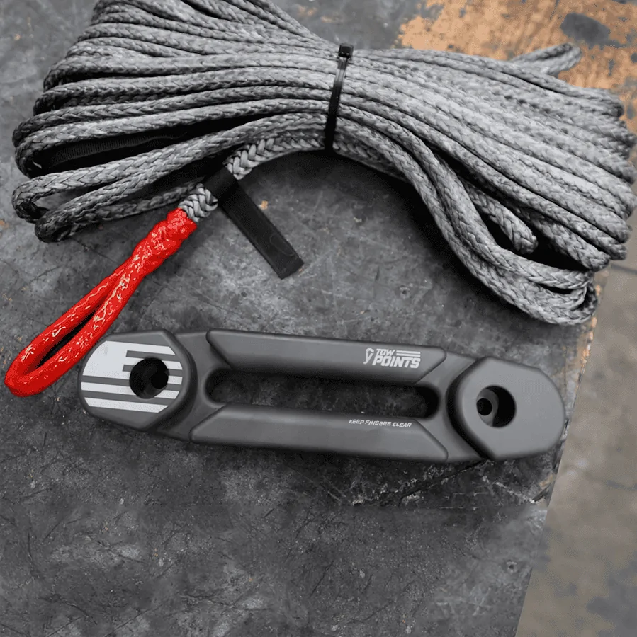

That makes sense about the UV issue. Only thing I’d say to that is the only heavily exposed part is the knot itself since my winch is enclosed in my bumper. But I could still see some light getting in.
I have seen this fairlead from Dirt Lifestyle that’s built to hold your winch line end by itself. Looks cool but I felt the soft shackle by itself was just as efficient.
