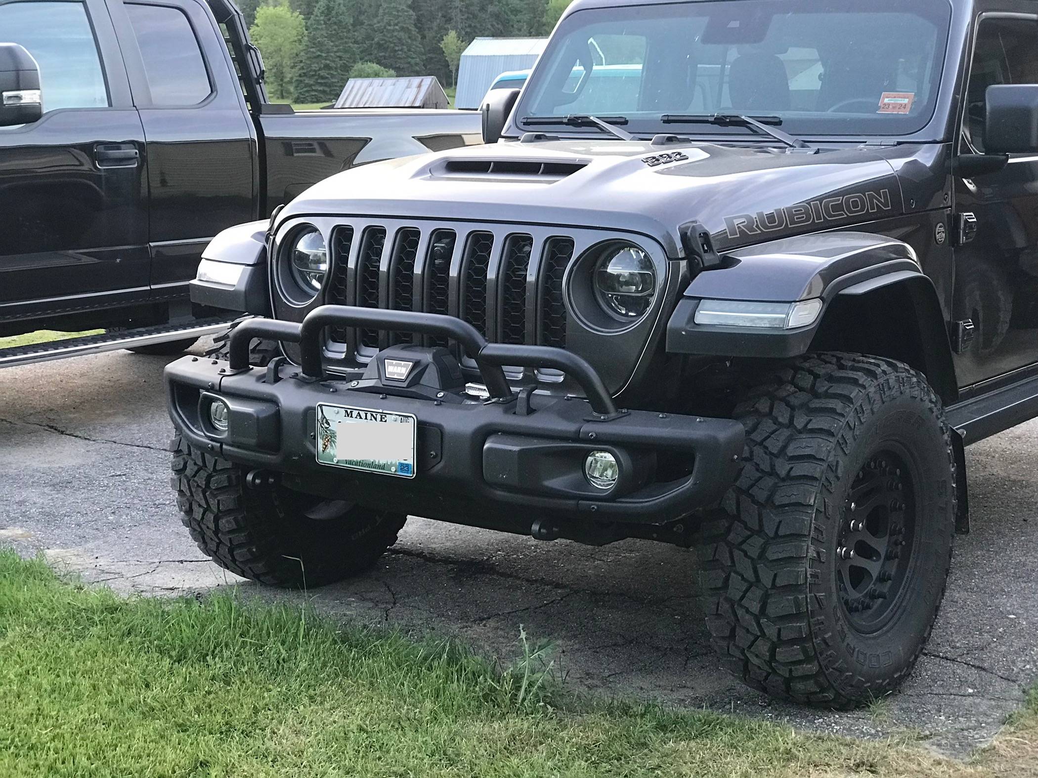

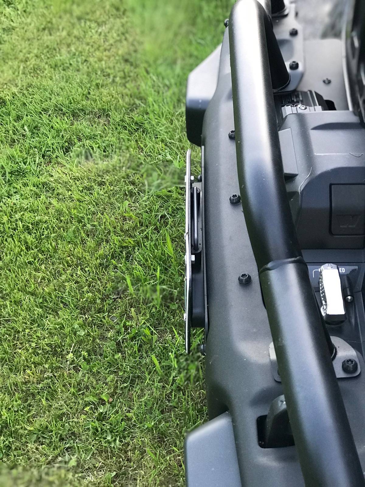

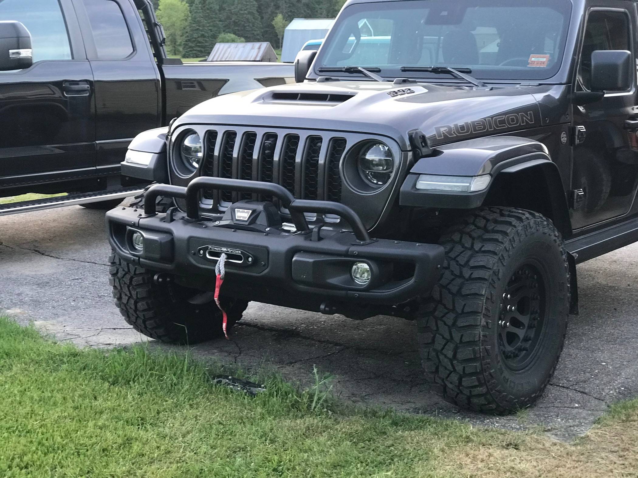

no hooks or ferrules for me, just a loop and soft shackles. Maine requires a front plate so I built a quick release for my license plate and running with out a hook I can tuck the rope back through the fairlead and keep everything nice a clean looking, have the same setup on my 24 two door. My JK has a winch on the front and rear but no hooks on any of them, never miss them either.

this looks super clean! Congrats!

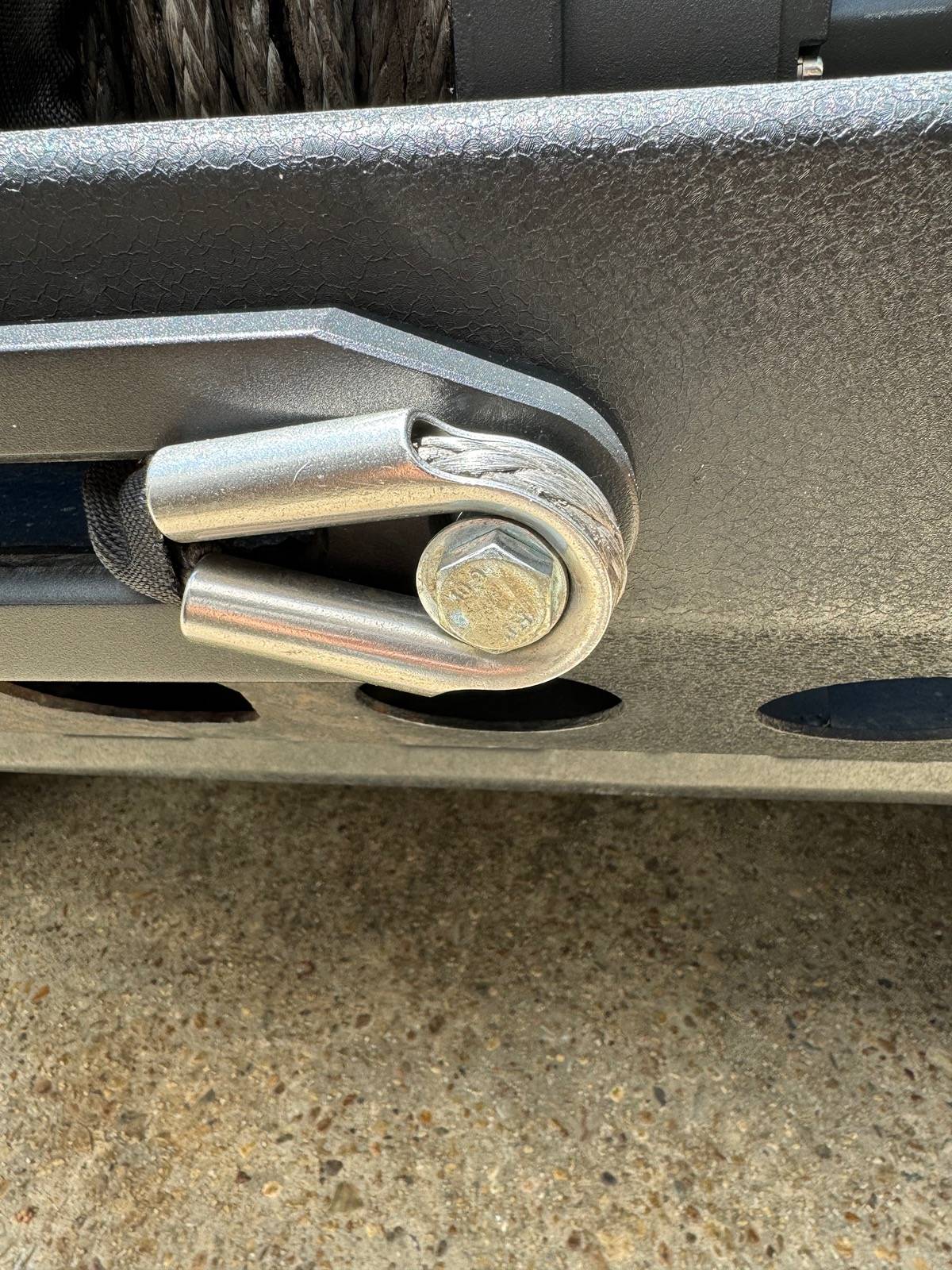

Here’s my no-hook set up = a longer bolt, a sleeve, and a washer.
+ a soft shackle when winching
Smart, VERY SMART. I don't soft shackles but if did I would do it the way you have done and recommend to that LLANERO has done it correctly.

Thx old Jeeper. If you don’t like soft shackles, you can use a d-ring with the same setup.
