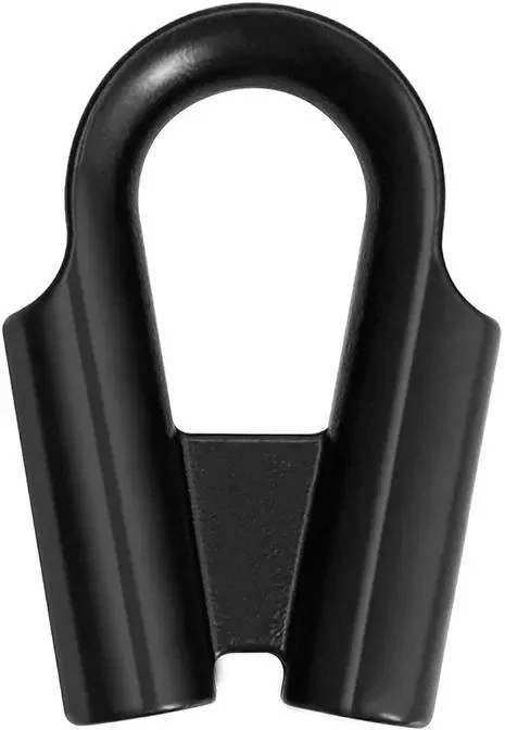

Here is my set up: WInch Thimble, 26,000 lb rated rope and a big D ring. If I am pulling I am pulling LARGE out of rivers, Pritchett Canyon, Jeep the went over a cliff (and landed upright, not to much damage) but it was difficult pull as the drop was about 20-25 ft. I have saved a lot of Jeepers on some gnarly trails.
This is the original Winch Thimble, Patented.

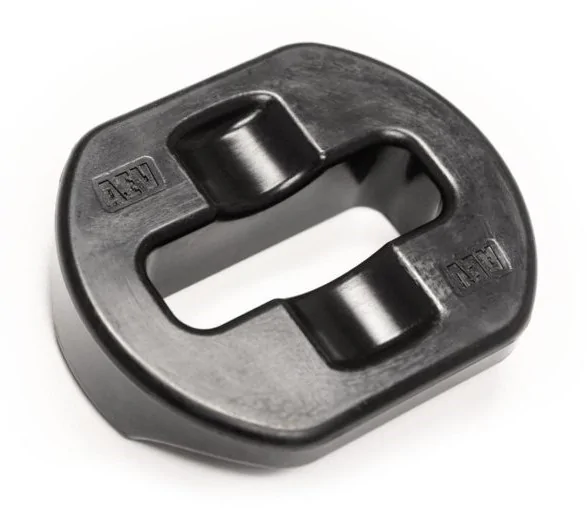

I run the standard Warn hook...
Jeep Wrangler JL Which winch hook/shackle do you guys recommend. 1000002787
with an AEV isolator to protect the fairlead/hold the hook tight against the vehicle..

to quickly/easily remove the hook for a closed system using a soft shackle through the standard Warn rope thimble...

The metal weight of the thimble is sub-optimal during a recovery, but I like the protection it provides the rope loop and the bend radius it creates on the soft shackle.
