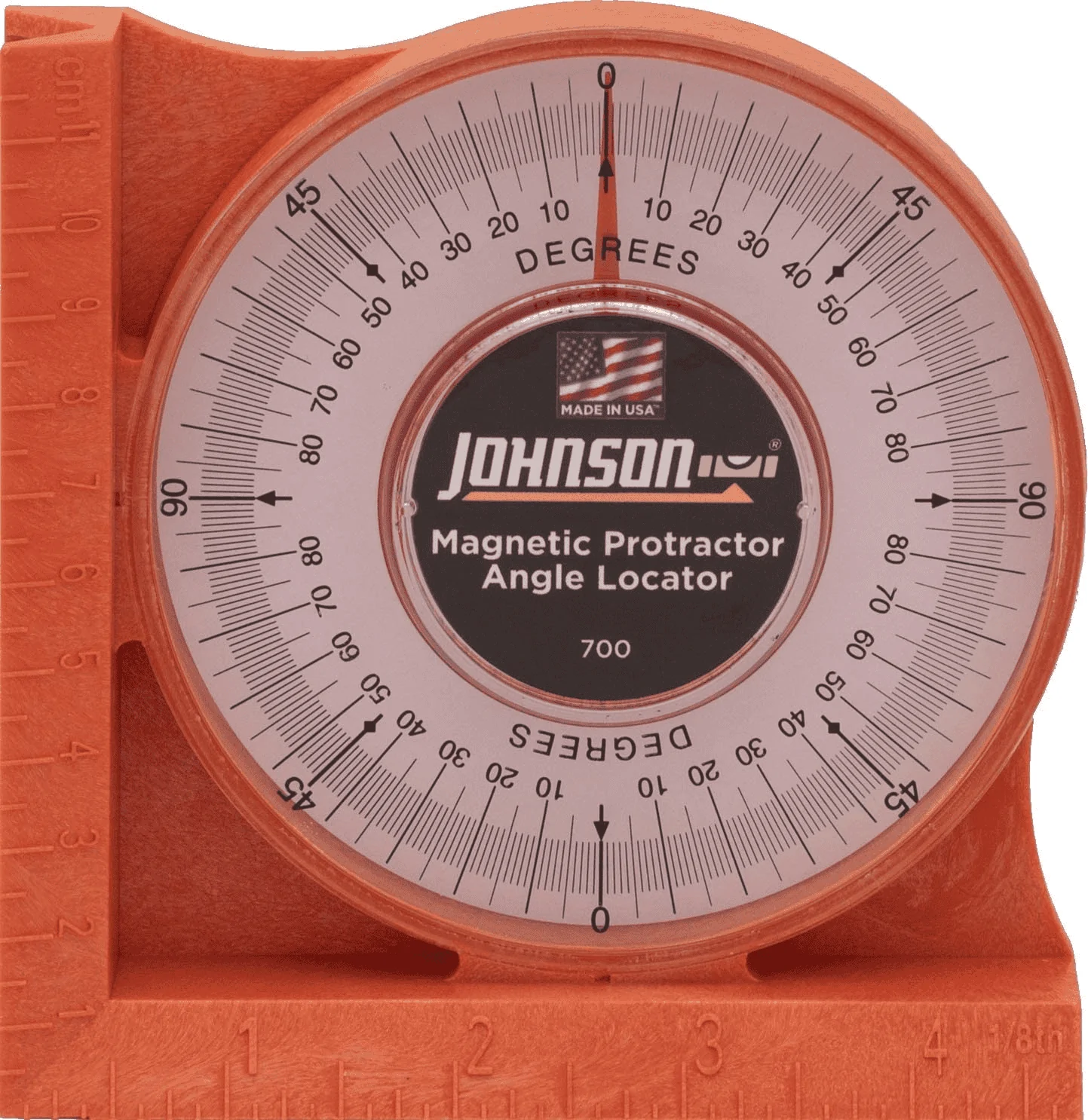

Typically caster will be around 4 for stock Rubicons, around 5 for a stock Sahara and a bit higher, maybe 5.5 for stock sports. You may be on the low end for a Sahara so you may have more wander than what is typical. They have bubble gauges on amazon that you can get a fairly accurate caster reading with. If your caster is 5 or less those longer Mopar lift LCAs will help a lot w/ your steering if it's a caster issue.
https://www.amazon.com/Johnson-Level-Tool-700-Magnetic/dp/B00004T807/
Hey Blnewt,
Where's your preferred spot on the axle to place this protractor? (Just ordered one)
Thanks! ?
