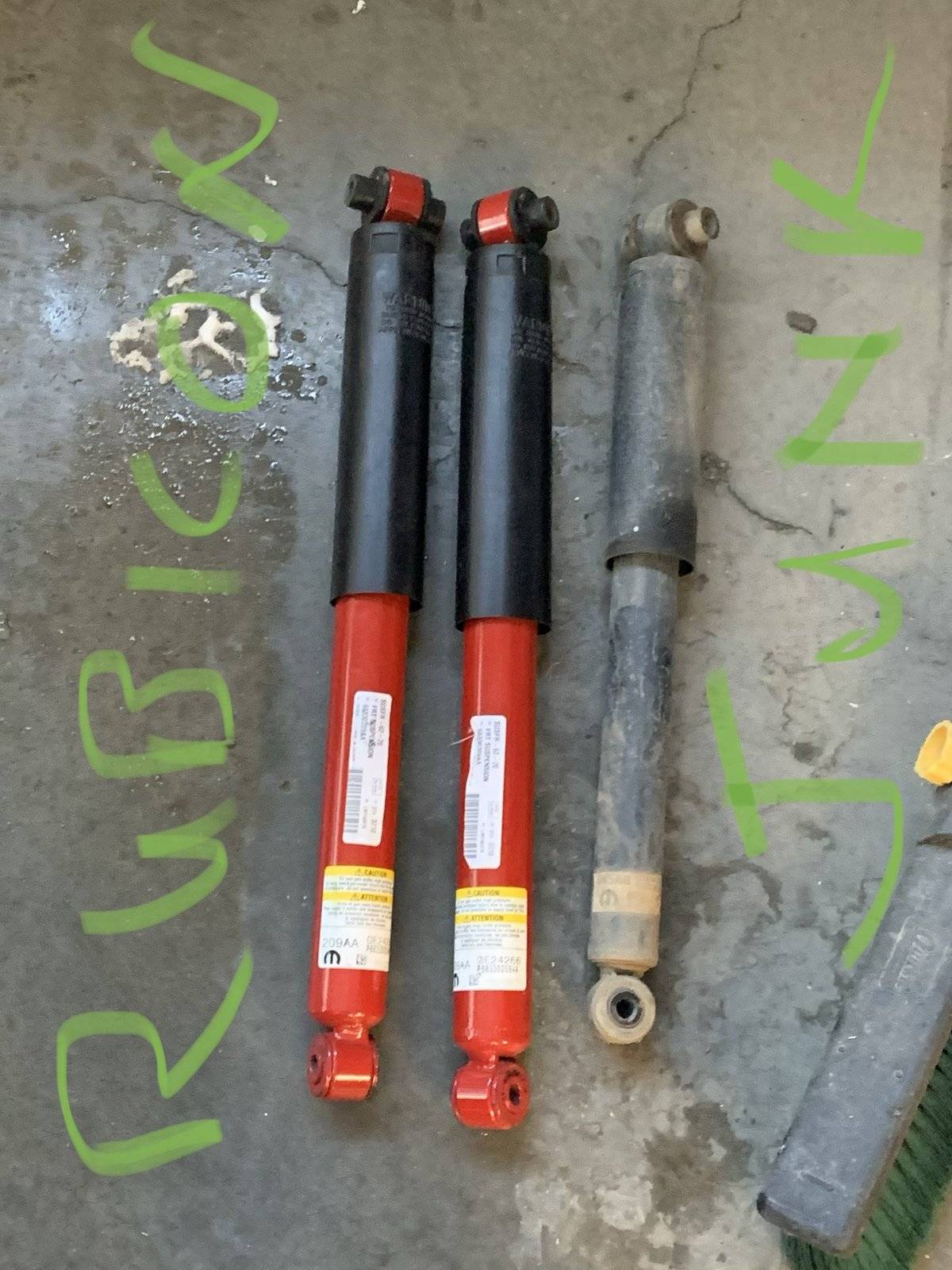

Rubicon vs sport s shock
Yes there is no argument that Rubicon shocks are longer for more flex, especially the front, because of the disconnects. They always have been even in the JKs. That means nothing for ride height.

I don't have the pics but I know for a fact my Rubi set was taller.

There’s tons of threads on here showing the springs and shocks from Rubi are longer then all other models. I can personally tell you my Sport S lifted almost 4”s with the Mopar 2” lift springs.
