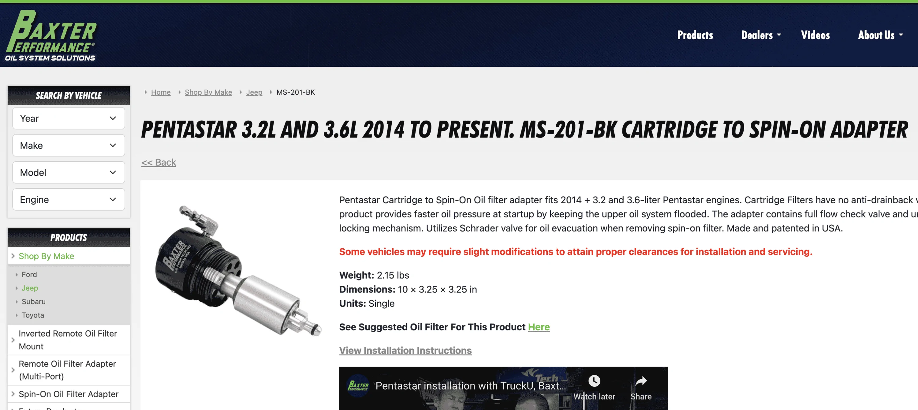

This thread derailed pretty bad ? I will help OP with an idea!
So for me (i am going to become a 3.6 V6 owner soon if all goes as planned) it looks like the number one thing this engine needs is proper lubrication
Others have chimed in about the oil change interval but i do not think that is the problem.. I
I think the issue is that this engine dumbs the oil back into the pan every time you turn it off
Which is why they make the following mod to stop it from doing that!
Jeep Wrangler JL Maximize 3.6 Reliability 1687558220821
To me this would probably be my first mod to keep the engine lubricated 100% of the time
