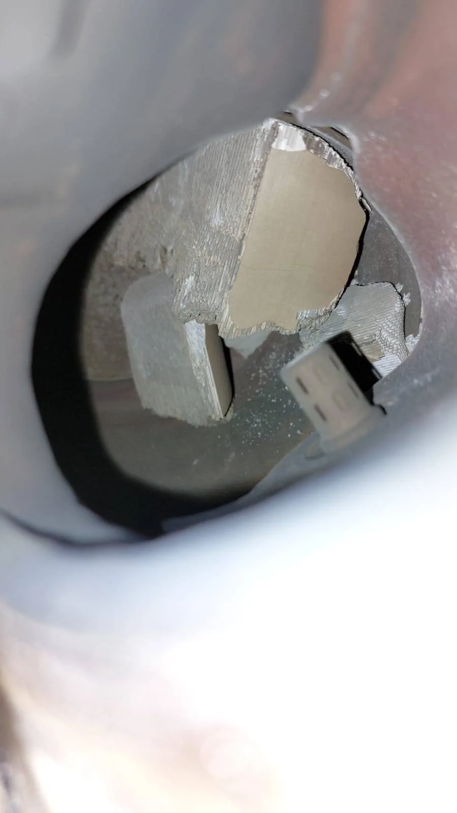

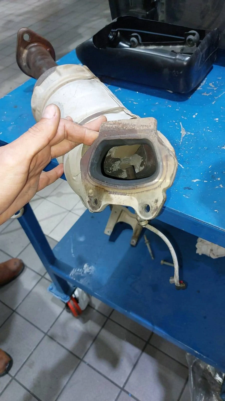

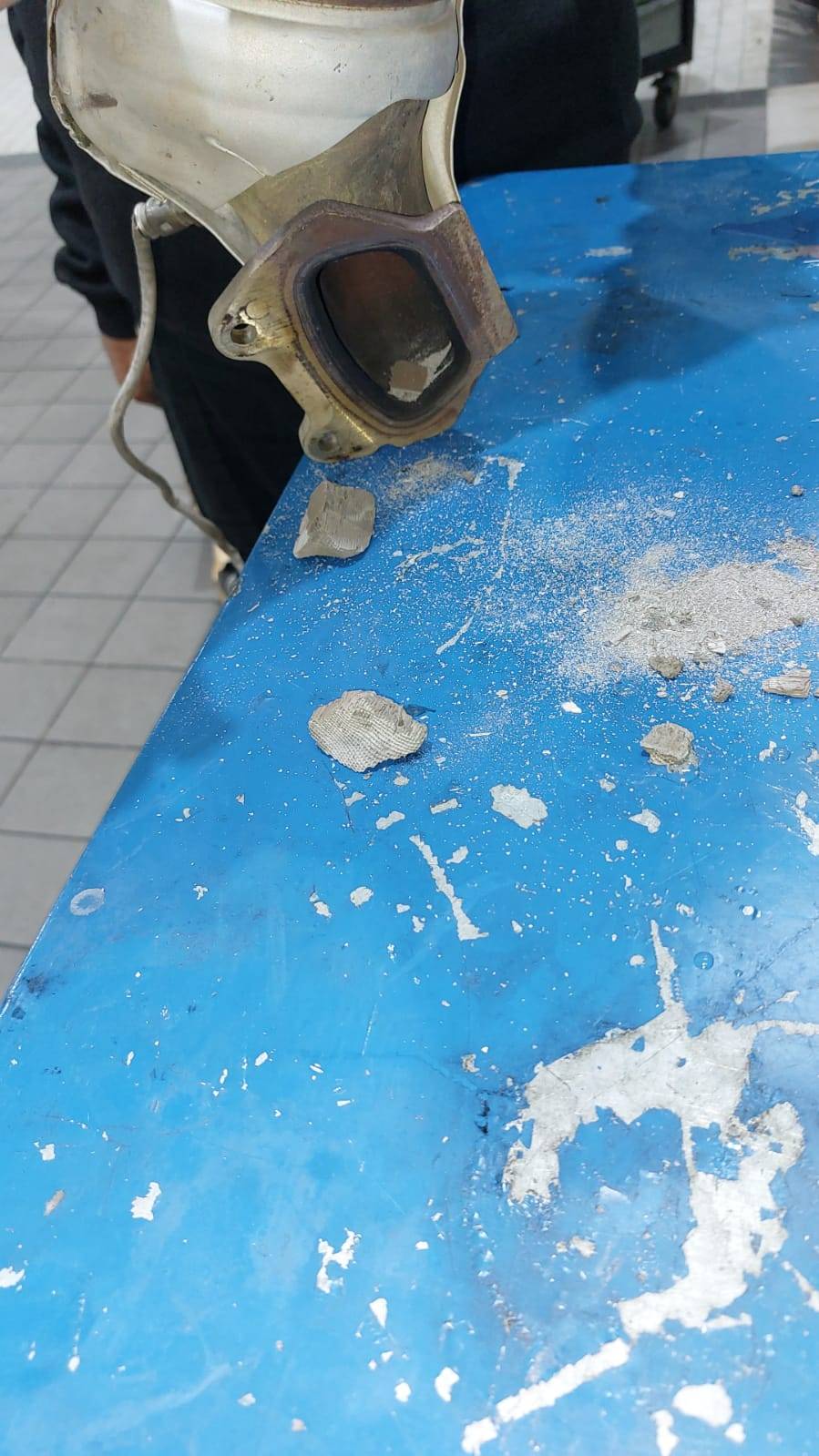

Hello everyone
I received pictures today from the service center.
According to them, this is what caused the engine to malfunction
Do you think that makes sense?
