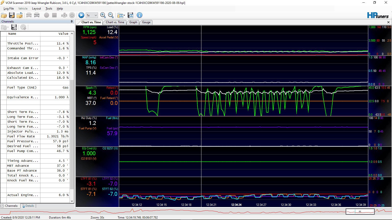

I just took the first log, so all my channels weren't setup correctly. However, I think I see the problem with the light throttle surging. The spark timing is bouncing back and forth between about 40 deg and 0 deg. Look at the 3rd chart from the top, green trace. I suspect the spark source is switching back and forth between two sources with a very different idea of what the spark timing should be for the given conditions. Further investigation is required.

Curious why both LTFT are negative. If the computer is learning correctly, LTFT should be 0%. So, the computer is trying to lean out the motor. Did you recently disconnect the batteries or reset something?
No, didn't disconnect the battery and haven't done anything to the PCM other than read it, and log data. It's been my experience with some Ford PCMs that the LTFT vary as they update when running open loop. I haven't logged enough on this PCM yet to know how the fuel trims operate.
Gotcha. I haven’t done any logging on a PCM in a number of years. In my tuning days, we knew when we were getting a bigger set of injectors on a “street tune” close when the LTFT would approach 0%.
Keep it up on logging, I’m interested in seeing what you can find out about these PCMs.
