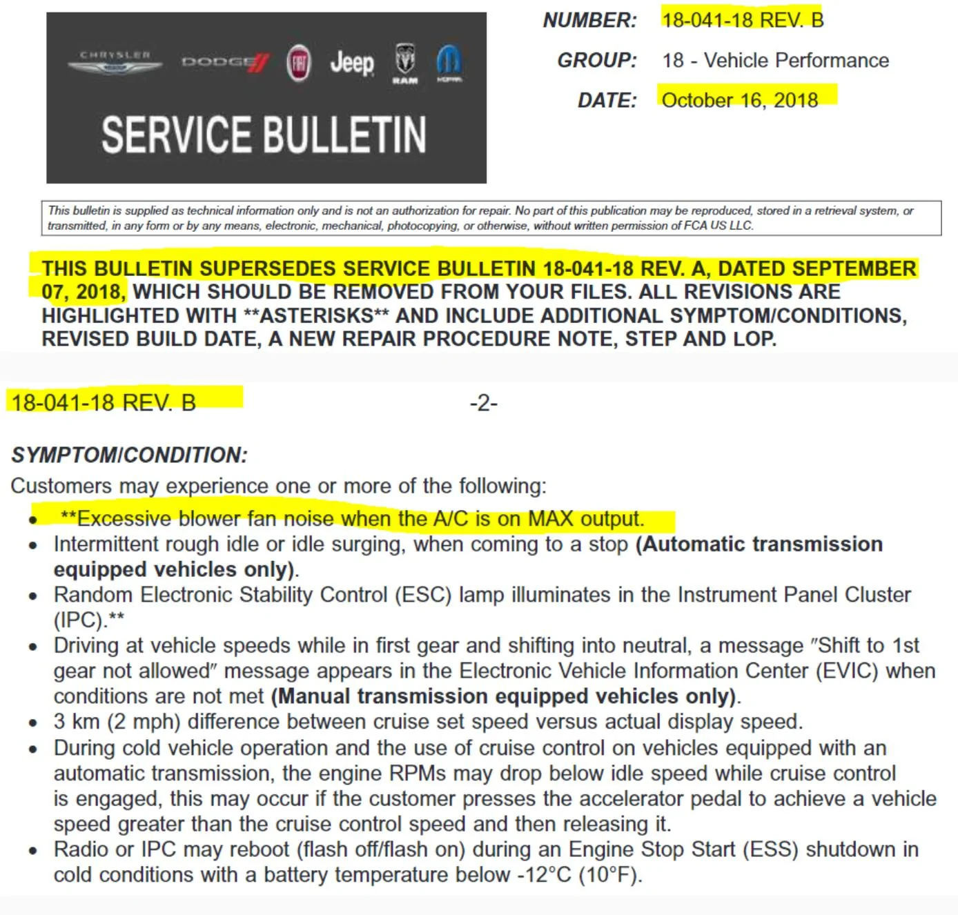

My 2018 JLU is doing this now. Hesitation/pulsating at idle. Drives me crazy, I installed a pedal commander and no difference :{
Talk to your Service Dept. and ask that they do this TSB. Cured my JL and other's with JL's on the forum that had idle issue, loud fan, etc..
You will need to tell them your JL, has the symptoms mentioned in the TSB or they probably will not do the update to your JL.
There is a big chance this PCM update will remedy your JL's issues.
Is your 2018 JL an automatic.. and no, Pedal Commander is a terrific addition to the JL, withthe 8 speed tranny but no it will not cure the idle problem you are seeing.
DO remove the PC before you go to the dealership. Do not mention the PC to the dealer.
