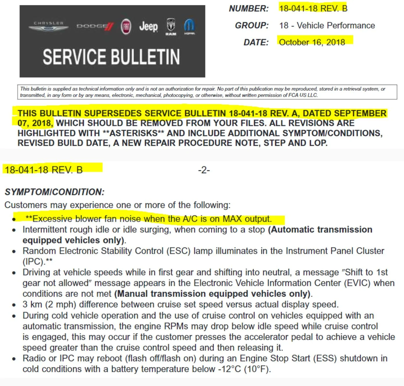

You were having the same steady state throttle issues and this reflash resolved it?
DanFelix
Dec 22, 2018
30
327
152
Riverside, CA
2018 Wrangler JL Sport S, 3.6l
I would not describe mine as steady. It was intermittent, only with A/C on, and never while moving. It occurred at stops. The flash stopped it. My VIN was included in the applicable vehicles.
