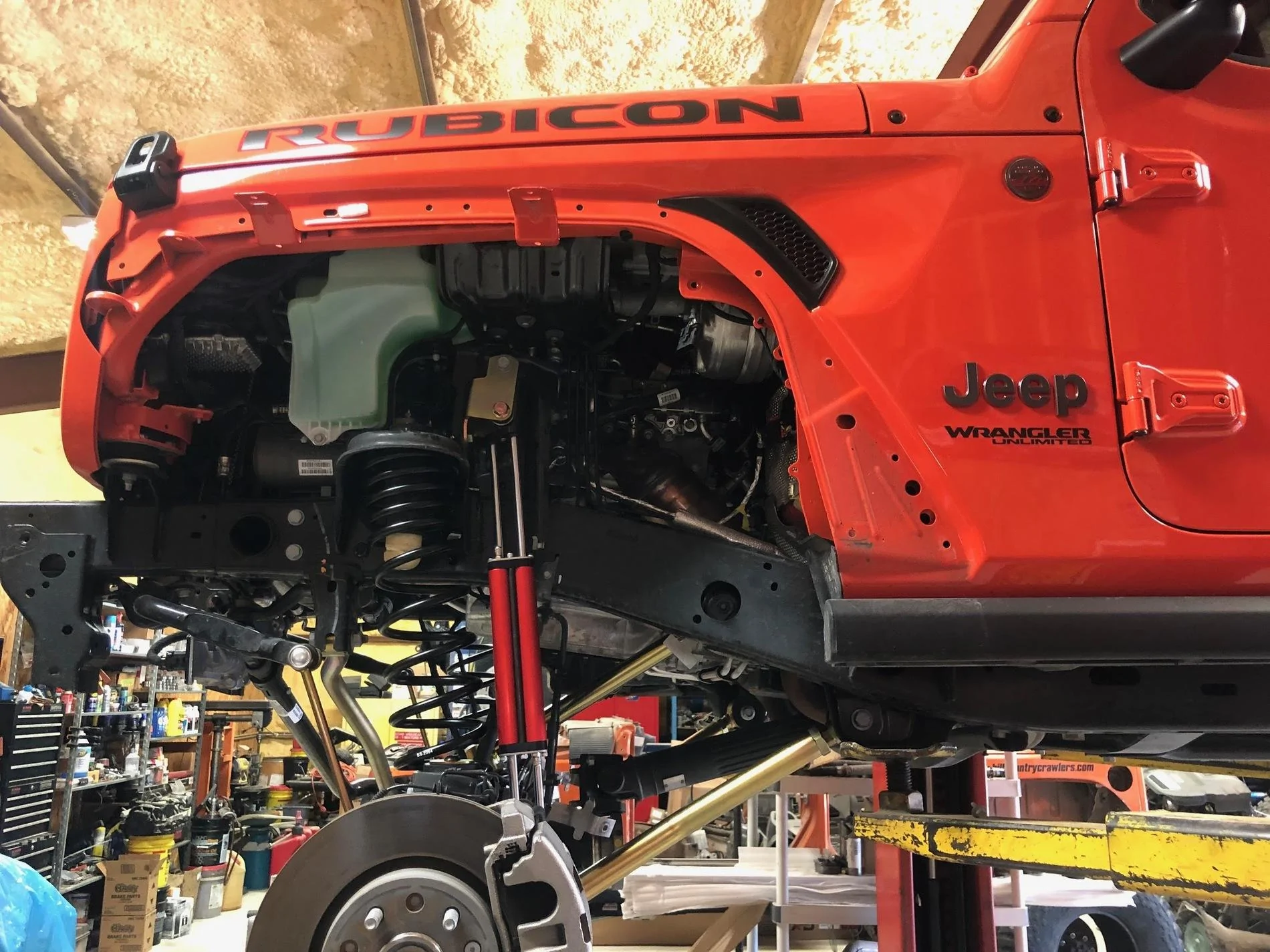

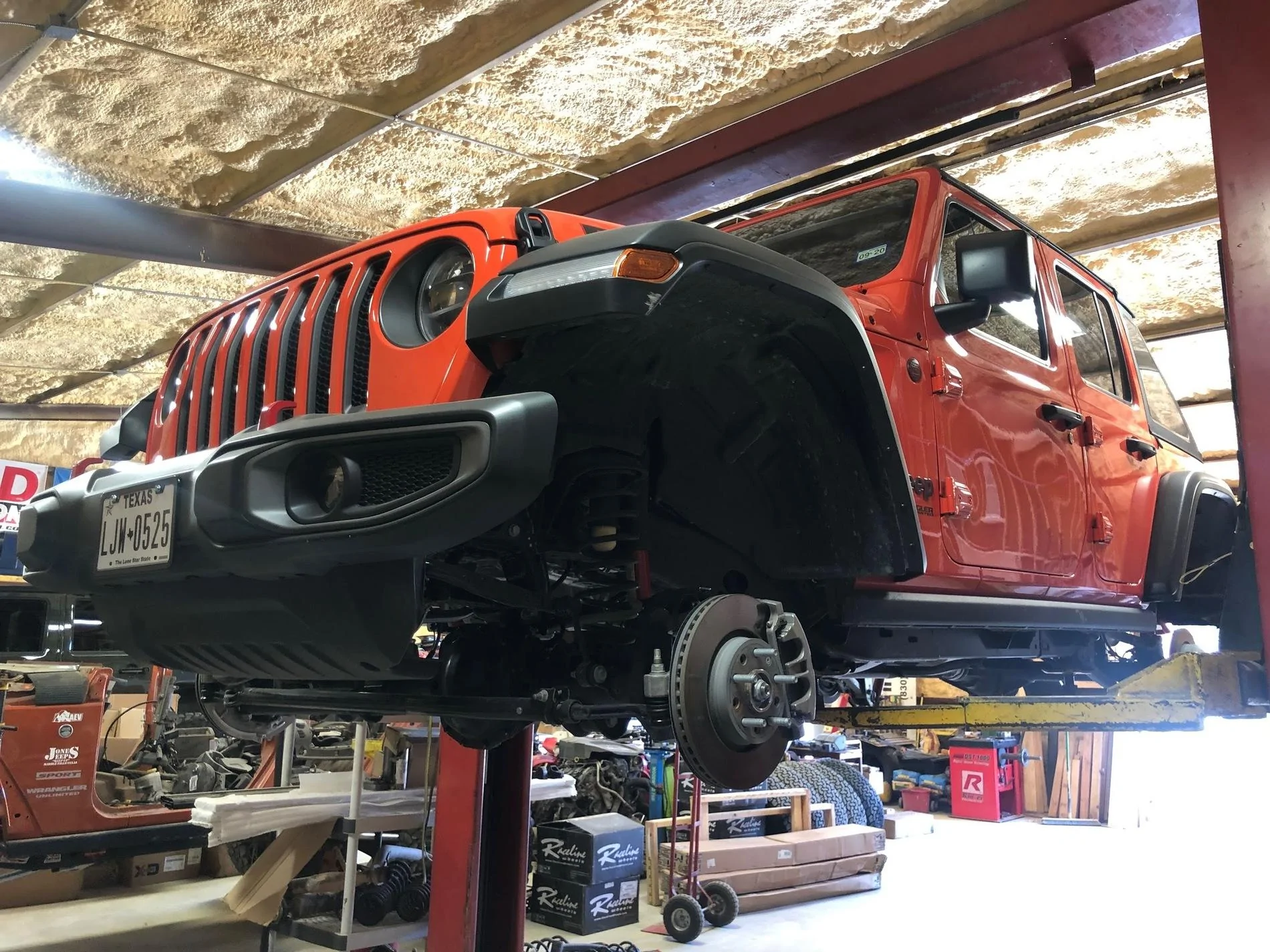

    Suspension getting done:

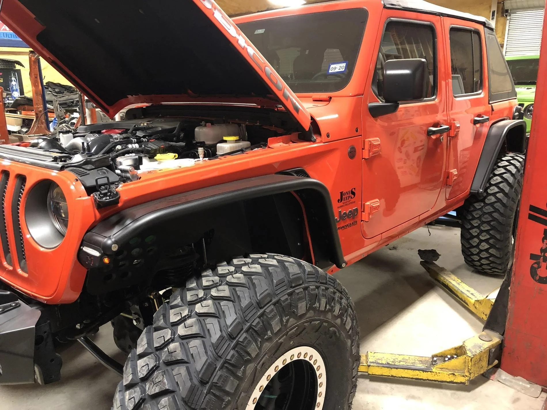

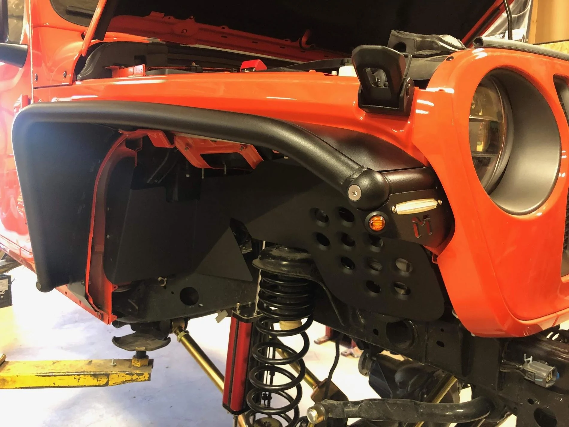

    MetalCloak Overland Fender:
    DZRlDEM62wPUip_4suQloBtocrmx-eXbhwuHPSo-I2JEqEFByFPJhGsniiduCg4_rTyJlZmYl9r1RXX96DD7X6nghQ=w2400.jpg
    I love the fender, but I think the LED's don't have enough draw, because they both come up as "Front Turn Signal's Not Working" every time I start up, even though they are in fact...working...

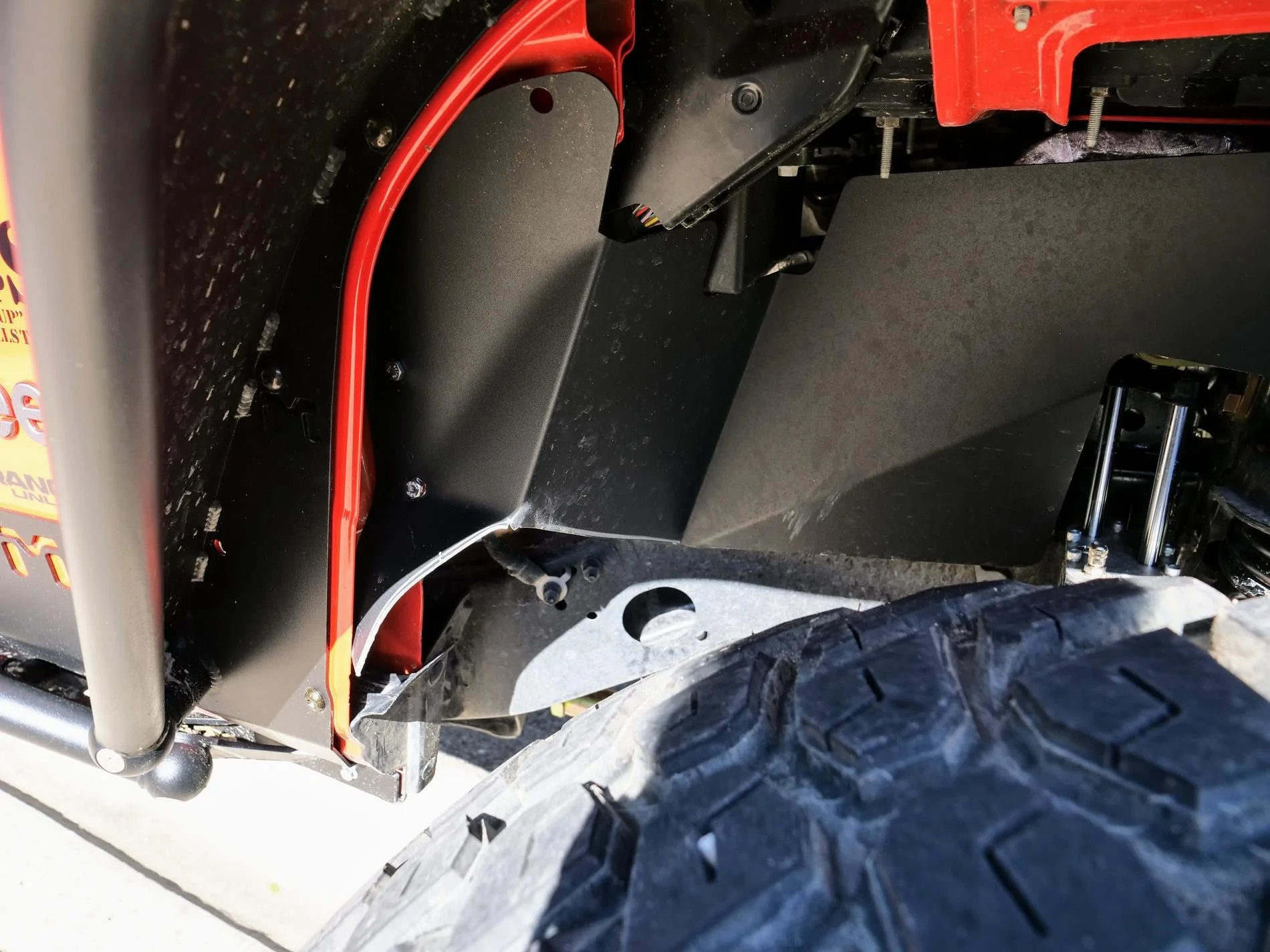

    Good look at the Ace Inner Fenders, I love them, however I'd offer one suggestion to them, illustrated by the following picture to this one.
    DGpt1Uxthih_oENMECBJa72p9JXj3XcWCn8nBQAZUnLEle5eY0UwMcbkBOmrtuzxbU6OWRa5s60hmpyhlzht1HWA3A=w2400.jpg
    6hUEtUCYtQBD_BsVIeFELzIcXjl4zi1OOCEFf9OQ2z9h0L9fLDRX-VhIYFVnPHvFQkk0J2R0XyXEXhRDRBEWokw2ag=w2400.jpg
    We had cut-back the inner fenders because there was not enough clearance for the 40's, but even with the cut back, I still got into the inner fender and pushed it up, going to have to cut it back a little further before the next time I go wheeling. Still a big proponent of ACE.

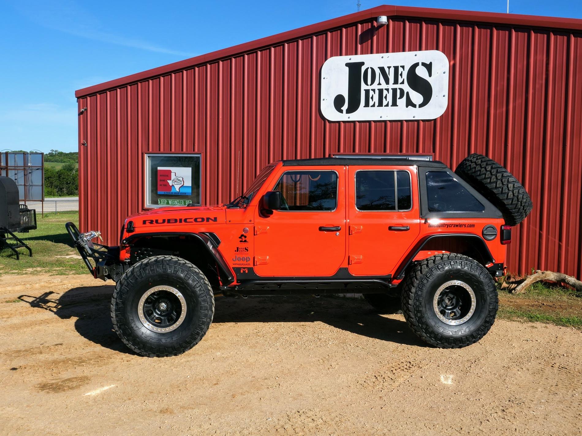

    As it sits today:
    9FJTAmTNv0irFifSiEULI07Zs3dIw42EjTmLwDVJ-5Nf3iSgASWBQdrCkuTzqhNBmcNkrfhv3TPoqil8IABIVMPTLw=w2400.jpg
    -TyUvx4KafZjETWEI3Ufvi-jdfdIuRRmT_PE90eeaYjLQkv9a5vXTjqHc2Ybfy1f6T0V2JS4zkiJRvCjYpBgNqAM-g=w2400.jpg
    Doing what it should be doing:
    W-e4hxyIzYogcfbbzKq0JVOKuqNYawArmGYEqAmKDJV37ZeeMfCkoVv4Mst0t4gQ-qN2Z98A0XE2j4ZwgHu9ZO5viQ=w2400.jpg
    And that's a little video of it for the first time taking to the trail. Like anyone, I went immediately to one of the harder trails at Hidden Falls, Loose Rock (There are a few tip overs and rolls every year on the trail) to see if we could get it done. Video is synced and spliced from a few cameras, and yes, we got past the intro, when someone else had a Jeep break on the trail. It was repaired at a 35-37 degree angle (I was impressed) but it took a few hours, so the ride up was completed at night.
    Biggest issue that night (got way better the next day as I was learning the throttle) was the delay between hitting the gas, and having it go with the turbo charger, not a fan of that lag. I'd hit it, and it would a split second to a second before it would engage. My belief is that the i-Drive Throttle Controller will help eliminate that. I did get better the next day with more seat time, but we'll see going forward.
