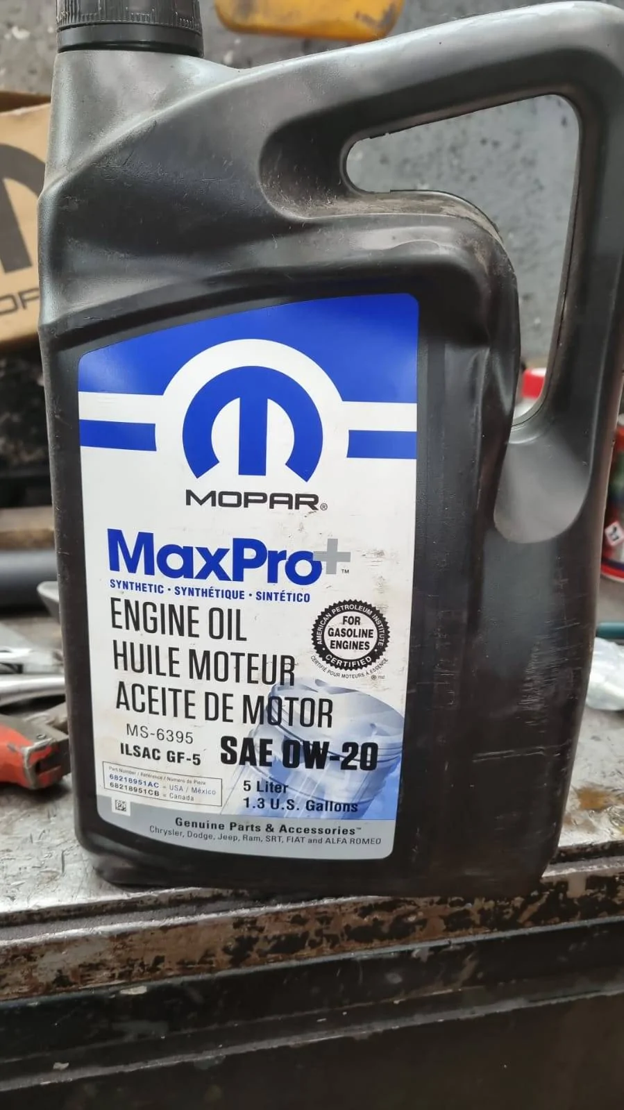

Since warranty is a key issue here, I'd stick with what is specified, which is 0w20. A good 0w20, Like Mobil 1 EP, will have a higher flash point than even their 5w30, thanks to a higher PAO content, so hot weather is not an issue for it. Any big brand 0w20 is going to be a very good oil. With bulk dealer oil, you don't know the weight or quality. I've read horror stories of low quality bulk oil used by shops and even dealers here, so I wouldn't be shocked to see that in Israel or other parts of the world, too.
I don't think 5w30 weigt would do any harm at all, and actually may have some benefit in certain driving profiles, but it could be used as the basis to deny a warranty claim, as nowhere in the manual does it make an allowance for it. (btw, Mobil 1 EP 0w20 has a higher flash point than Mobil 1 EP 5w30).
Using that Mopar oil would also certainly protect your warranty. Keep receipts and evidence of your oil changes, as well.
We here must keep in mind that laws may be different in Israel in regard to warranties and maintaining them. So you'll have to see if we suggest something that you cannot do there. In the US, it is pretty hard for a manufacturer to deny warranty coverage for something like changing your own oil. But again, keeping records is a big part of it.
Btw, I'm betting that Mopar oil is supplied by Pennzoil. Since FCA became Stellantis, it might now even be a Mobil 1 or Exxon Mobil product. Hard to tell, but whatever it is, it will be very good oil and it will meet the design requirements of that engine. It is probably not cheap, though!

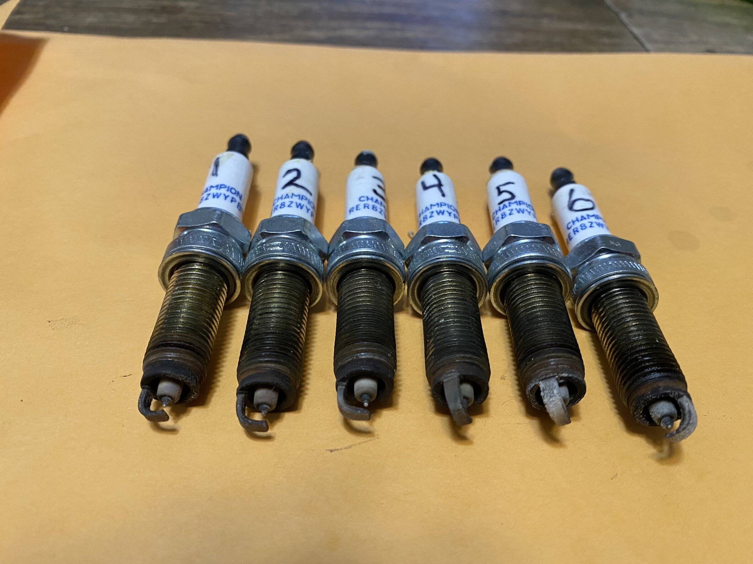

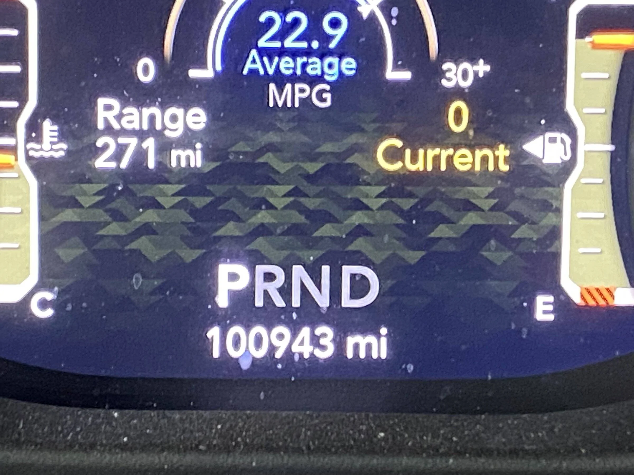

'20 jlr 3.6 recently turned over 100K miles. 0 problems. Maintenance schedule calls for new plugs (along with a lot of other checks). It is interesting to look at the wear and burn on the plugs. They are worn out but the burn looks OK and there was no deterioration in mileage or performance. This engine,trans combination is outstanding. There is no maintenance schedule for the transmission fluid or filter. It is considered "lifetime" (will do at 150K).
