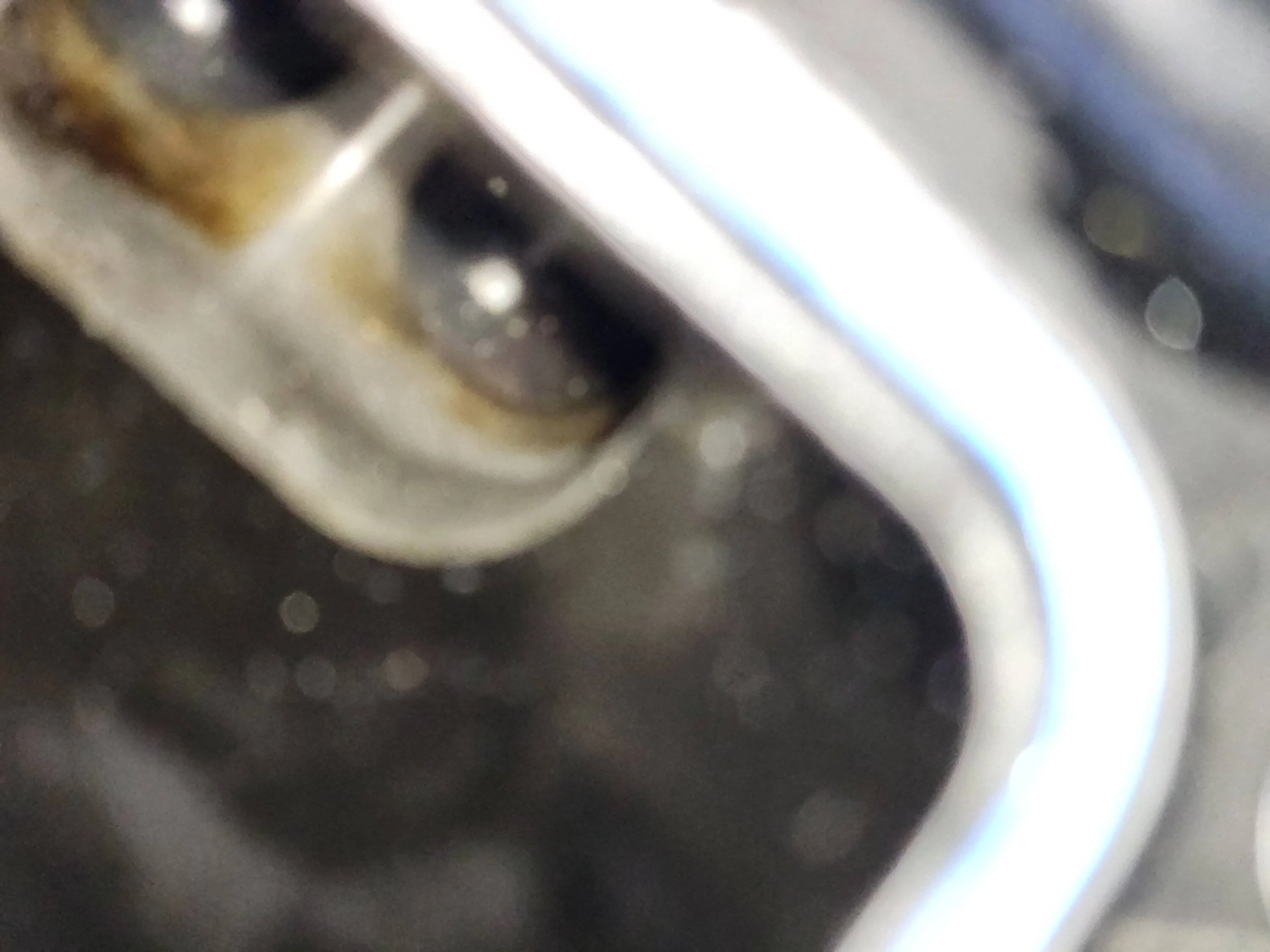

Exactly, show me the specs on a top tier . Bet dollars to doughnuts, it looks pretty much like Circle K gas. Besides, I "top Tier" the heck out of my gas every month with a bottle of lucas injector cleaner and mobil 1 techron. Yeah, both, I am a loose cannon.
I also fell for the walnut cleaning thing. It's really BS on the 3.6. Noted no difference except it took 1000 miles to get back to the mileage I was getting before the blasting.
The 3.6L is an MPI engine so yeah, walnut blasting is totally unnecessary.
Blurry as all get out, but here are the backsides of my intake valves at 70K...spotless:
