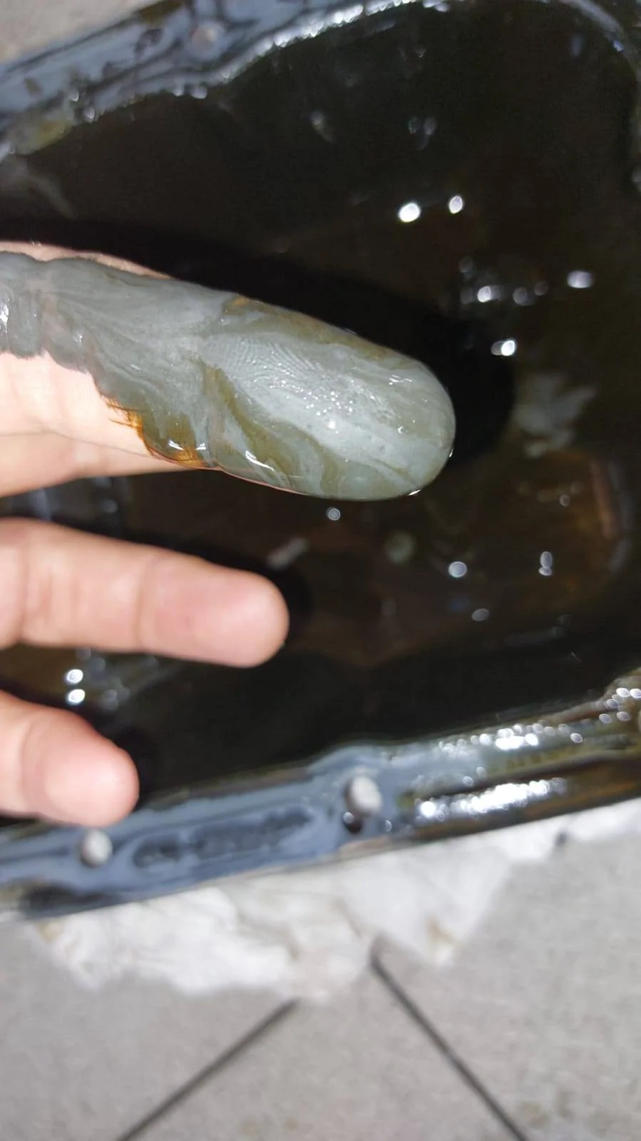

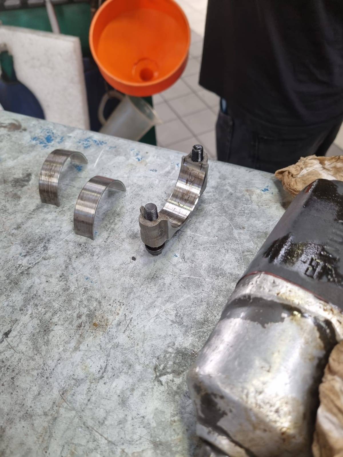

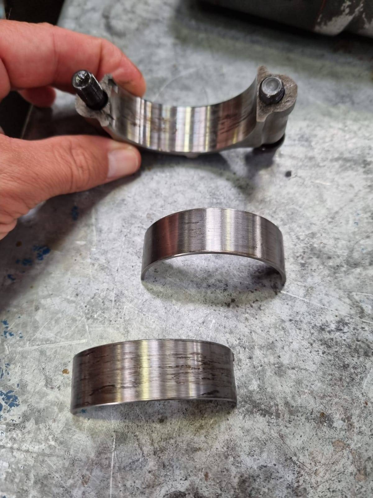

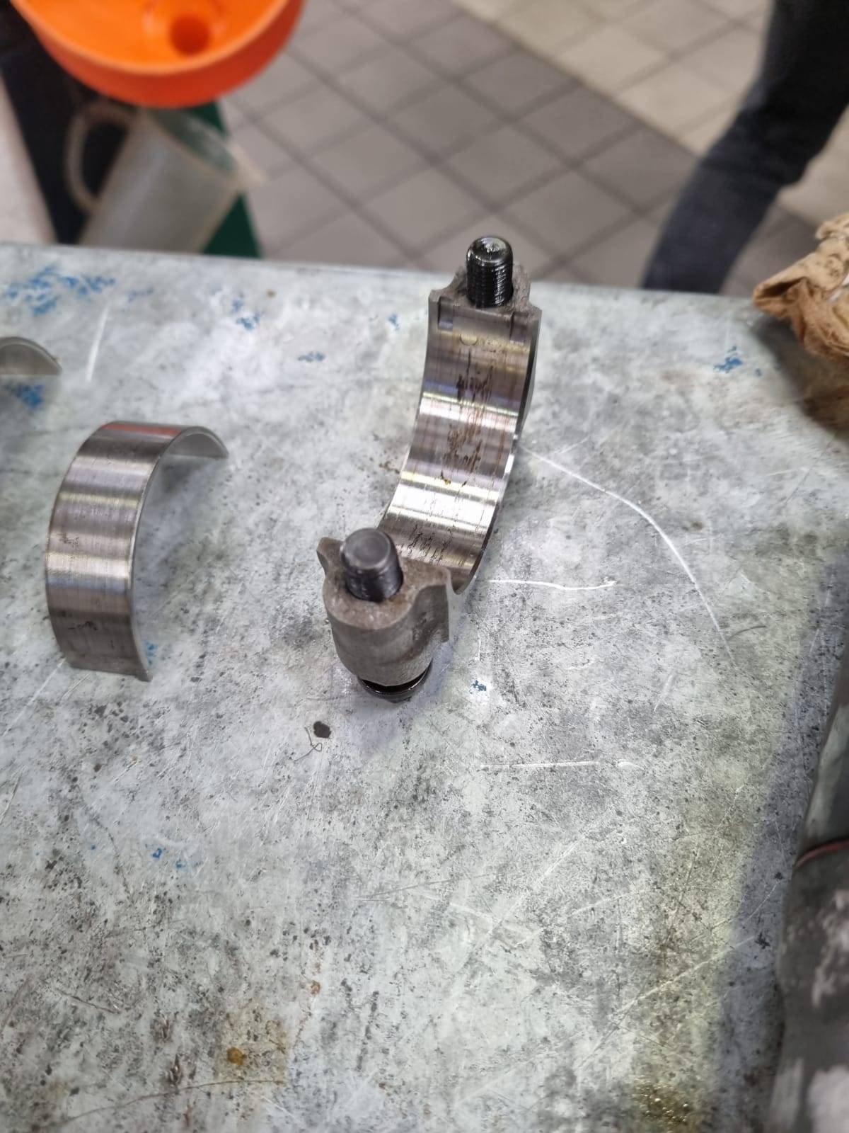

Hello
Please provide your professional opinion
JLU 2018 with 37500 miles
While driving on the highway the engine shuts off
And after many attempts, I was able to start the vehicle
I heard knocks at the bottom of the engine
I immediately took the vehicle to a JEEP service center
After disassembling the motor we saw that all the connecting rod bearings were clean
And what's weird here is a connection drop
Found worn
Engine oil was replaced every 7500 miles with original MOPAR oil
What do you think caused the problem?

Are you using the correct oil filter? Jeep likes it best when you use their brand oil filter (Mopar). That way they can not blame the failure on an aftermarket filter. The oil passages should be checked to make sure there are no restrictions or blockages (like in my heart).
Also, someone should check out the oil pump to make sure the clearances are within specifications and the pump is providing proper regulated pressure.

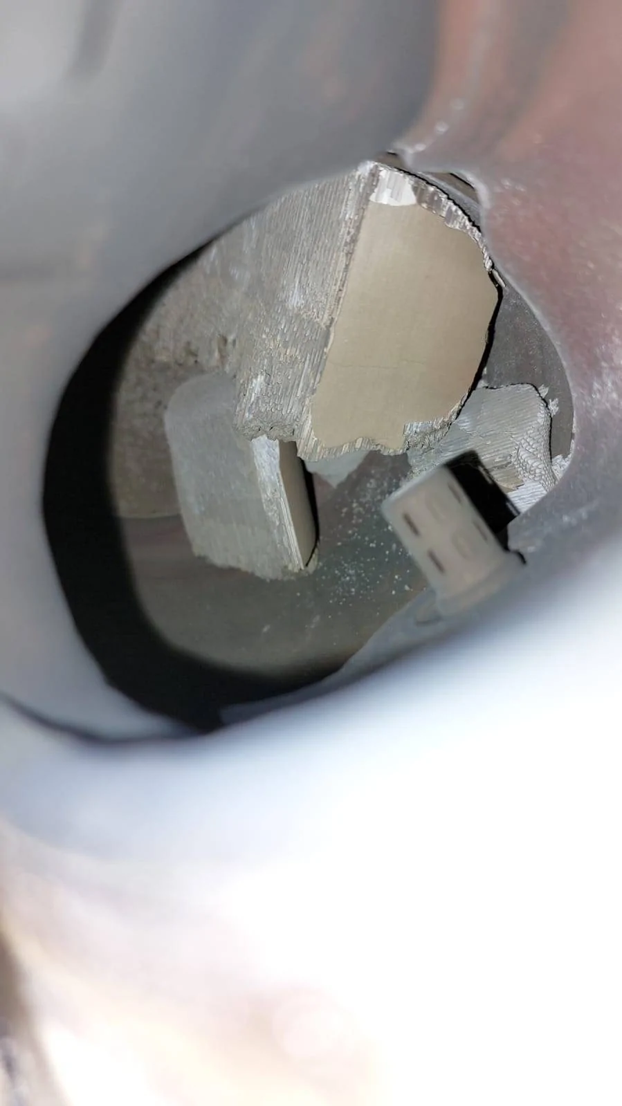

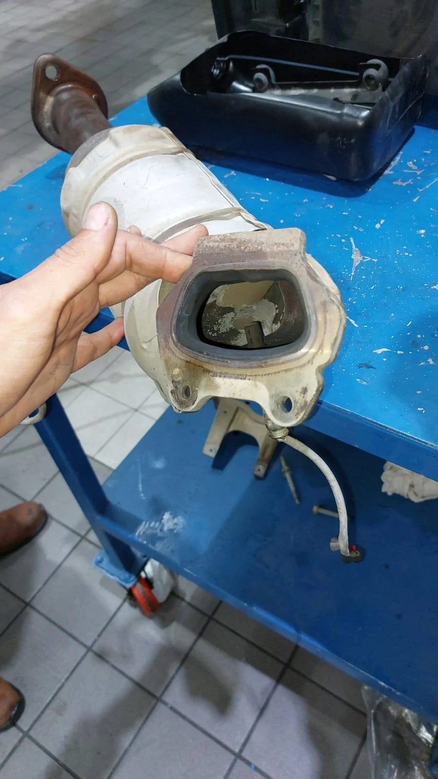

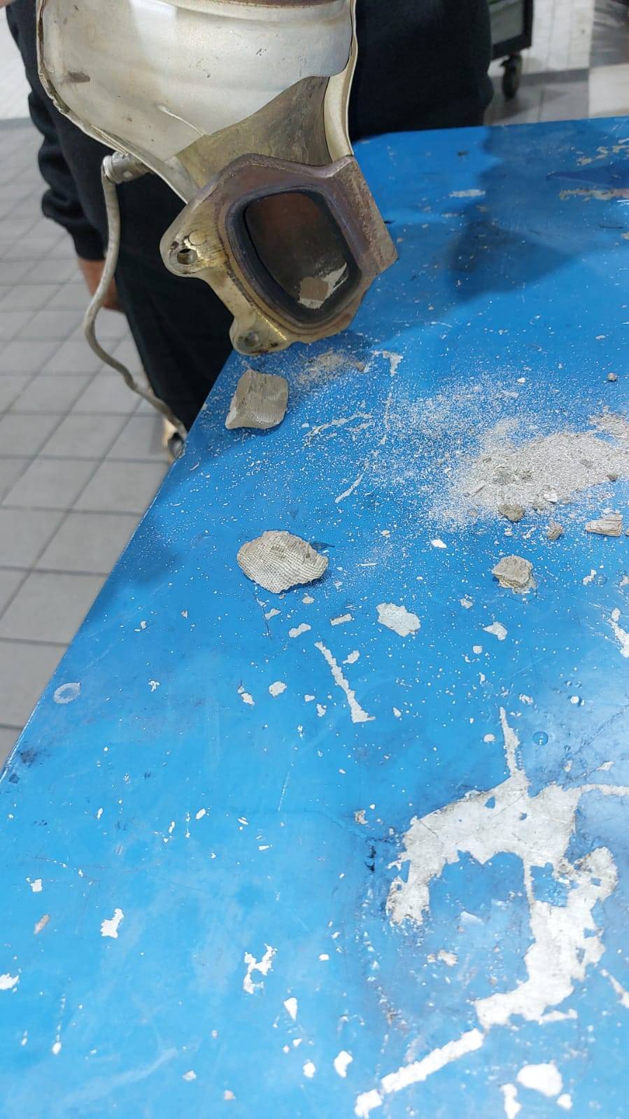

Hello everyone
I received pictures today from the service center.
According to them, this is what caused the engine to malfunction
Do you think that makes sense?

That will make it run like shit, for sure.

At first I thought something grenaded inside the engine, until I saw the sensor. I now hope they aren't blaming you for this.
LOL
The first rule is to blame the customer
Then I reminded them that the second NEW engine they replaced was faulty and destroyed the catalytic converters.

Your new engine malfunctioned or is it still your old engine?
Blown catalytic converter would not cause ware on crank bearings. It might be possible for engine to draw back some of the dust into cylinders and cause ware on the cylinder walls.
