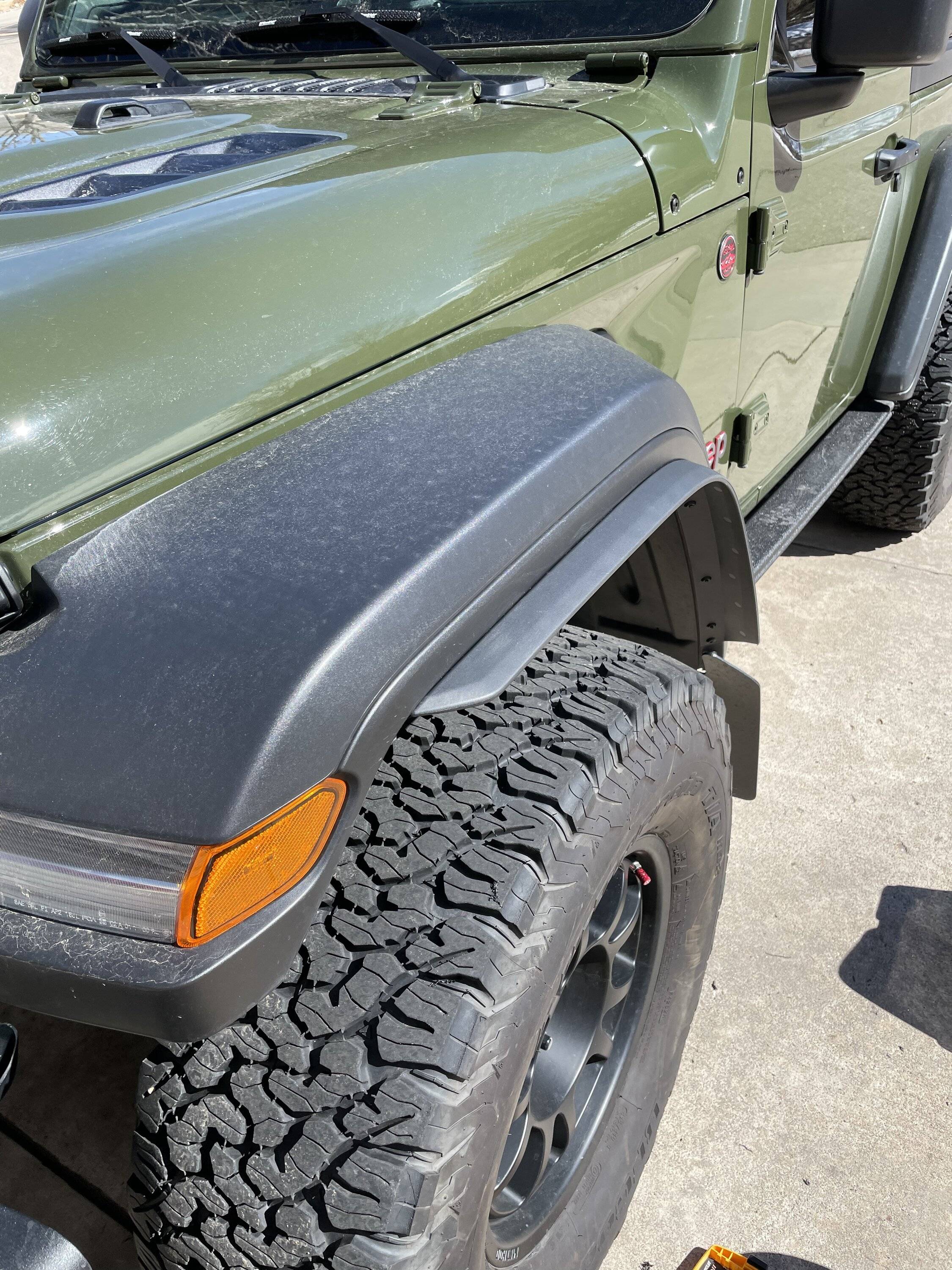

You said something about XR flares, is there a difference between Rubicon flares and XR

XR's have small extensions, primarily to make them legal with the 315/70/17's, but they do help a little with debris coming off the tires.
Some love them, some hate them.

Did either you or #gregeast use wheel spacers after installing the lift/fender flares? Trying to get someone in the know (JLR 2-Door) who has a winch that is doing a 2-inch lift + fender flares with 35’s and whether the tires are even or wider than the flares….? I know it’s a super specific question. My apologies if it’s not relevant here…
No spacers, but my wheels are 0 offset. These tools may help you visualize a bit better:

My wheels are 8.5" wide, 0 offset, 4.75" backspacing. No spacers here either.
With the KO2 315/70/17's the flares cover them.
