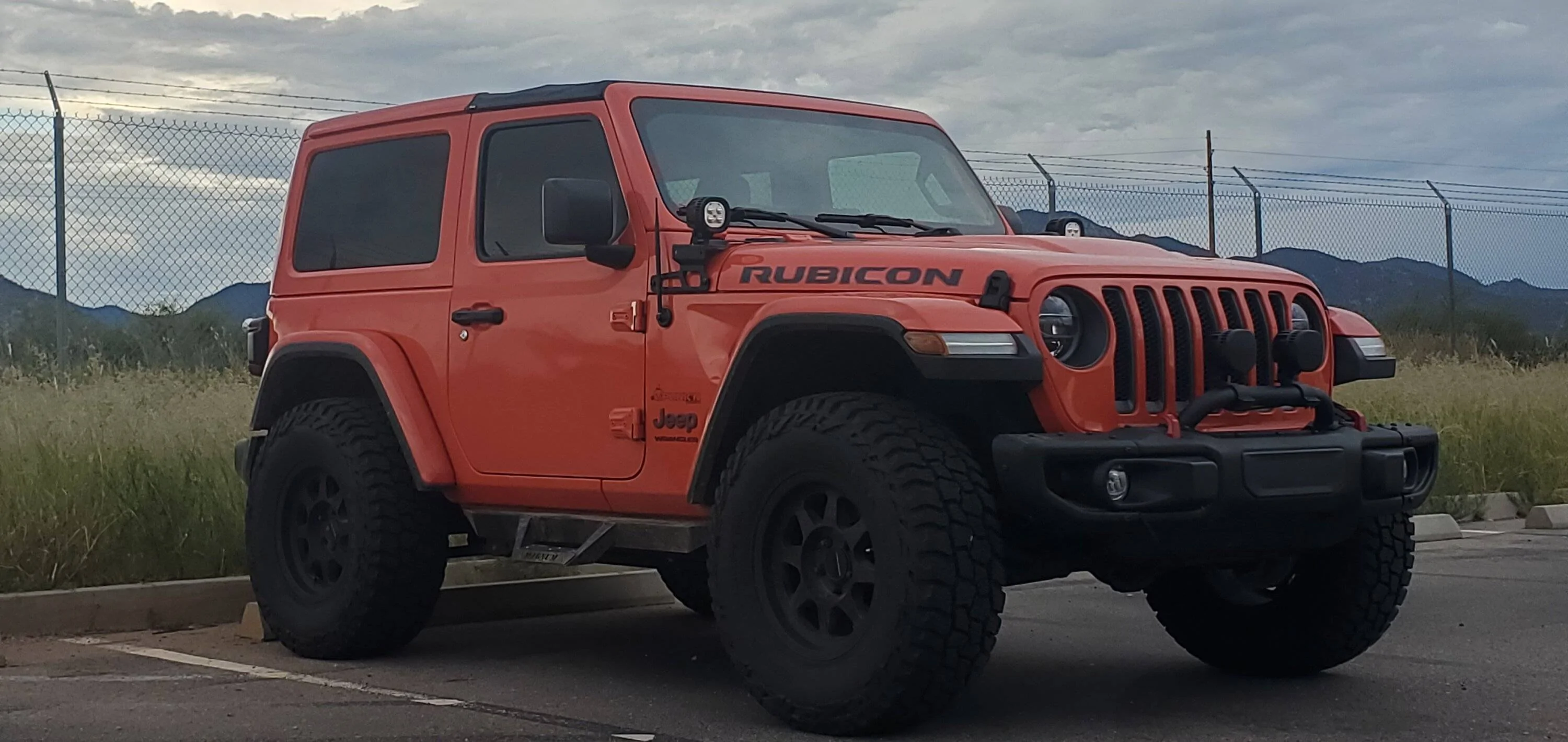

2020 with 3.6 auto. Stock suspension. Method wheels with 4.75" backspacing and MT 35x12.5x17 tires. Have a 23 JLURXR on the way and after seeing this thread, the JL may get the XR suspension. The amount of lift looks ideal with 35's.

Love that you used the stock wheels. Did you add wheel spacers, and if so, what size? Also, what about the spare and use of tire relocator?
I ended up putting 1.2" Borne OffRoad (Mishimoto) forged hub-centric spacers on it. HUGE different in driving and look. Minimal outward move for the wheels, but it looks 100% better. Also, I'm going to put the tailgate reinforcement on it. I just need to wait until it warms up this Spring before tackling some more add-ons.

I ended up installing the Mopar 2" lift. That, combined with 35's, fender flares, and 1.2" Borne Offroad (Mishimoto's Offroad Brand) forged wheel spacers put it right into what I want. It's not an exact XR with the lift and JLR OEM wheels, but it rides exceptionally well.
I did put a 3/4" front shock spacer on to keep it from drooping with the Warn Zeon 10S. It went down 3/4" on the original non-lifted stock setup initially (in about 8 months it drooped 3/4"). This time I did it ahead of time not knowing if it'd droop again. 35" spare on the back probably would have done the job too....might not have needed the front shock spacer.
Off road it's even better. The Fox shocks are certainly an upgrade in ride. BUT....lifting it, even just a bit means less stabilization. I also ended up putting on a Fox steering stabilizer. That helped a bit.
The stock JLR with 35's and no lift performed very well. Not much more wandering than the factory setup. But....you risk rubbing during offroad (tons on this in the threads).
