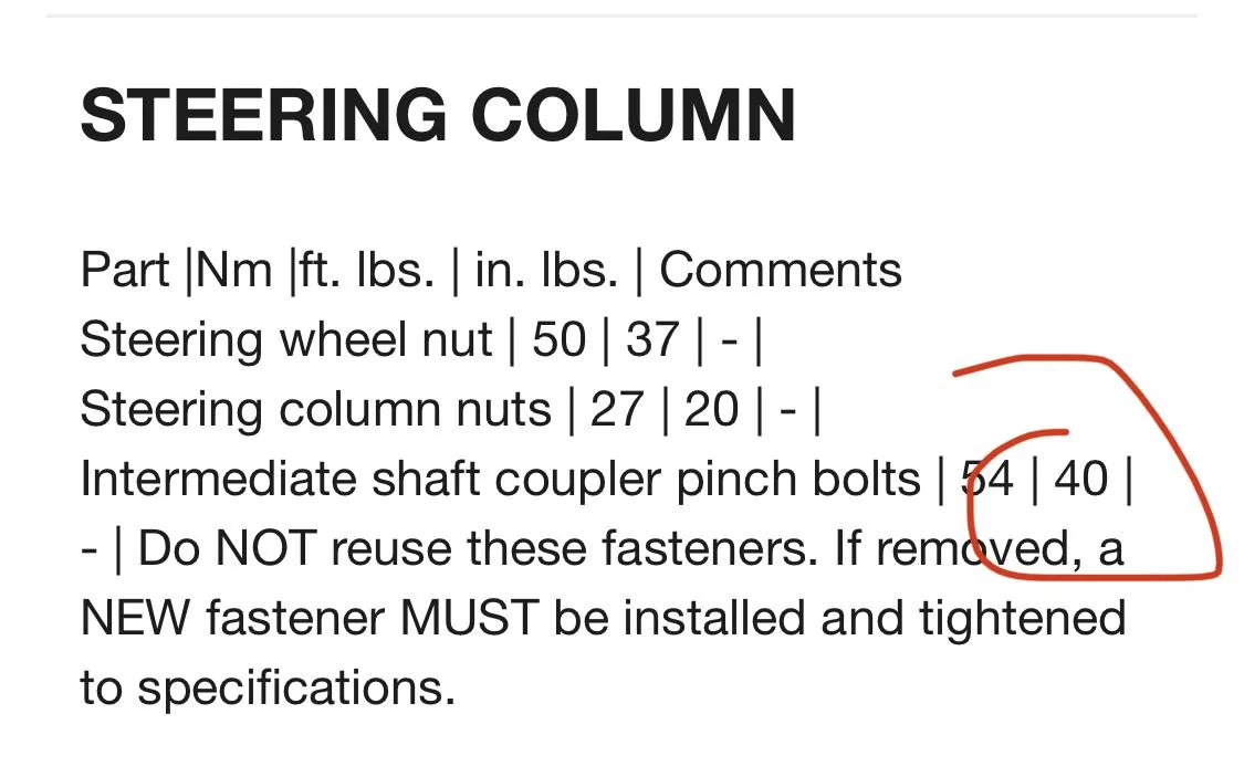

Found this bit in the depths of youtube, someone experiencing the same symptoms as me down to the dealer forgetting to fill the power steering fluid.
He had an independent mechanic look at it and apparently that clicking is caused by the Steering Shaft bolt where it connects to the steering gear box being completely loose.

See my post above #34. I mention IShaft pinch bolt. There has been numerous reports of dealer not torquing to specs.

UPDATE:
The steering is FIXED!
In total:
  • They performed the TSB and flashed the system.
  • They retorqued all the bolts to spec
  • Replaced the recirculating ball
  • Replaced the intermediate steering shaft
  • Replaced the aluminum bolts with the steel bolts (should have been done initially with TSB).
I have my suspicion that the shaft may have not needed to be replaced if the bolts were initially installed correctly as @hoag4147 has noted with the pinch bolt being a one time use bolt.
The car now drives like a Jeep, NO DEAD SPOT, NO CLICKS, IT'S NOT A JEEP THING TO HAVE A DEAD SPOT IN WHICH THE PITMAN ARM DOES NOT MOVE IN RESPONSE TO THE STEERING.
I think a big problem is that people who haven't faced this issue are confusing responsiveness with a dead spot. Jeeps are not the most responsive vehicle on the road, but they aren't broken shopping carts either.
Things to check after they do your work to make sure it's done correctly,
  1. Ensure they refill the power steering fluid. They left mine bone dry after the TSB.
  2. Make sure that they replace the steering box with the all black steel box.
  3. Ensure they replace the aluminum bolts with the new steel bolts after the TSB is performed. When you mix metals galvanic corrosion can occur over time.
  4. If you have a dead spot in the steering after the TSB is performed DO NOT ACCEPT IT AS A JEEP THING. IT IS A SAFETY ISSUE THAT CAN BE RESOLVED WITH PROPER DUE DILLIGANCE FROM YOUR MECHANIC.
