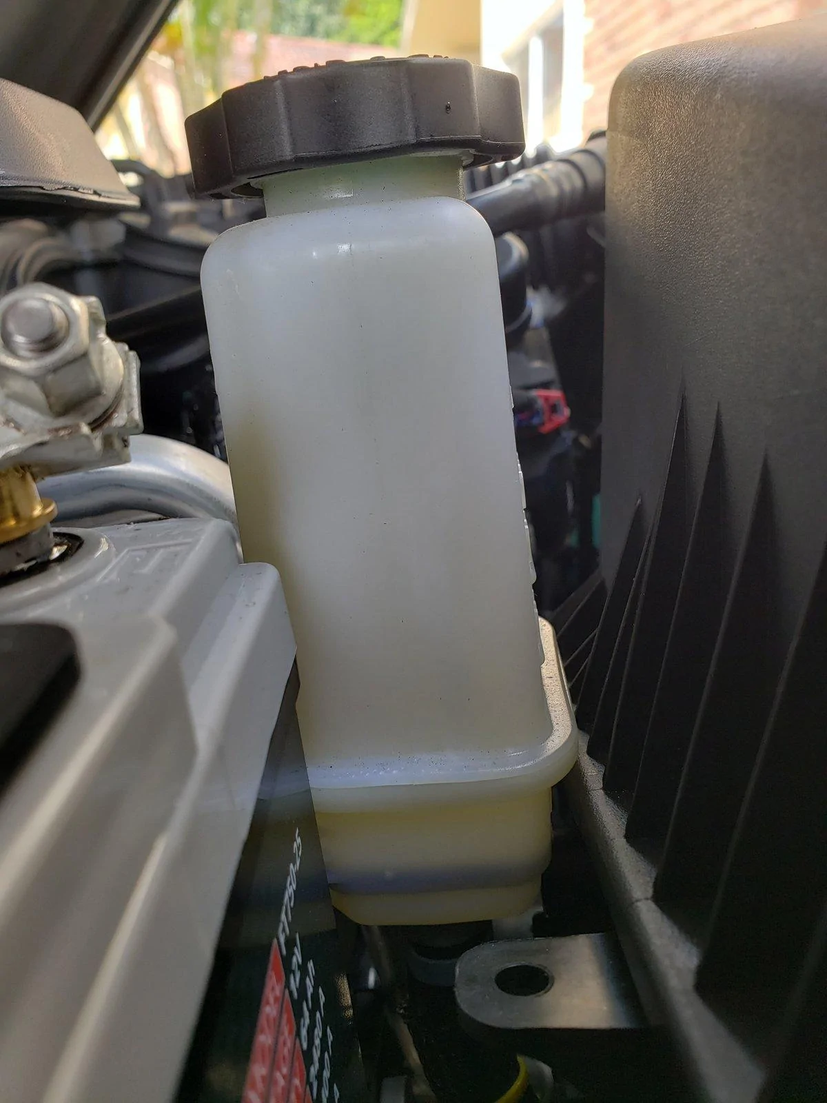

Spent a few minutes looking under the hood today to confirm the black steering box was installed, noticed that the power steering fluid was well below the minimum line. Could this be the culprit?

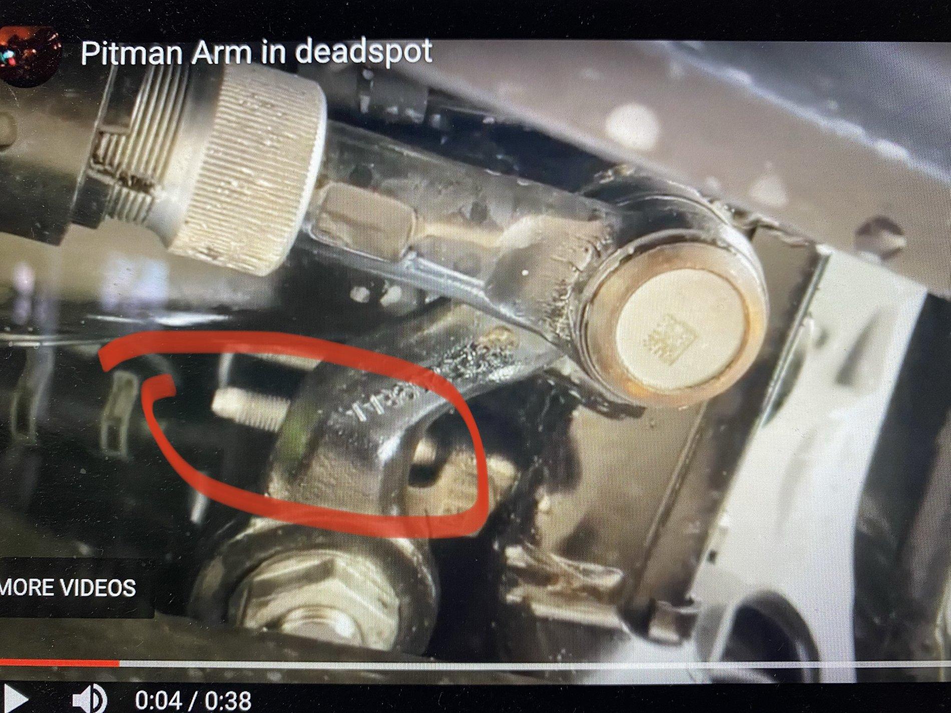

Did some more exploring.
The power steering system seems to engage even in the dead-spot as when the vehicle is steering there is a high pitch sound that is emitted from the engine bay when any steering happens. (Somewhat hard to hear on video without headphones.)
The pitman arm does not move when adjustments are made in the dead-spot.
I think the fix is going to require having that arm move with the adjustments in the steering wheel somehow. Not sure if suggested fixes like adjusting caster will fix that?

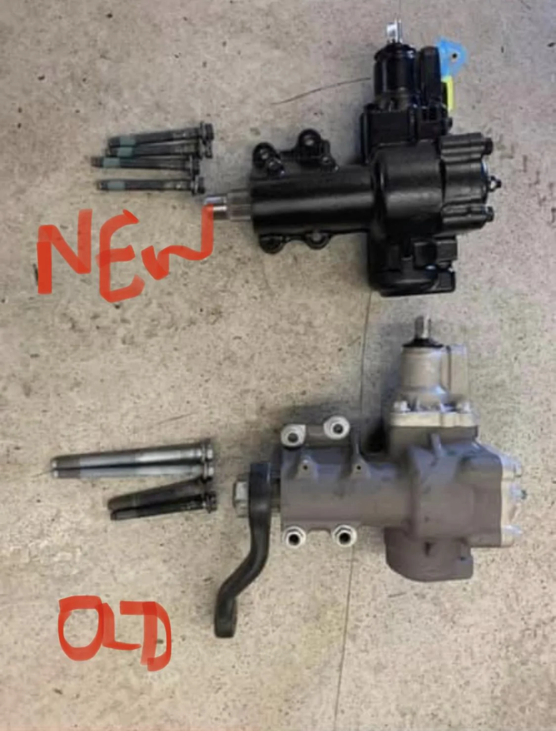

Can’t really hear noise. But would like to mention they reinstalled wrong bolts for steering gear.
