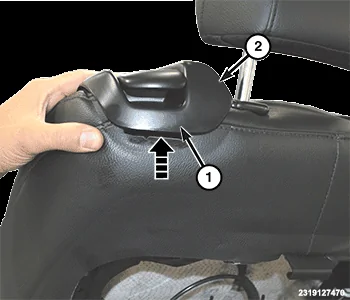

The top handle trim pops off by pushing up on the rear.
Jeep Wrangler JL JL 2 Door Easy Entry Handle Cable Replacement 1684427257435

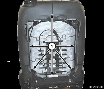

You will also need to remove the back seat cover, just a couple screws and straps at the bottom, then it comes down. Rotate slightly to remove.
Jeep Wrangler JL JL 2 Door Easy Entry Handle Cable Replacement 1684427340346
Once inside, you'll see the cable and it's just clipped on to the frame. You need to rotate the bottom end counter-clockwise (this was passenger side) to remove the cable from the arm. Remove the whole assembly from the top.
