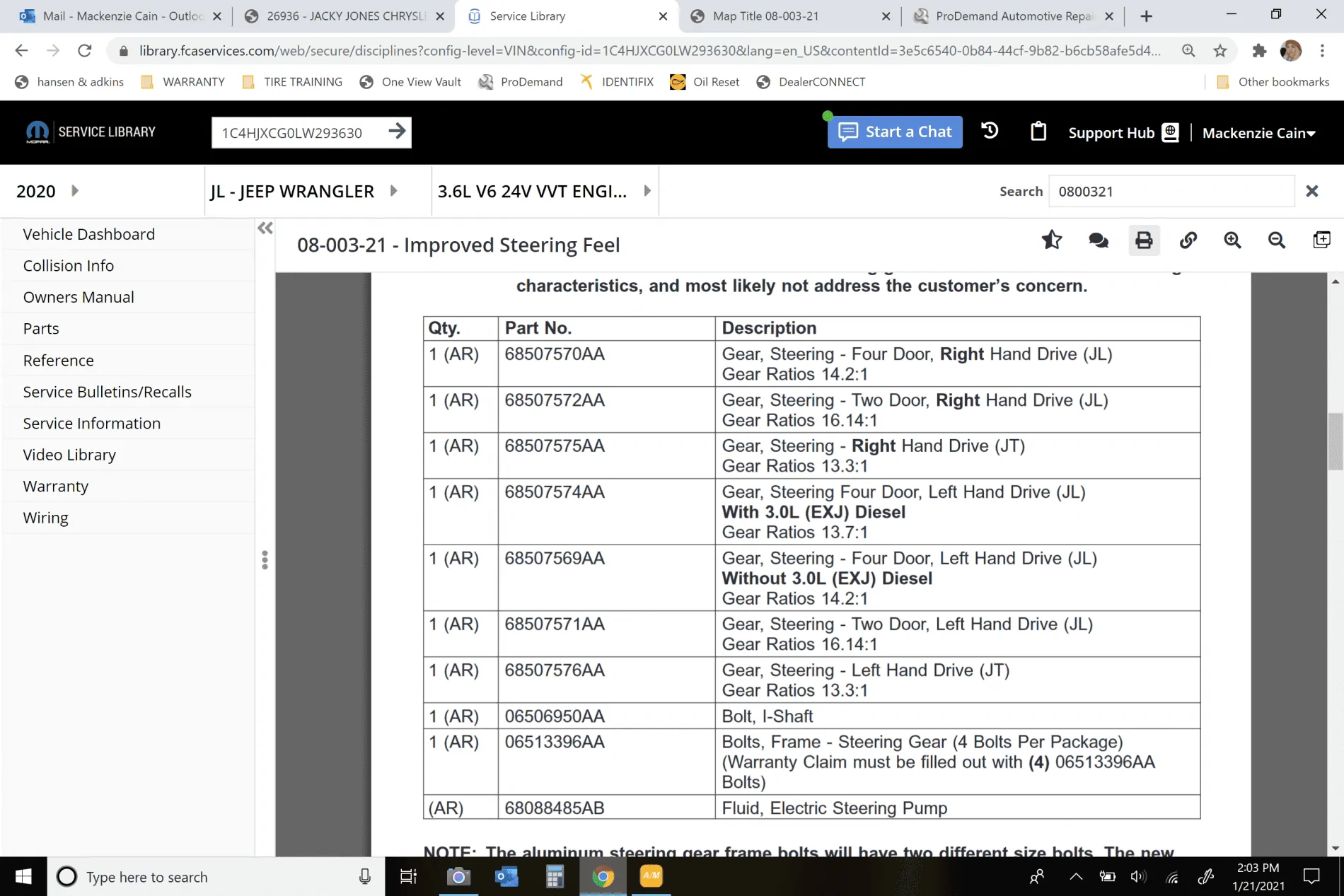

Wrong Steering Gear Installed for TSB 08-074-20

Picked mine up this morning after having TSB 08-003-21 performed. The steering box was replaced with a cast iron version and new bolts installed. They said they did the alignment and reprogram called for in the TSB, but I can only take their word for it as they did not note it on the ticket. They ticket includes parts for the steering box, bolts, and fluid. Seems to drive straight, but I haven't driven much. I noticed the wandering most on interstate and twisty country roads when it was hot. It is definitely no worse than it was before. I'll do some testing this weekend and see how it drives.
Sounds great I actually drove the highway and all was good they did all what TSB said so feeling good. I am sure yours will be the same good luck and enjoy the ride.
Good to see that your's was done correctly and this newest TSB is confirmed to include a cast iron steering box!
