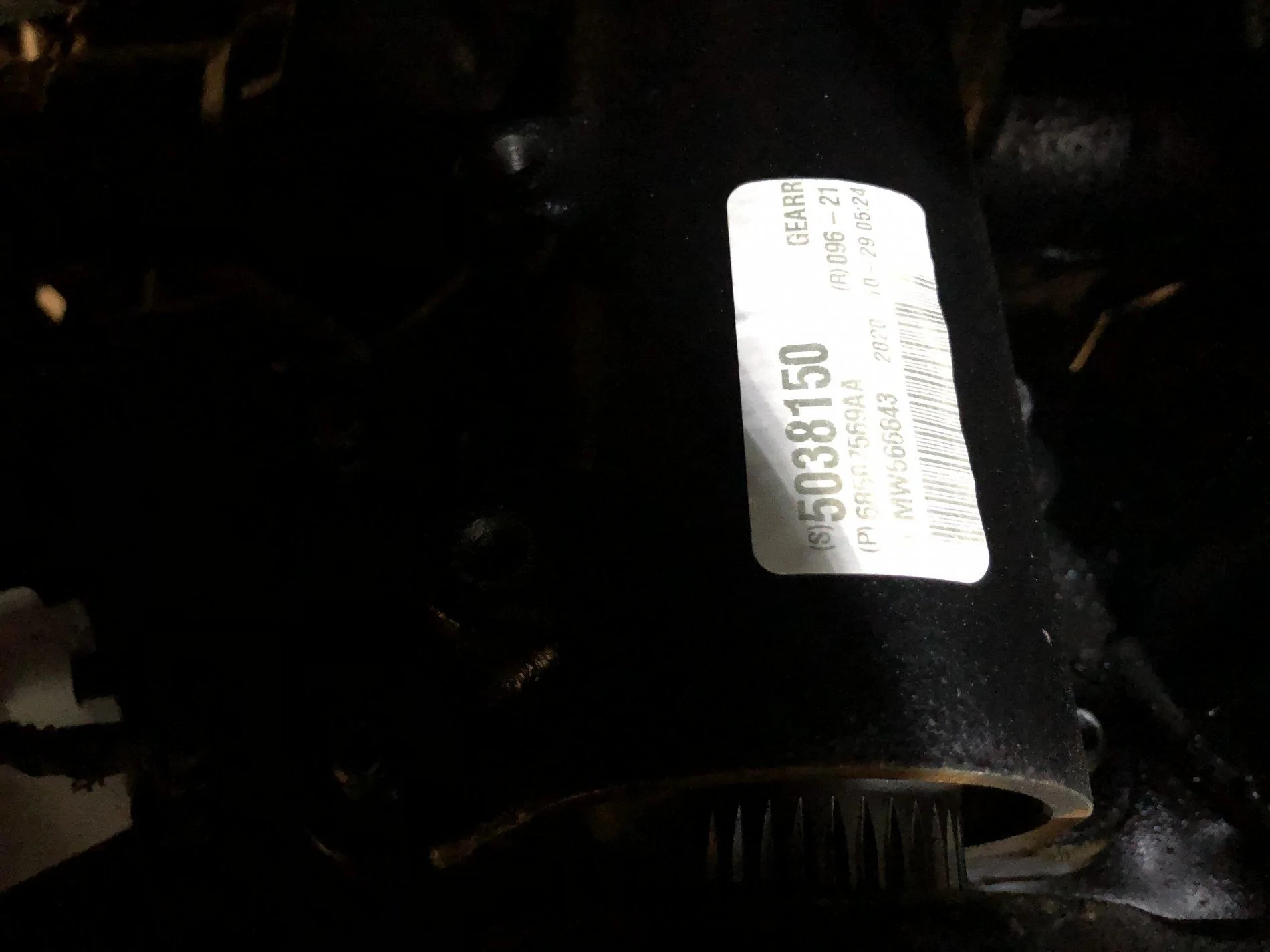

does anyone have the new TSB and a pic and part number for the new box.... I saw the post above shows one for a two door is it the same for a 4dr....I just want to make sure I have all the correct info prior to going so those idiots don't try to pass one over me....
....blah blah 7569AA as listed in the TSB. Pic off my 2021 JLU

So they installed the black steering box and did an alignment for you.
Yes, installed the black steering box using the correct bolts (verified correct part number per TSB and did the magnet test on it - cast iron). Per the TSB they also updated/reflashed the software, and performed an alignment. Jeep tracks straight as an arrow - level road I can have my hands off the steering wheel with no drift until it hits a bump/road imperfection.

Just called my dealership and spoke to a service adviser about them installing the wrong steering box. He tells me that the guy in service said that the aluminum box 68250506AD supersedes the newest cast iron box 68507569AA. Of course I disagreed and asked him to look it up himself and read the TSB directly word for word on repairs required for TSB 08-003-21. He's now irritated with my request and exclaimes he had looked it up himself. Big lie. I asked for a manager, was put on hold, waited and waited and waited for no manager. Currently waiting for a call back that's not going to happen. It's a terrible way to handle a service center and it's simply a disservice to have to get into a wrestling match over things clearly spelled that are supposed to be done.
