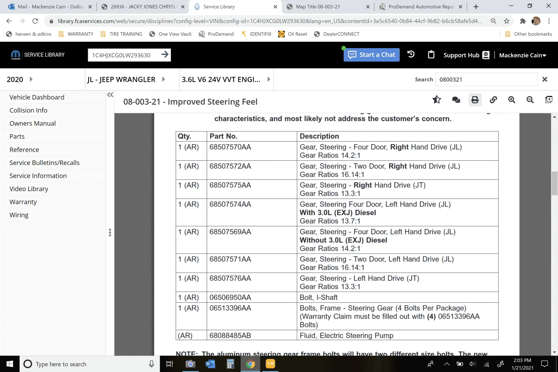

Either the OP was fed a line by the dealer or he misunderstood. Here is a screen shot of TSB 08-003-21 and the parts numbers, at least for the 2dr and 4dr LHD, haven't changed from the original TSB. They're still steel boxes.
Later,
Johnny
Jeep Wrangler JL Wrong Steering Gear Installed for TSB 08-074-20 SteeringBoxTSB 08-003-21
Later,
Johnny
I am glad you found this! After seeing this, I can't even imagine how they made this very obvious mistake. Ok, so I was trying to be generous towards the dealership and assumed this new TSB changed the parts used. My apologies to alarming anyone unnecessarily.

I just got a copy of the full TSB 08-003-21 from my dealer. Seems the difference is that it lists part numbers for Diesel applications and also right hand drive applications. It also specifies that if the vehicle was manufactured before 1/22/19 that the track bar should be replaced.
