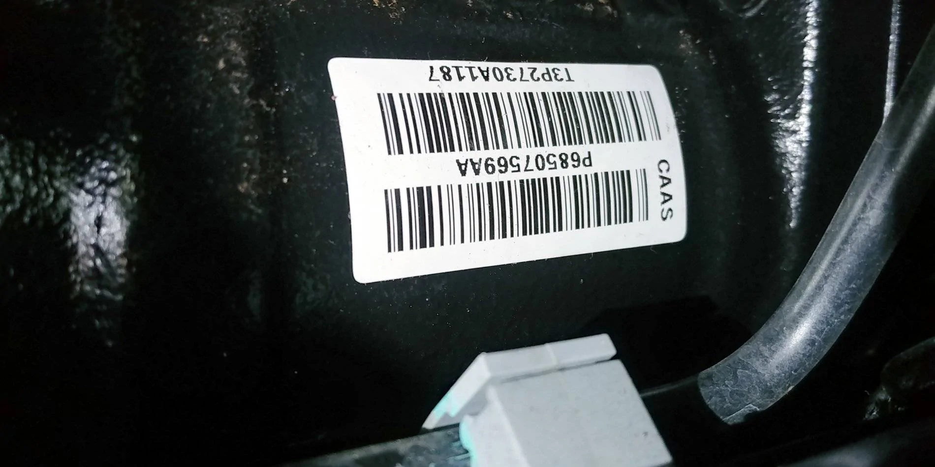

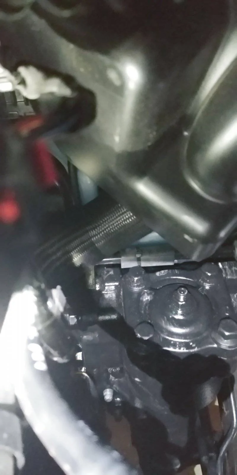

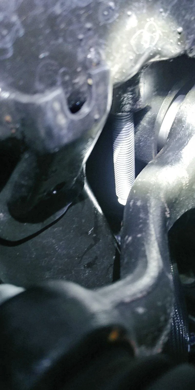

Finally got the cast iron steering gearbox installed. Verified its cast iron. They didn't use the correct shorter bolts. Bolts are all tight and no visible leaks...yet. No odd noises while turning and no odd binding. Seems better at 55 mph and more responsive. Still has a dead spot but less than before. I'll need to get it out on a major highway and see how it handles at higher speed limits. I demanded an alignment and I paid for it. Don't really care about the cost since I'm trying to put all the dealership carelessness and their misinformed stupidity BS behind me. If the box needs a little tweak to get it dialed in tighter it's no big deal since I can do it with my eyes closed. Don't care if they see that I adjusted it. Don't care what they think about anything, period. Looking for another dealership to use from now on. Don't even care if I need to drive twice as far to get there. I realize my tone is negative but it's the result of their terrible customer service and confirmed lies.
Jeep Wrangler JL Wrong Steering Gear Installed for TSB 08-074-20 0216211754c_HDR
Jeep Wrangler JL Wrong Steering Gear Installed for TSB 08-074-20 0216211755
Jeep Wrangler JL Wrong Steering Gear Installed for TSB 08-074-20 0216211756_HDR

Like was said it now has an alignment added but same cast iron box. Here is a picture of the correct cast iron box they finally installed on my Jeep. There is a label on it if you or anyone wants to compare.
