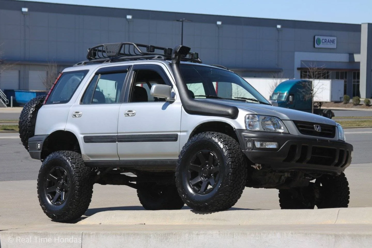

But how often are you digging into Hondas to add off road lights, bumpers, bumper lights, winches and auxiliary batteries?

That only reinforces my point about the comparatuve quality and consistency of parts design between vehicle brands.
So Jeep parts don't work on Hondas. Got it. You quite possibly saved me a small fortune with my future Jeep mods. Thanks!
