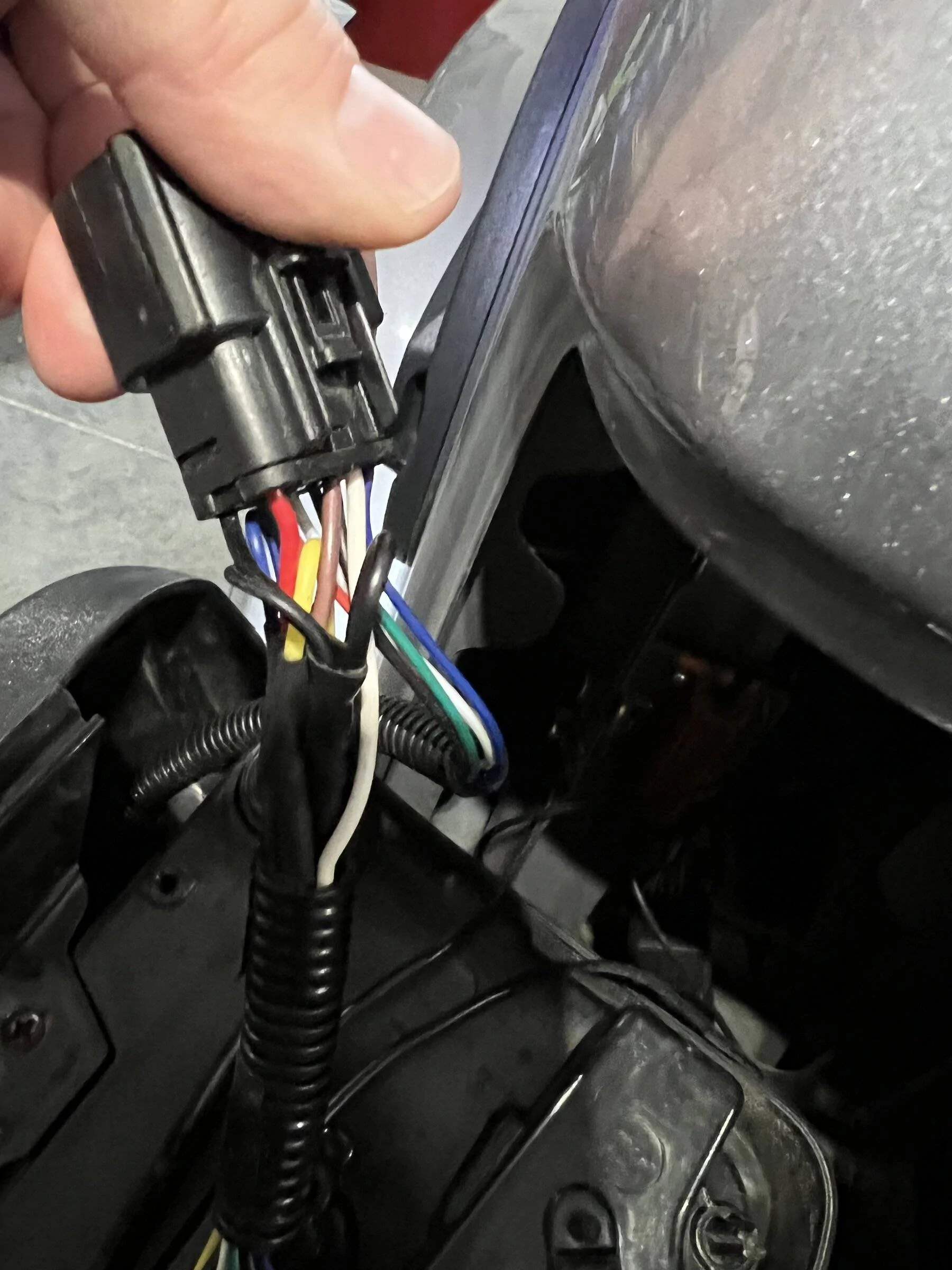

Has anyone tried to connect these to Quake LED qte 558 smoked taillights? Their wiring diagram does not match the wires that are actually used in the light fixture and they’re totally different from the Mopar wire colors.
Update: it's long.
I purchased @Oracle Lighting 5874-504 Rear Bumper LED Reverse Lights last year. I waited to install them, longer than I should have. Later Oracle released a plug-and-play wiring harness to ease the wiring connections further. I purchased this in advance of my eventual install. When it was first shipped, they were shipped with wire ends that did not match the instructions. It was determined that those were for the JT Gladiator. I returned the incorrectly wired ones in exchange for the correct ones.
When I went to install the lights, the wiring harness was found to be useless. It was meant for connecting to trailer wiring harness, but my JLU did not come with factory tow hitch or trailer wiring. There was no documentation to describe that the Oracle harness would only work with trailer wiring. $40 down the drain since I waited some time to attempt my install.
When attempting to install the lights, I could not get the included tTaps to connect, they were made poorly and did not allow for the spade end of the wires to be inserted into the plastic body. I purchased new tTaps from the hardware store and attempted the connection again. I finished the connection on one side (left) and found that the light illuminated but flickered intermittently before going dark completely. Without expert knowledge of lighting and circuitry, I turned to a professional installer, Truck Trends in Champaign. Truck Trends completed the wiring on the second light (right side) but when I went to pick up the Jeep, the same light-to-dark phenomenon occurred (now on both sides). I took the JLU back to Truck Trends the next week when their wiring expert was going to be in the shop. He spent the day troubleshooting the problem, including calling Oracle and QuakeLED to talk through the issue. He told me that Oracle revealed to him that this is a common problem and the only ways to solve it are to connect to the factory tow wiring or to install an aftermarket controller (Tazer). None of this was disclosed by Oracle as possible issues/complications with the install of these lights. The Oracle rep also told him that we could solve the problem by reinstalling the factory halogen taillights but replacing the reverse bulb in the taillights with an LED bulb; the wiring expert countered this by sharing my aftermarket QuakeLED taillights (QTE 558 taillights, purchased through Quadratec and have worked perfectly since first day they were installed) were all LED so that was definitely not a problem nor a potential solution. The Oracle rep agreed with this and moved away from this line of suggestion.

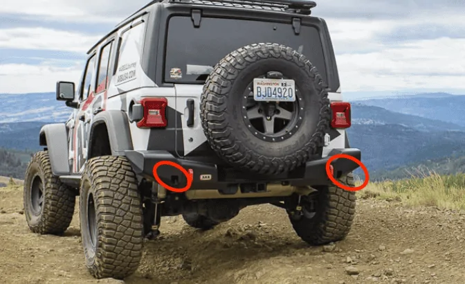

Love this idea. Could you make one to fit the jack cutout on the ARB Biondi too. I would line up to buy that one. I am replacing my tail lights, and need to relocate reverse. This would be the perfect location.

Just installed the LED bumper reverse lights today with the plug in play into the Oracle smoked LED taillights(had factory halogen). The bumper lights come on for 2-3 seconds, then go right back off. They’ll flash a few times then just go out completely. All connections are seated good.
Hey! Call us today and our technical team can walk you throughs some troubleshooting.

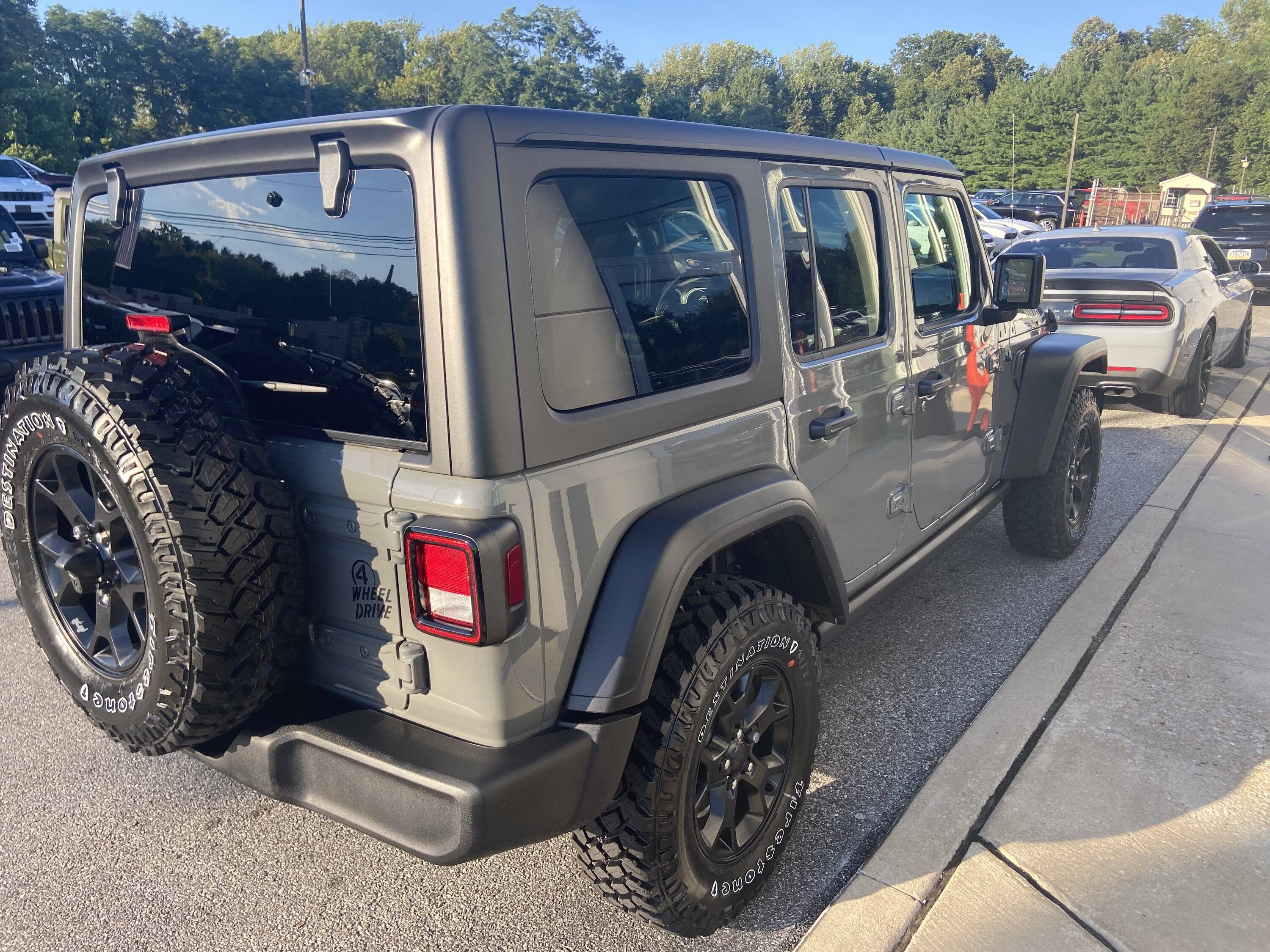

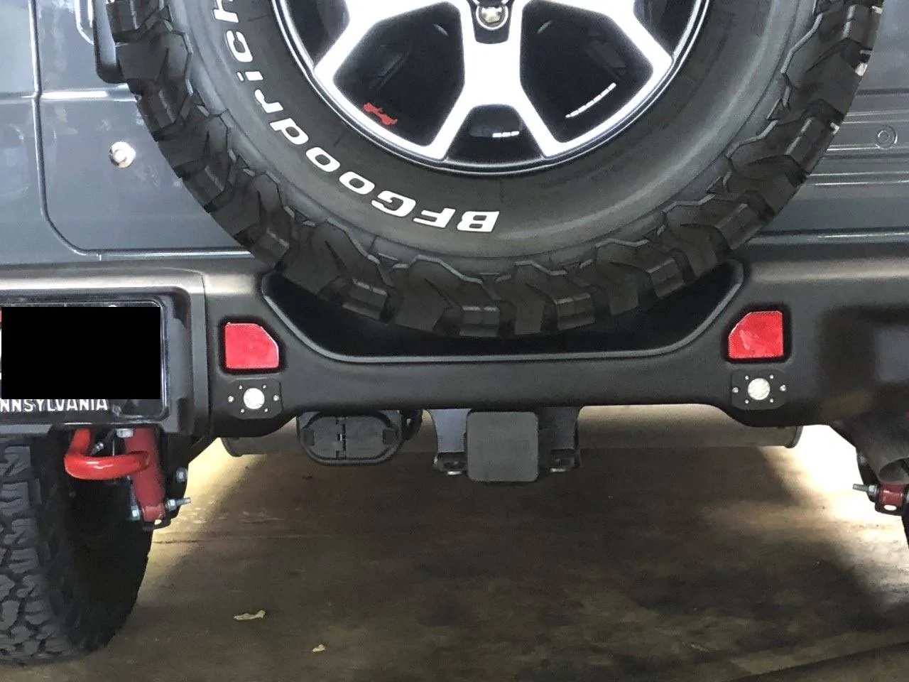

I just picked up my 2022 Willys and realized I don’t have the reflectors / recess to install these lights. Are there any other options?
Jeep Wrangler JL Rear Bumper Integrated LED Reverse Lights 9FFAC5EA-AA3F-4A0A-B3AD-EFEA40E62A3A
JeffK
May 5, 2018
70
193
Pa
06 Ram 2500 5.9 2019 JLU Rubicon
I went with the rigid ignite backup light kit, since Oracle didn't have anything back in 2019.

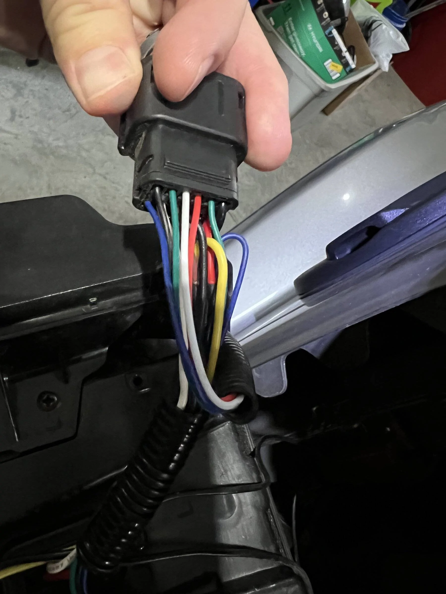

Alright so time was not on my side, but finally did the lights with a tow hitch plug harness.attached before and after pictures.
Like the idea of the tow hitch plug harness. Do you happen to have a link for this and/or description of how you did it?
