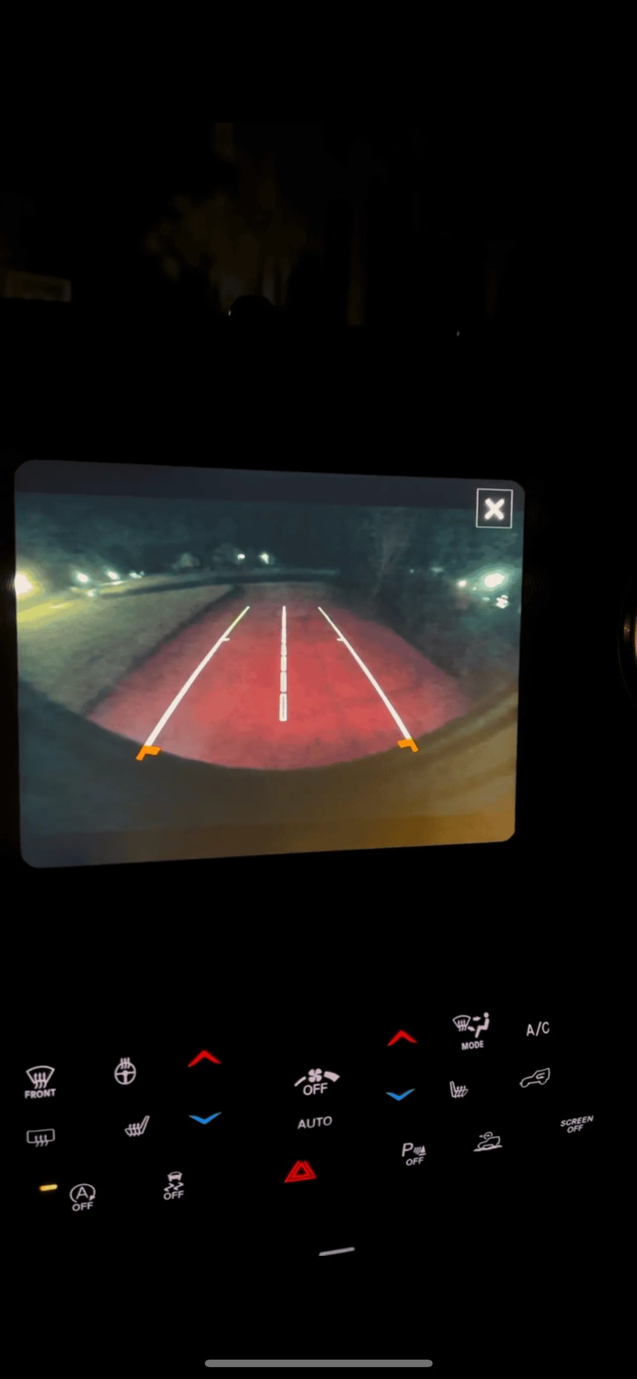

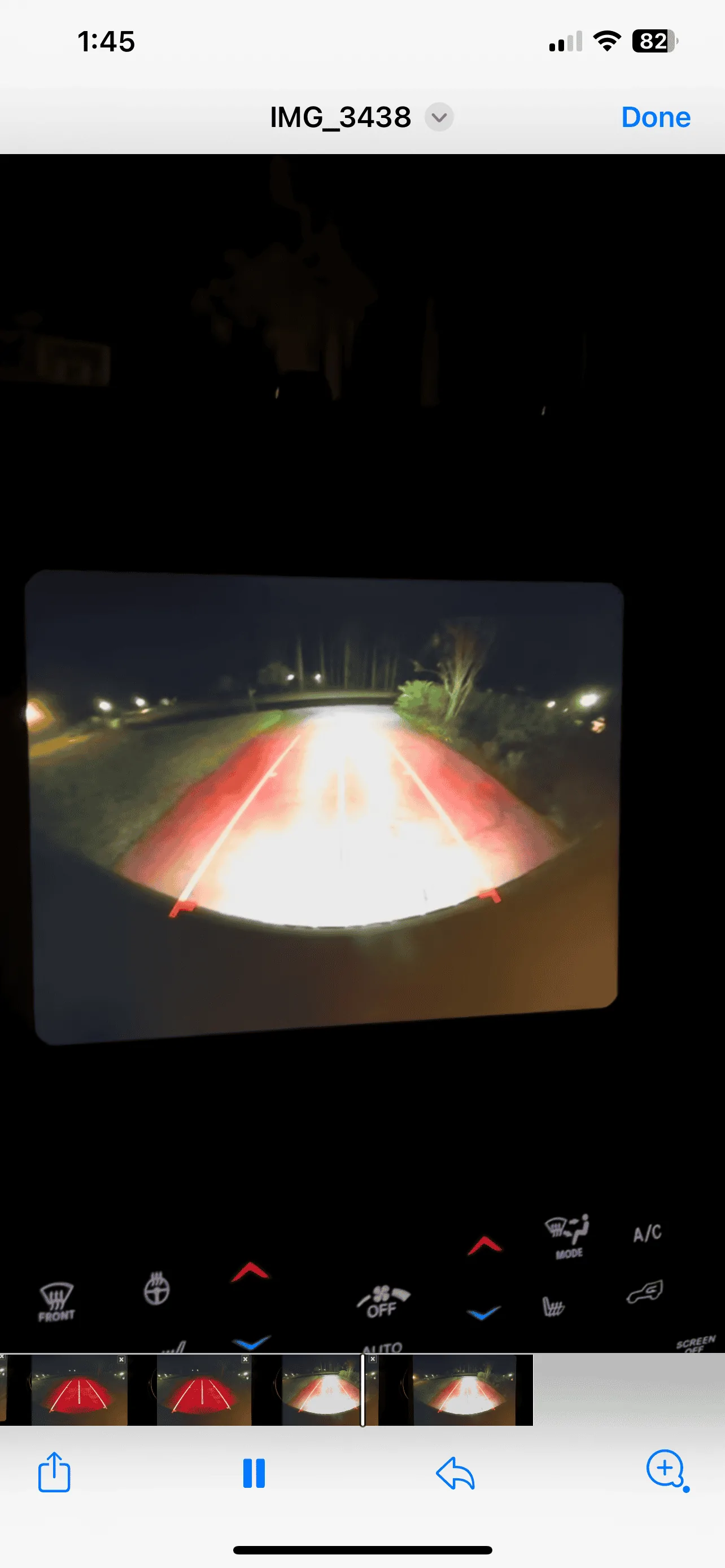

+1 for it being a PITA but worth the pain. It is such a clean install and makes the reverse lights super bright. Below are before and after pictures of how the backup camera visibIlity is impacted
Jeep Wrangler JL Oracle lighting rear bumper LED reverse lights do not fit 593043E8-C838-4561-8612-8FFE2CAAFABD
Jeep Wrangler JL Oracle lighting rear bumper LED reverse lights do not fit 25F6B314-9615-439D-ABB3-5E601333D9B2
