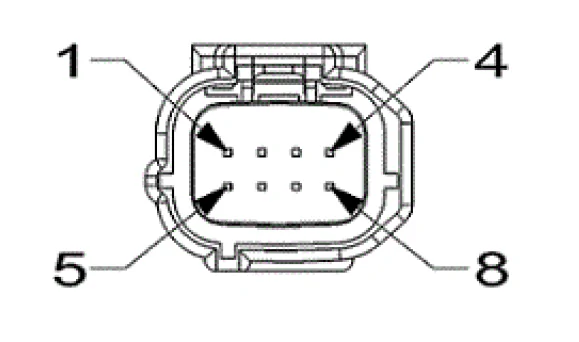

Your 4XE has the LED Group Tail Lamps, correct? If so, the wires are as follows:
LH -
Reverse: Pin 4 (Orange)
GND: Pin 7 (Purple)
RH -
GND: Pin 7 (Purple)
Jeep Wrangler JL ORACLE Lighting Rear Bumper LED Reverse Lights 1686157555541
Make sure if you're using T-Taps that the connector is biting all the way through the wire casing and making contact with the actual wire. This is common.
Also, make sure your flat spade connector is inserted into the slot on the tap and not pushed off to the side, missing the slot. Also common.
